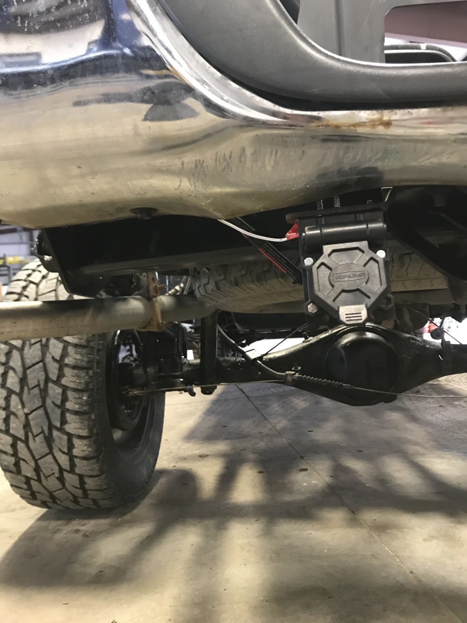

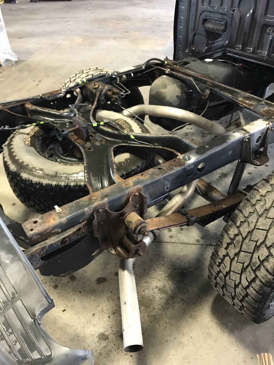

    SPC mid arm kit, bilstein 6112 leveled struts, in route to my house now are shorty headers, true dual flow master super 10s, and a cold air intake.
    Tore the bed off yesterday cleaned rust painted, and re installed trailer connections whoever did before jacked it up.

    @Levy nice work. That frame looks new again. Did you use POR15? Did you grease rub or do anything to protect it after you painted it?
    there are probably better ways but used a needle scaler to get the bulk off prepped with a flapper disk, pressure washed applied the rust remover spray waited 30 minutes repressure washed and then used a 4 in one spray paint from my local paint store
