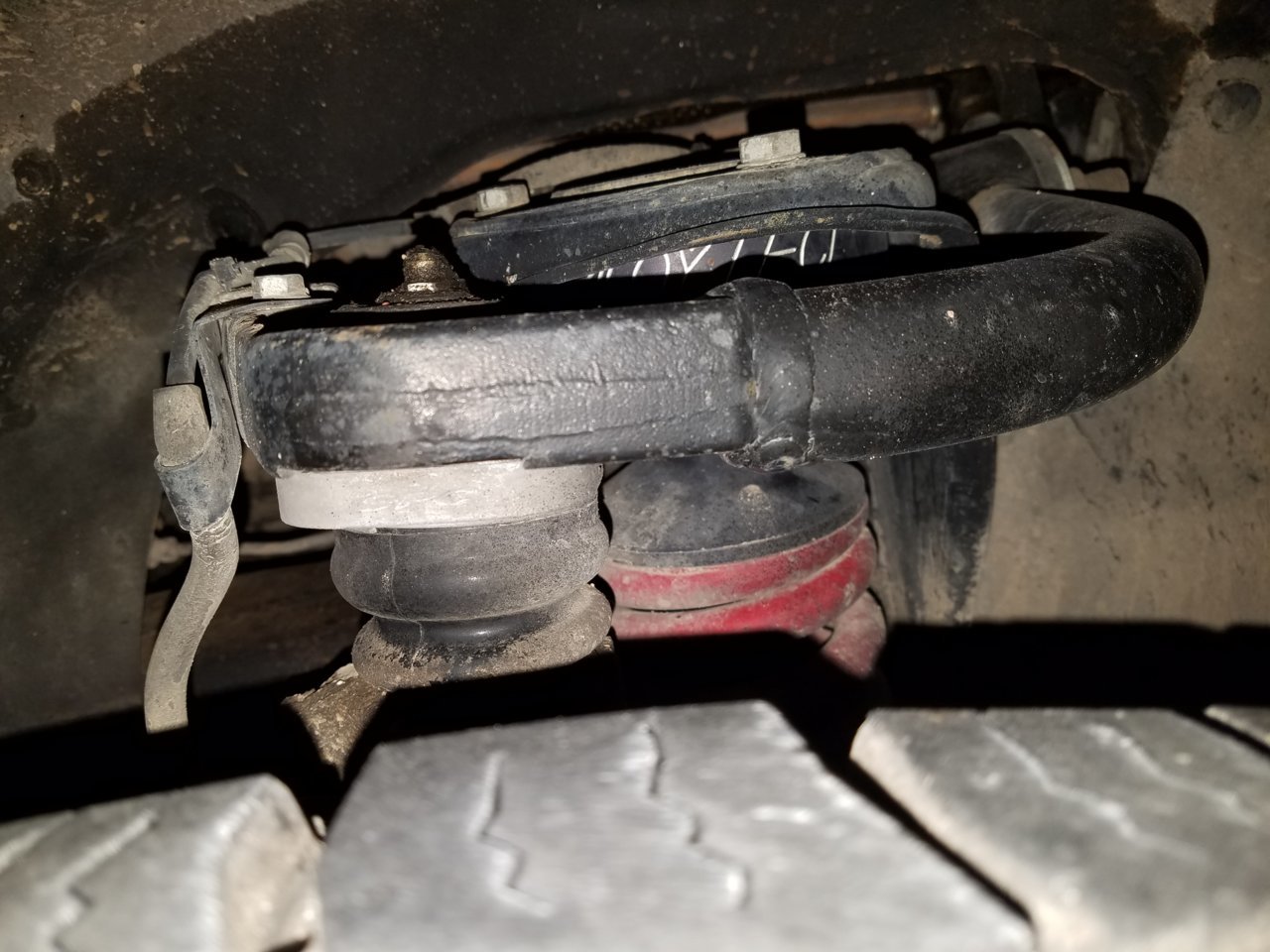

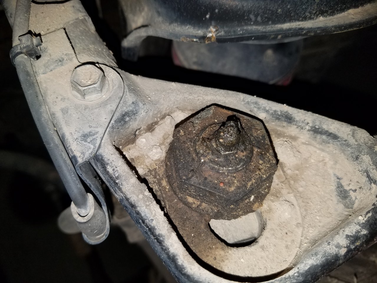

    You can see the slot on the bottom of the arm for the castor plate. It should say left or right in that area too. Unless you're talking about the uniball, but I believe the shafts are two different sizes completely.

    I watched this one to figure out adjust the camber. The top nut needs to be closer to the engine bay on both sides. The knuckles need to be lifted to do it easier. That video is very close to ours. I only took the bottom rear guard clips out to remove the control arm bolt. The brake line mount on the driver's side firewall might get in the way of removing that bolt, but it's easy. That was the easiest thing I did over the weekend.

    Snap a pic from above the uniball.

    Passenger
    Driver
    My shits all fucked up. They don't even match lol

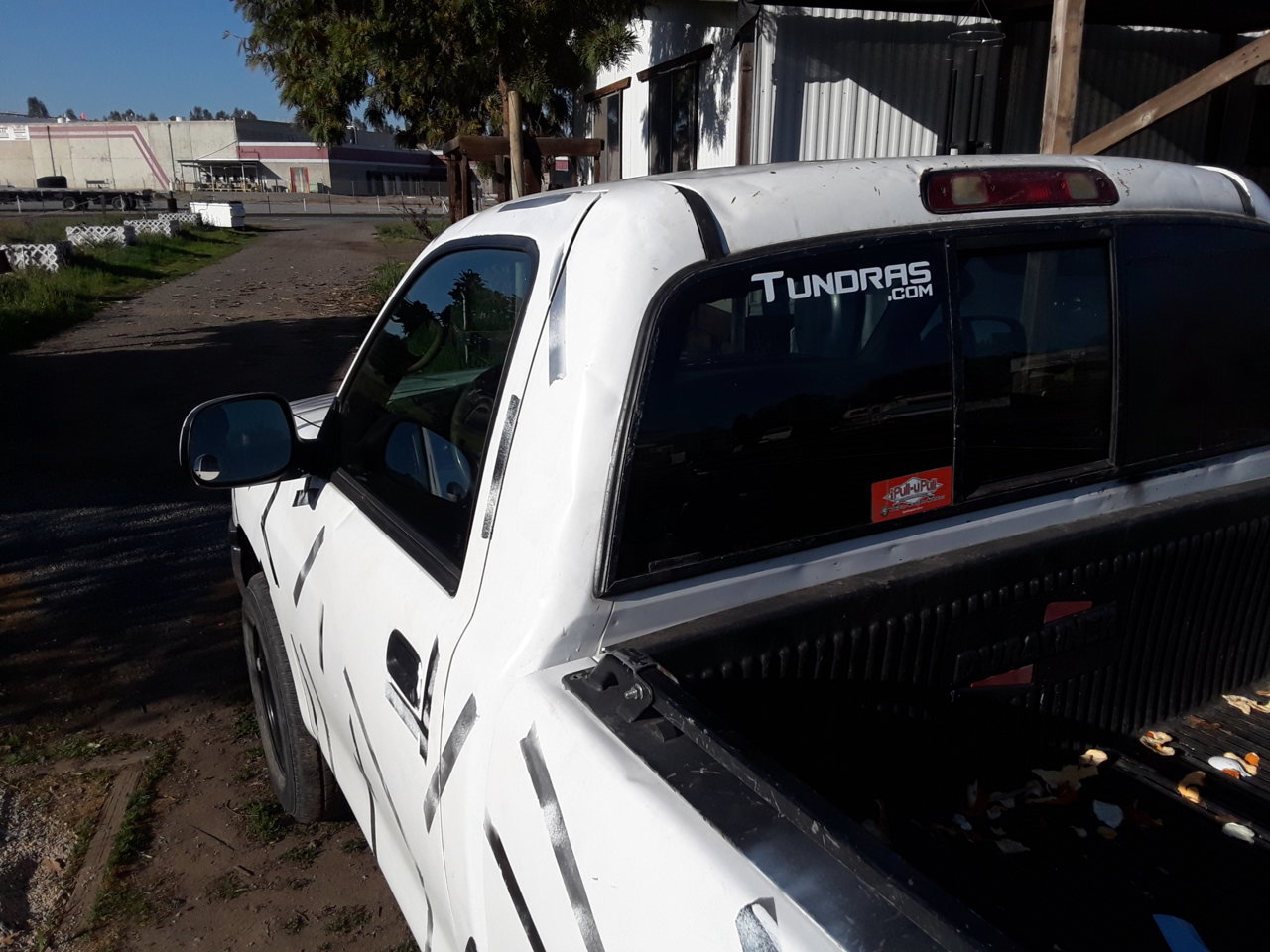

    Today I installed the best modified item yet. And its free.20200303_155534.jpg
    The tundras sticker.

    They look gnarly too. Are the boots cracked?

    Just dirty from this weekend I think

    Yours are right.

    Ok good. Now I just need to adjust em properly

    How are they off? I had the nuts all the way to the outside of the control arm and it looked like a "V" from the front. Looking at the postion of the top nut, the passenger looks good camber wise, maybe a little negative. The driver looks pretty positive. It shouldn't take 30 min for an alignment shop to do that with the SPC control arms.

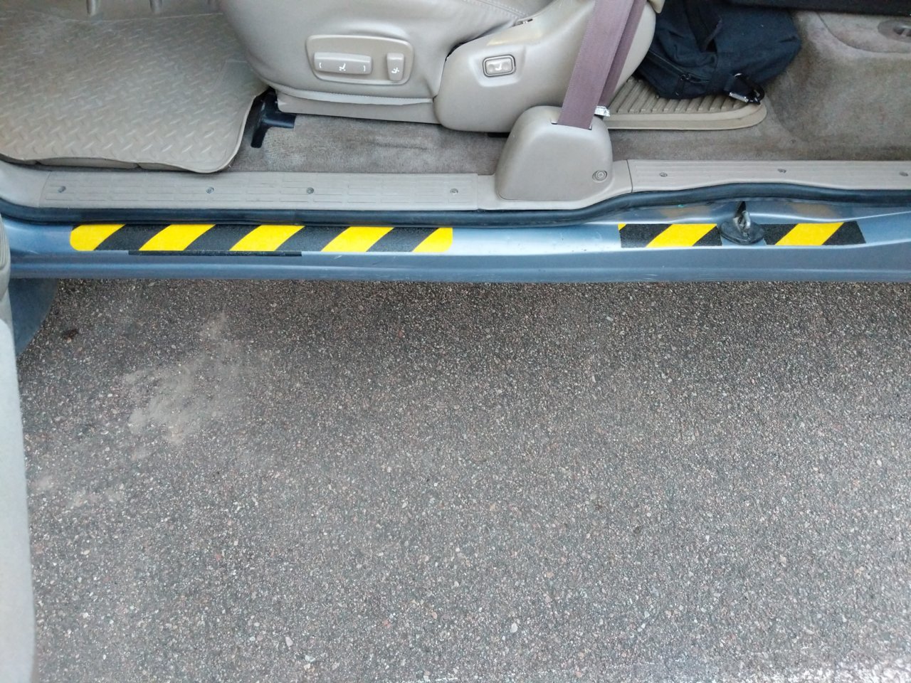

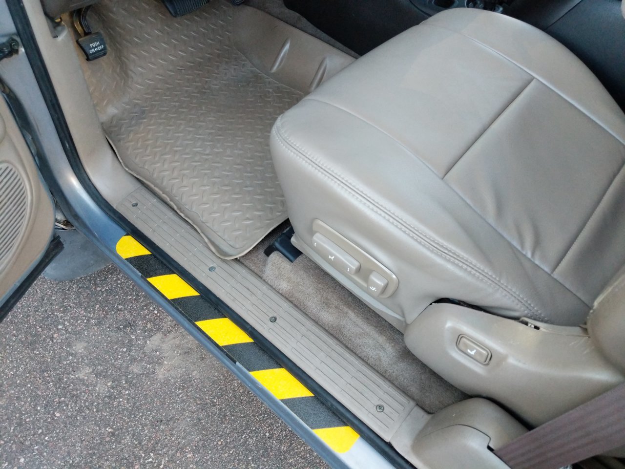

  21. Mar 3, 2020 at 7:23 PM
    theblurry1
    theblurry1 ~
    Jan 9, 2020
    #40957
    288
    David
    Castle Rock, CO
    2001 Thunder Grey Tundra AC Limited 4x4 V8
    (Camper conversion underway.) Rebuilt engine w/265K miles, A.R.E. camper shell (w/cab pass-through, rooftop fan, and side windows delete), bedlinered steel ladder rack (w/wooden rooftop deck and hammock mount), all LED lights (red dash, 4" side floods, 32" rear bar), Android head unit, 1.5" lift from Bilstein 5100 struts, 32" DuraTrac tires on factory rims, 1.5" wheel spacers, Moog suspension parts, SuperSprings leaf kit, diff drop, Reese trailer brake control, GoRhino Hitch Step, debadged, F-150 rear bumper, Sequoia center console unit upgrade, partial rear bench seat delete, dashcam, aftermarket speakers, 50% sound deadening coverage, custom tools unit.
    Got some door sill protection going from Home Depot for $10.
    I was able to do both sides from one sheet. May not be for everyone or as OEM as the protectors that say "Tundra," but it fits my "roadside assistance truck filled with tools" aesthetic, protects the paint, and gives some good grip.

    Yeah I think the driver side is off. Last time I got an alignment about 3 or 4 months ago they said "we got it as close as we could, just keep em rotated. The driver side is a little off."
    That made me upset because there's no reason for the alignment to be less than perfect when you have adjustable UCAs. So next time I'll bring the SPC instructions
