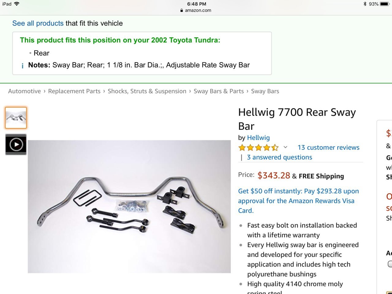

    This is the one that fits the 02’. The local 4 wheel place can buy it AND install it for $375 total. No brainer to let them do it.

    The LSD rear bar combo will make the inside tire grab and spin a little at low speeds. The sharper the turn, the more noticeable it is - nature of the beast. My rear leaf packs were replaced under warranty about 100K or so ago, my normal load under the heavy Leer hi-top is about 700 lbs. I towed & hauled heavy loads early on, it squatted enough to warrant the purchase of bags for the rear but the job changed before I installed them. The leaves haven't splayed out yet...

    Most of my towing is short distance and sporatic so I prefer to keep the stock springs for normal driving. The airbags sound like a good idea for hauling payload, but again its less often than towing that I’m running heaver than 400lbs.
    This week, I’ve run a few 1300-1500lb payloads and the bump stop was sitting about an inch off the axle stop. Only bottomed once on a dip.
    Thanks for the feedback on the Hellwig rear. Might do this in the next couple months and call it quits on spending any more money for a few years unless something major comes up.
