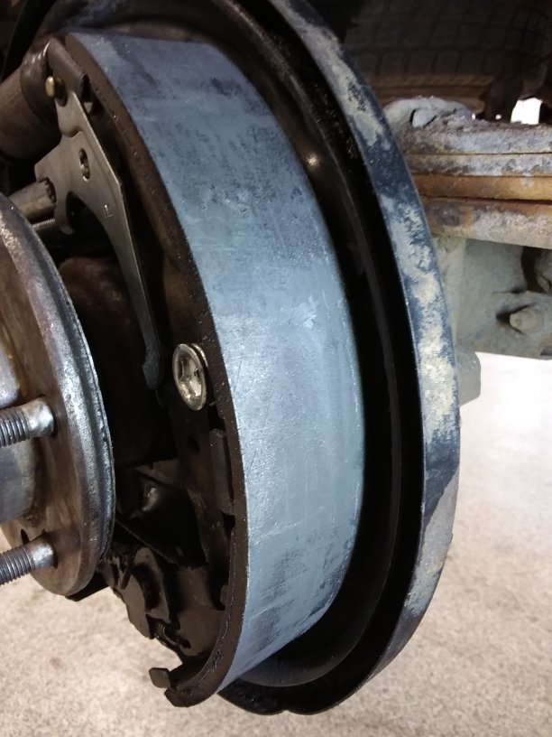

    Well - it's been a couple days since the last update.
    Got the drums off and machined... BUT, guess what?
    Darn thing has fluid on it AGAIN. After changing the seal ... After reading A LOT on this site, I knew that some folks have had the ABS ring pressed-on too far, so here's things pulled out:
    Sure enough, that ABS ring/retainer are pressed on all the way. Not only that, but there's some horrible heat discoloration all over the tone ring ... IE: one of the prior owners heated that mother up with a torch so they could get it on. And put it on too far.
    Had a shop do the work (no press at my home) ... and explained the spec and that there'd be a gap ... Here's how it sits with a new ABS ring pressed to the proper spec. It's a HUGE gap.
    But, guess what? After having it done properly, it's all good and dry now. The shop was pretty surprised as almost everything they work on gets pressed to some obvious 'stopping point'. Oh, and with the machining of the drums done, my brake shudder is GONE. :thumbsup:

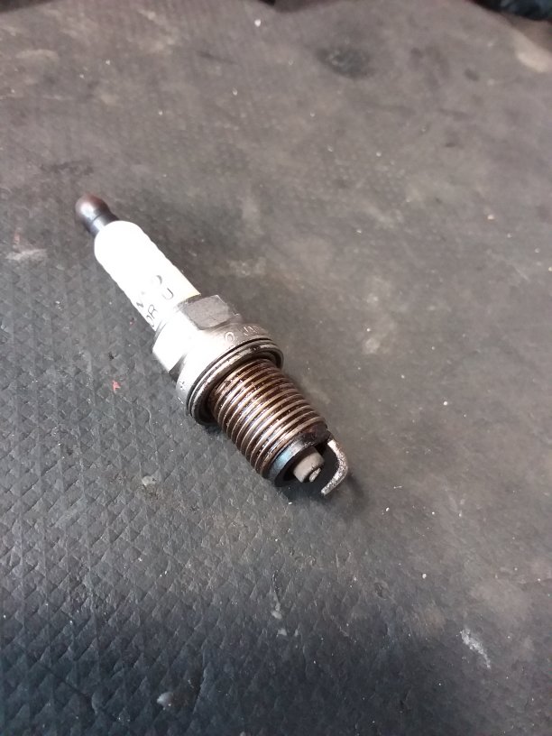

    Also, looking further at stuff, the plugs look like this:
    Fairly clean, but seems like a bit of a gap, no? Probably change them to be safe, since they're cheap - under $3 Canadian each from what I recall.

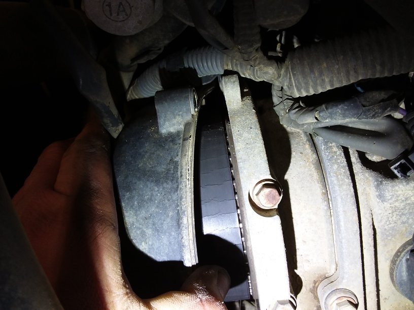

    Made the mistake of actually LOOKING at my timing belt. Oh. My.
    I have all the replacement parts already, which is a good thing. Considering this hasn't broken yet, I think I should buy a lottery ticket as well.

    I think you're the guy I teased a few weeks ago. You live life on the edge man. Respect...

    How many miles do you suspect this belt has?

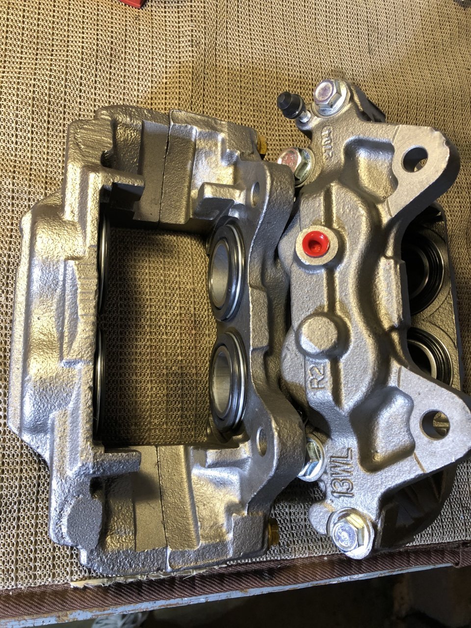

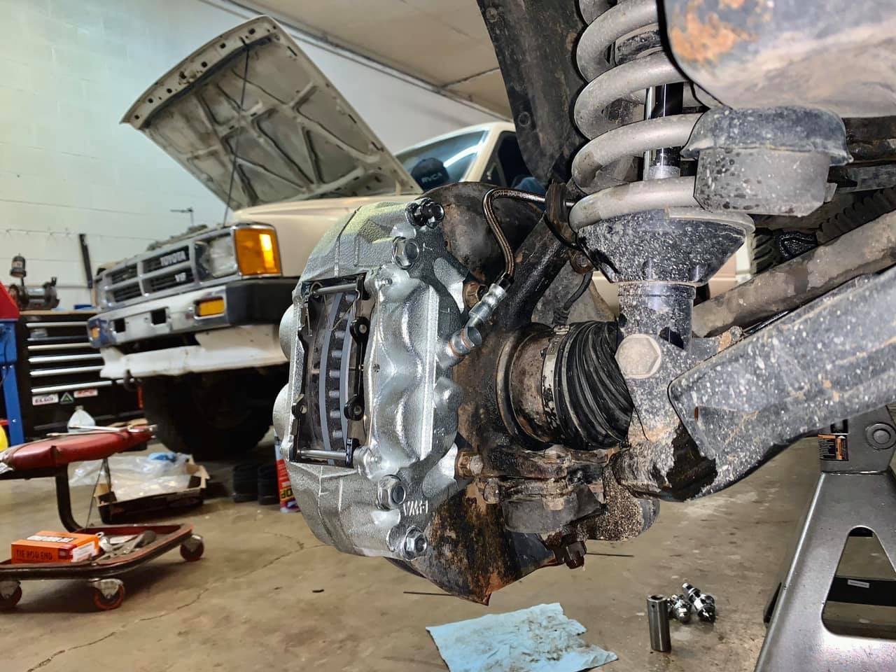

    Everything is in for front brake upgrade. These Truck/Tow pads from PowerStop have a large chamfer on each end. Seems like a lot of the pad contact surface is reduced? Is this how all front pads are made? See pic.

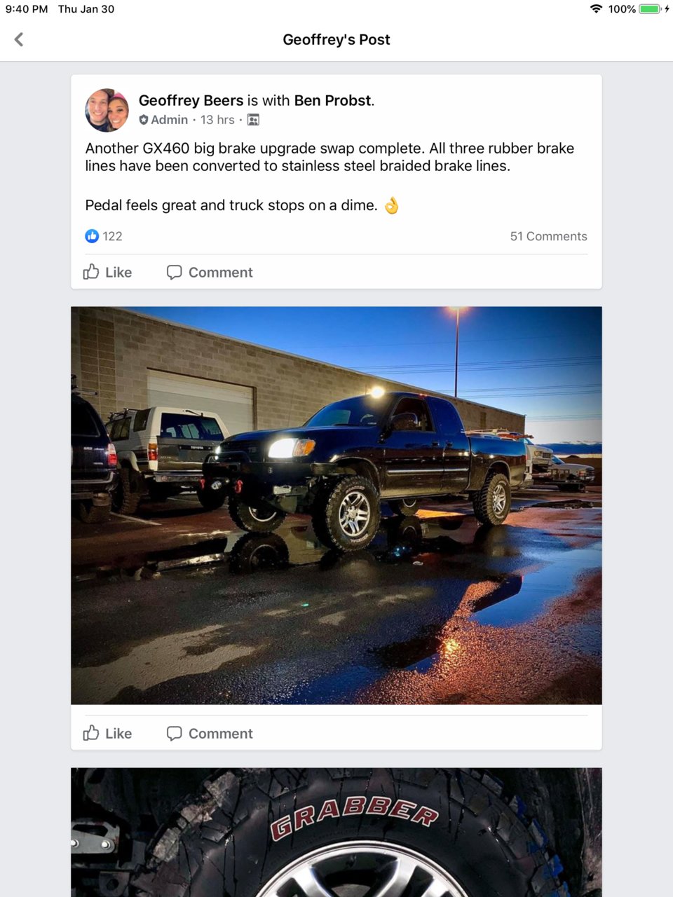

    Did you ever see if he'd come over here and chit chat?
    Where did you see the other pics? :anonymous:

    I could have sworn the dude did a post, and lots of pics, I liked the post, but maybe I was dream liking imaginary posts about tundra breaks, I guess that’s a good problem?

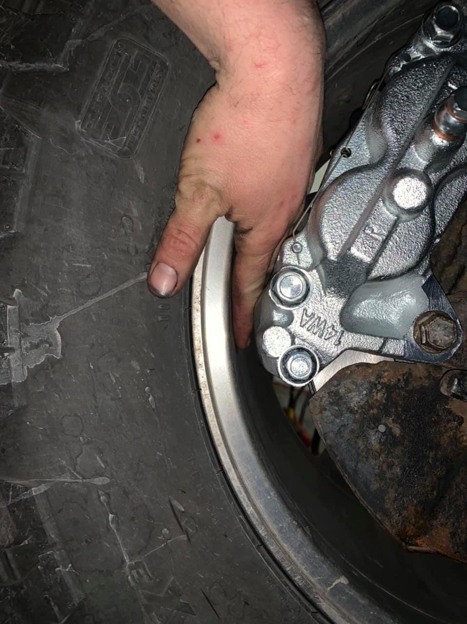

    Someone posted about some big brakes and @empty_lord was on him like white on rice.
    I wonder how much this upgrade costs?
    He mentioned something about a manual LSPV mod. I have a question pending an answer on that thread.
    Wonder if this upgrade needs a new booster etc? Lots of questions.

    He said stock booster.

    Manual portioning valve is a simple mod. But I prefer the lspv, as long as it’s adjusted right.
