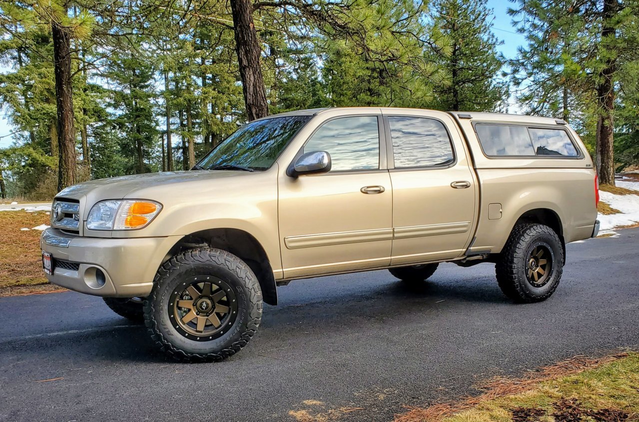

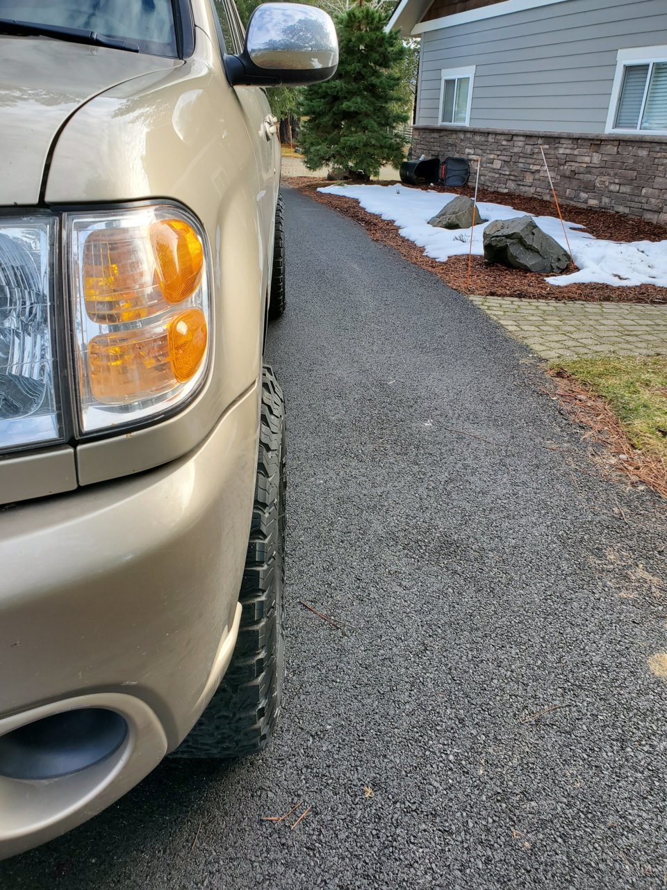

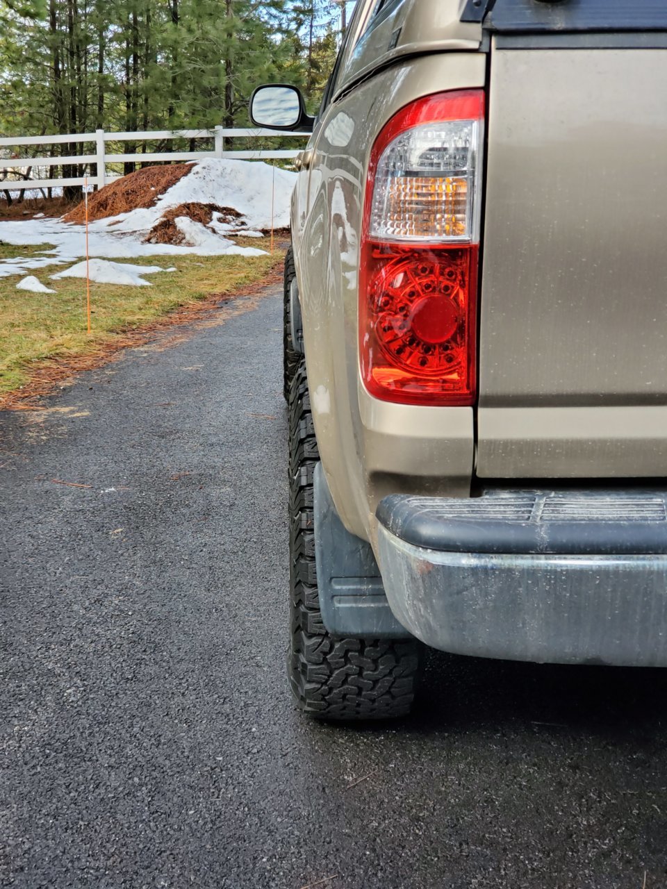

    Today's adventure. SCS are on, Ultras are sold. I like 'em! May not be everyone's cup of tea, but I think the dark bronze goes as well as anything with the DSM, and it will definitely go with some of the other colors I am considering. The -10 offset put me just about perfect with the no flare wheel wells (although a -6 would have been better) With 285/70r17 and the caster set at 2.6, some slight rubbing on the mudflap at near lock. Nothing I can't cure with a hammer and a heat gun. BFGs are definitely louder than the Toyo ATII, but couldn't complain about the price I paid for these slightly used. I'll run them for a while, at least.20200130_150606.jpg 20200130_150714.jpg 20200130_150735.jpg 20200130_150808.jpg

    Those look great!

    I was literally just looking at those wheels last night
    And I think you meant 2.5 caster, camber At 2.5 would be a bit excessive

    No kidding! Yes, Caster. I'll fix that :)
