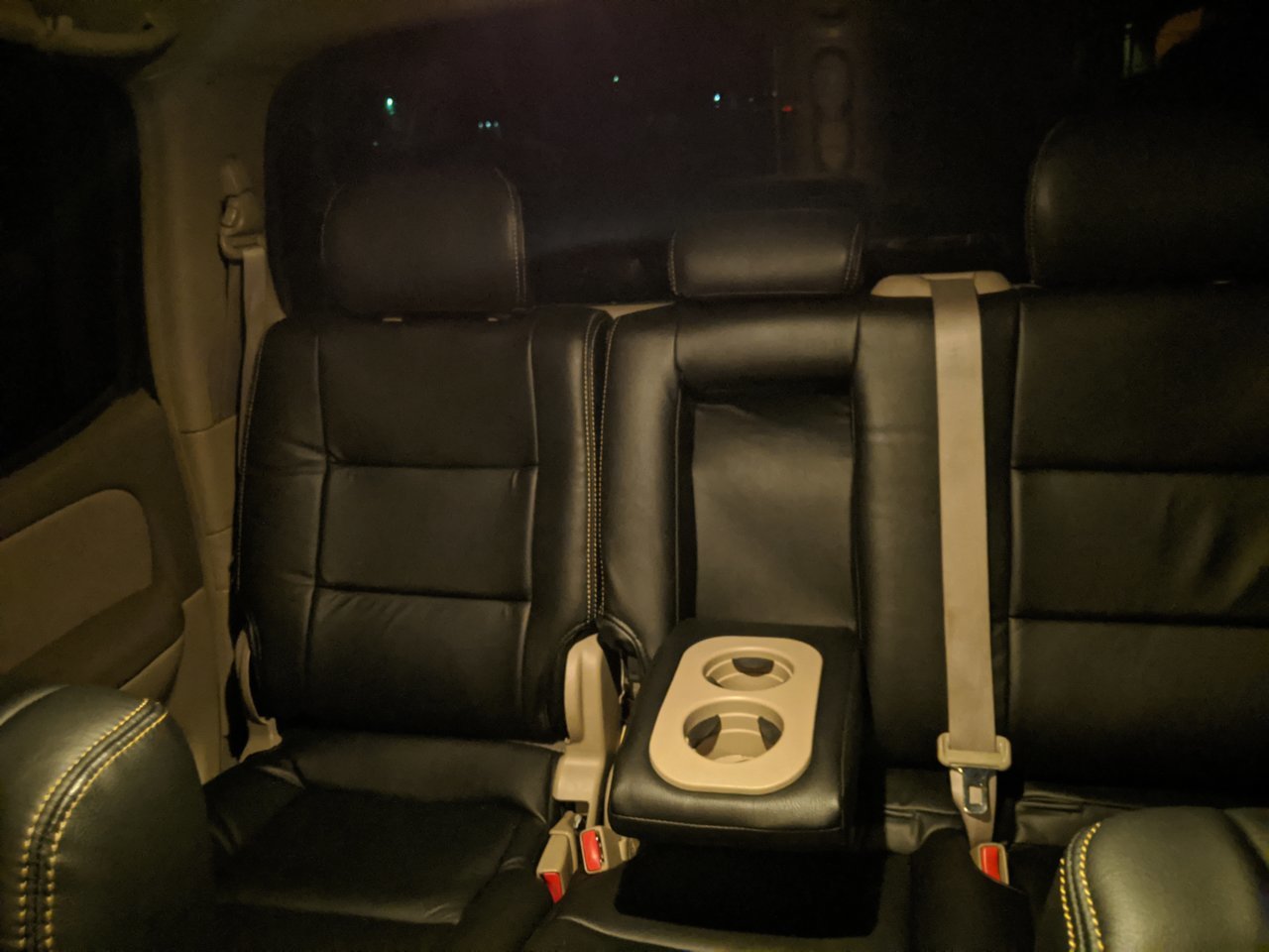

    I got the last section of cover on Friday night. It doesn't fit as tight as the rest, but I might fiddle with it more to tighten it up some. I also did the @Professional Hand Model shim under the front of the seat mount mod and I like it so far.

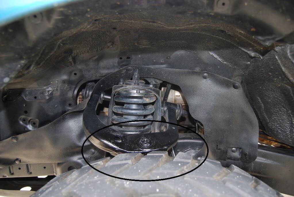

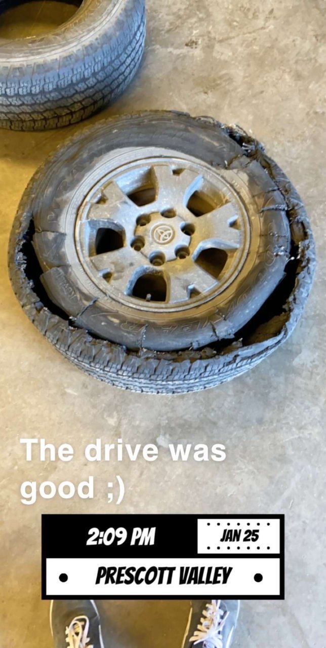

    Took a little road trip up to Prescott to pick up a camper trailer for my grandma and I don't know what we hit, but it slashed my tire enough for it to explode right ont he innerstate. Luckily, nothing happened to the truck, which is really surprising considering it completely exploded.
    And while i was getting the tire replaced, i figured it would be time to upgrade to larger tires, but the bigger size was rubbing on my coilovers, do y'all know what i can install to allow bigger tires. I have a 2 in leveling kit on the front end and the coilovers stick out and bigger wheels won't fit.

    Bigger wheels won't fit? Where is the tight spot that won't allow for bigger tires and or wheels?

    so this is not my truck, but its the exact same set up. it rubs right where the circle is..
    I'm currently running 275/70R16, i was fitting 285/80R16

    Wheel spacers or wheels with less backspacing. They are exactly the same with the exception of another set of lug nuts to use tamper check marking on and keep tight.

    I really dislike leather, but that is looking sharp!

    That makes sense and kind of what i was thinking. I have a buddy that had to get spacers on his Tacoma, and he recommeneded these, https://www.carid.com/2000-toyota-tundra-wheel-spacers/g2-axle-gear-wheel-spacers-498450685.html, i think its time to drop some more money on the Tuna, because those bigger wheels loooked super nice on it.

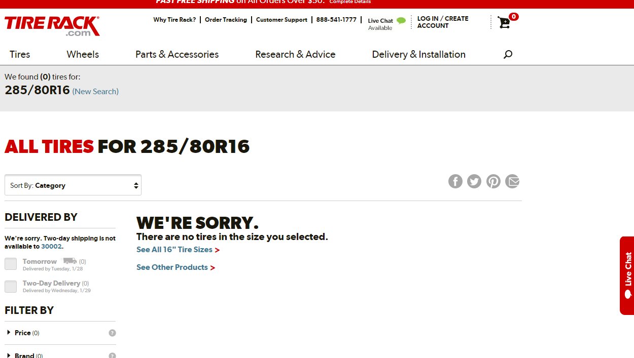

    What he said...and did you mean 285/75R16? I've never heard of 285/80R16s...

    Woops i didn't notcie what i typed, yeah, i meant 285/75

    Ok, makes sense...those will usually work on stock Tundra 16 inch rims without hitting the upper control arm...are you still using the Tacoma rims in the pic above with the blowout?

    Trust me from experience. Only use BORA or Spidertrax wheel spacers. Cheap parts are cheap parts and this is one area where you absolutely don’t want cheap parts.

    yeah, i'm still using the Tacoma rims, so i can either get spacers or just Tundra specified wheels would work. i guess im going OfferUp shopping

    I second this. Also, the rims you're using have a 30mm offset and stock was 15mm so changing to a different offset rim might give you the clearance you need.

    My buddy had the same issue on his 01 tundra with starfish wheels. I sold em a set of 4 1.25 inch spidertrax spacers and cured it.

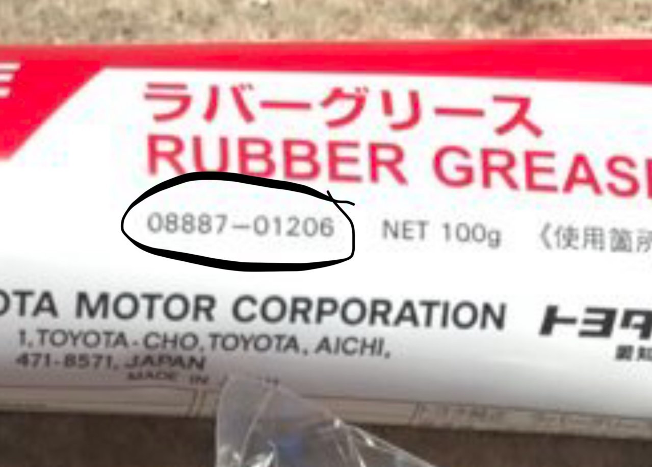

    What’s the part number on that grease? I’m tired of the little packets

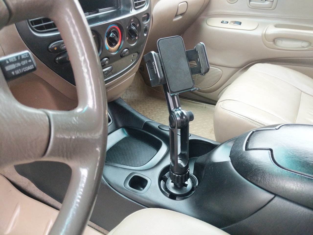

    Might have found a phone holder that's ideal, although I do wish it was a little taller and closer to my line of sight. I could also place it in the pull-out cupholder. Will see if it wiggles when I drive:

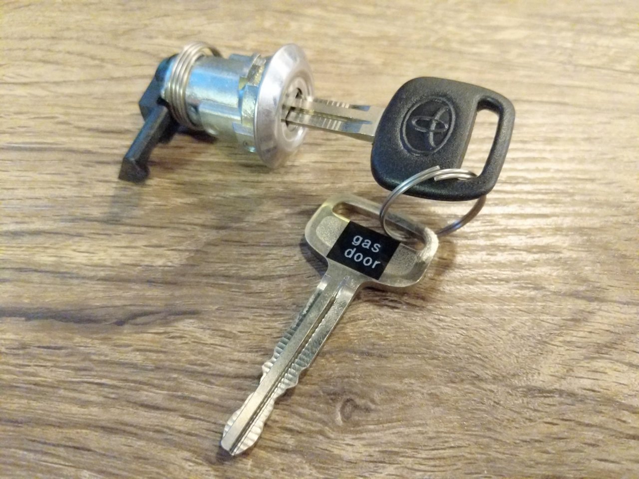

    Also bit the $50 bullet and installed a new gas door lock because I was tired of it flapping all over the place. Previous owner lost the key.

    Yeah, that sucks. I had to pay that for mine from toyoder too.

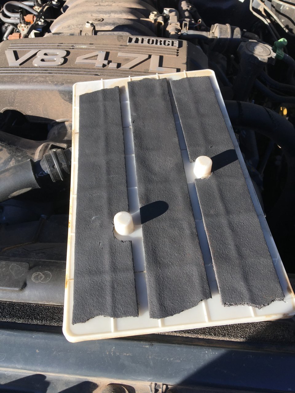

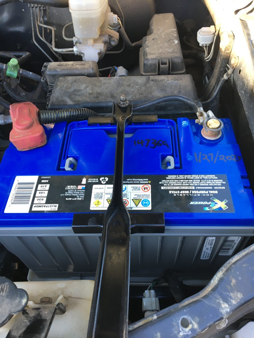

    Nice call on the foam. I did a similar move and doubled up on my Butyl Rubber on the bottom side and also put some inside on top of the tray, as well. Rust Reform and bed liner on the metal areas.

    Was a great time to throw a couple of backseat butt warmers in; did you consider it?
    The seats look great!

    Nah, my kid is the only one back there and he's in a seat still. I don't expect anybody sitting on the seat back there more than 1 time a year. Nobody has sat back there besides me since buying the truck August 2018 and nobody but me has driven my truck besides my dad one time when I was out of town. So the only person on the seat back there was me when I wanted to see what it felt like haha.
