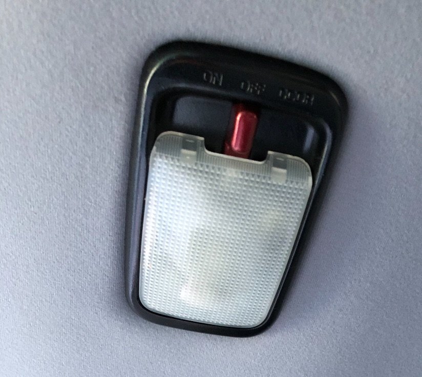

    Put LEDs in the CHMSL and cargo lamps. Four screws to remove the lens cover, plug and play, super easy.

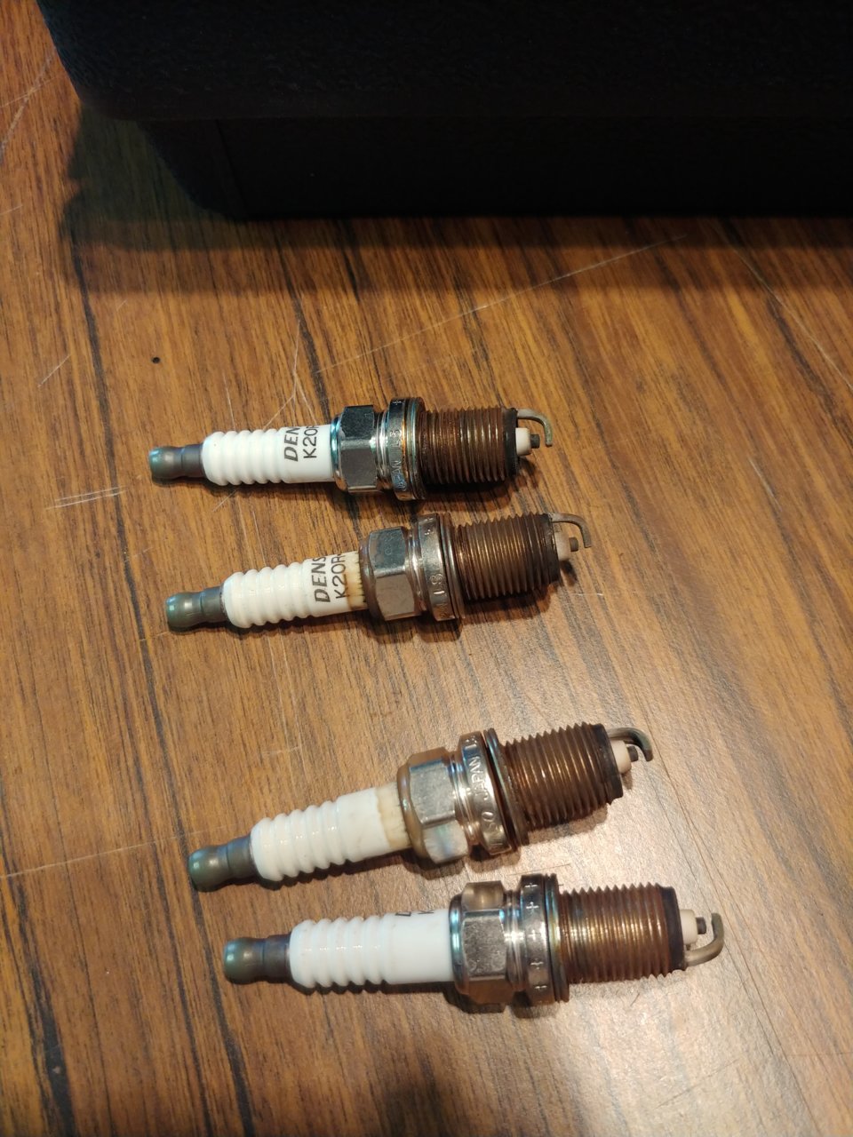

    Replaced my spark plugs today. A few observations and a question at the end.
    • All of the new Denso K20R-U plugs had the wrong gap even though they were supposed to be pre-gapped. Most shipped with different gaps. Always check this!
    • All of the old Denso plugs were too loose. Some were scary loose.
    • The old plugs were installed 4 years ago by a shop that specializes in Japanese vehicles and the owner even has a 1st gen Tundra. I would bet they didn't use a torque wrench.
    • If the pros can't get it right then I doubt most people doing it by "feel" are getting it right. This firms up my belief that this job is a good candidate for a torque wrench which I used.
    • The coil pack that looks the worst is the one I replaced just 6 months ago. That spark plug was also the least tight. Is the coil pack getting burnt because the plug was loose or because that seal on the valve cover is bad?

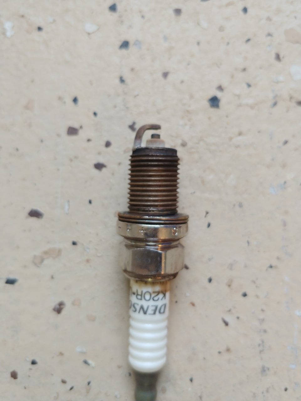

    This is the plug in question. You can see the porcelain was "burned" also. The coil pack was also orange even though it's new.

    Ahh... So you are saying that the loose plug and the coil in worse shape might be connected. Resistance does tend to create heat and kill electronics. Sounds like a decent way to burn up something to me.

    Yes. I find it very suspicious that my new Denso coil pack happens to be in the worst shape and it happened to be sitting on the spark plug that was the least tight.
    The reason I replaced that coil pack is becsuse the original was burnt orange. 6 months later it's burnt again. So it must be the coil or the tube seal on the valve cover is leaking. I'm open to opinions on which is more likely.

    Burnt orange? Sounds like oil varnish

    Right. Would that be from a faulty plug seal on the valve cover?

    Yes. It could also be the tube at the bottom. But that’s usually only a issue on heads that have been rebuilt

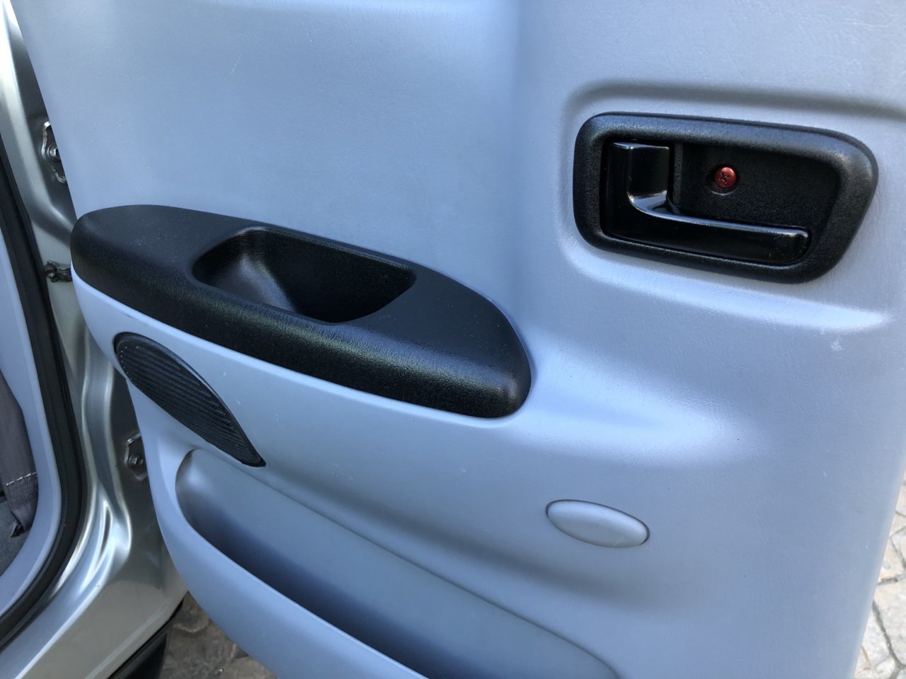

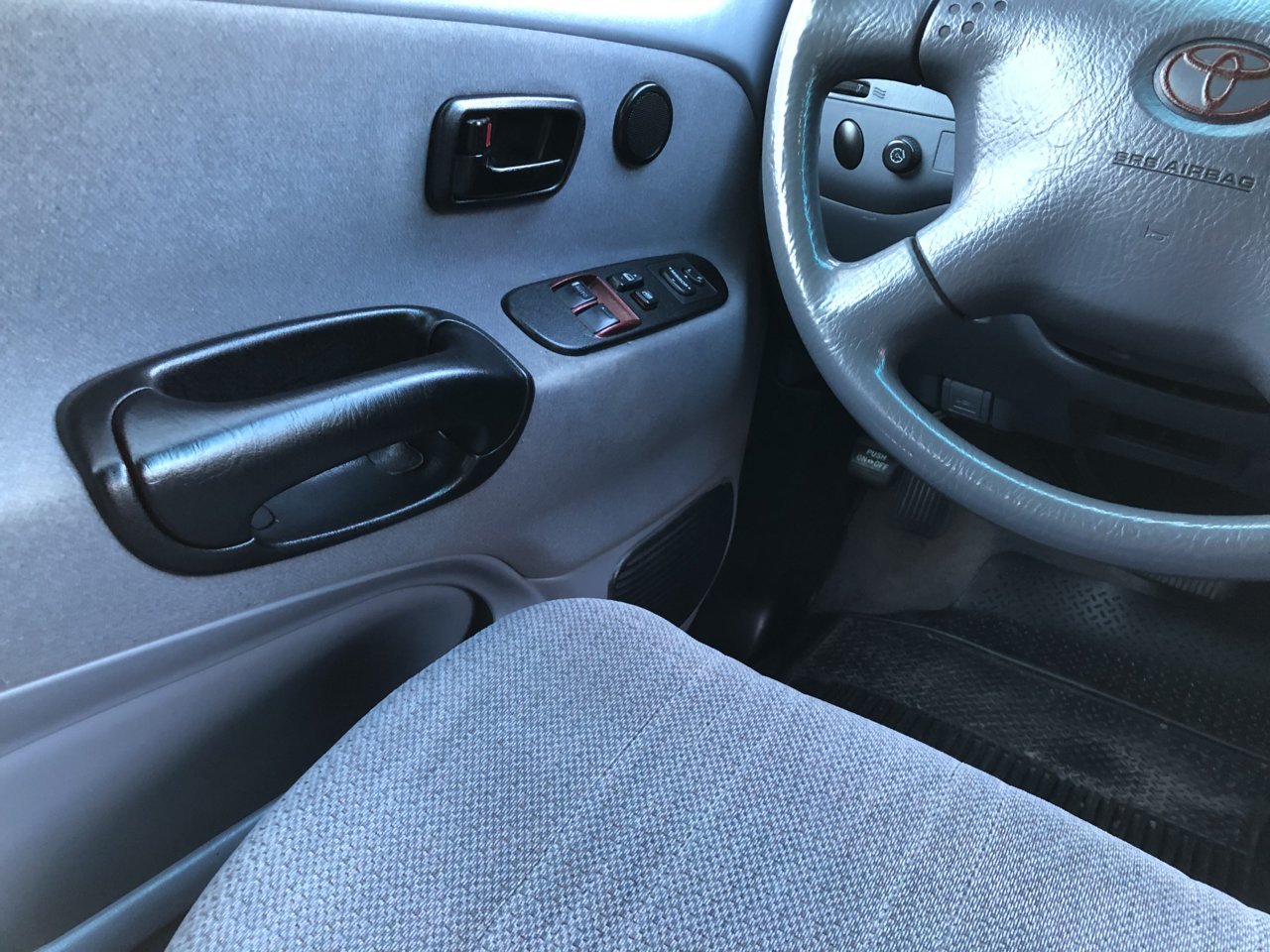

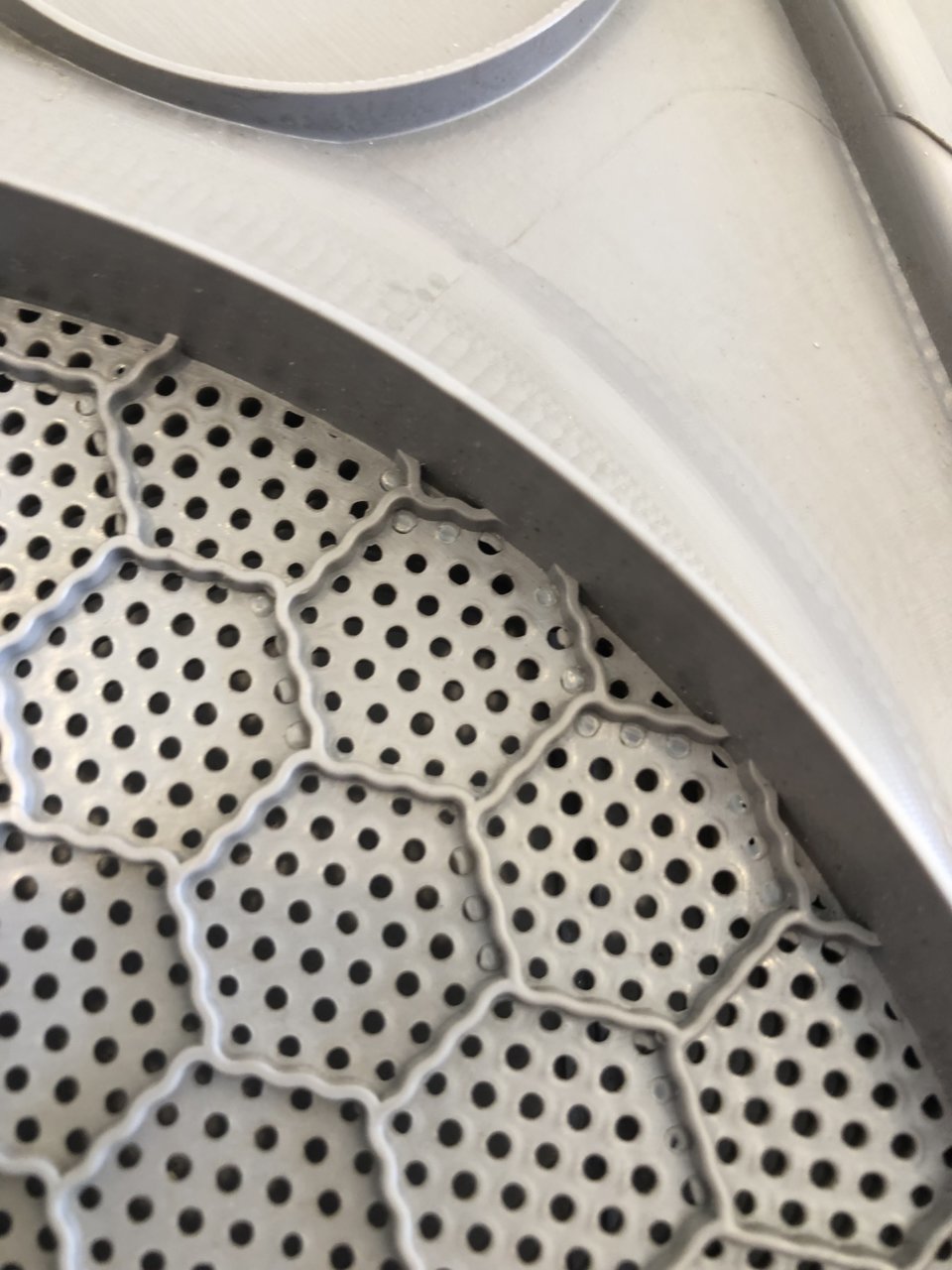

    Looks like the staple and construction adhesive method will hold up on the armrest pretty well.

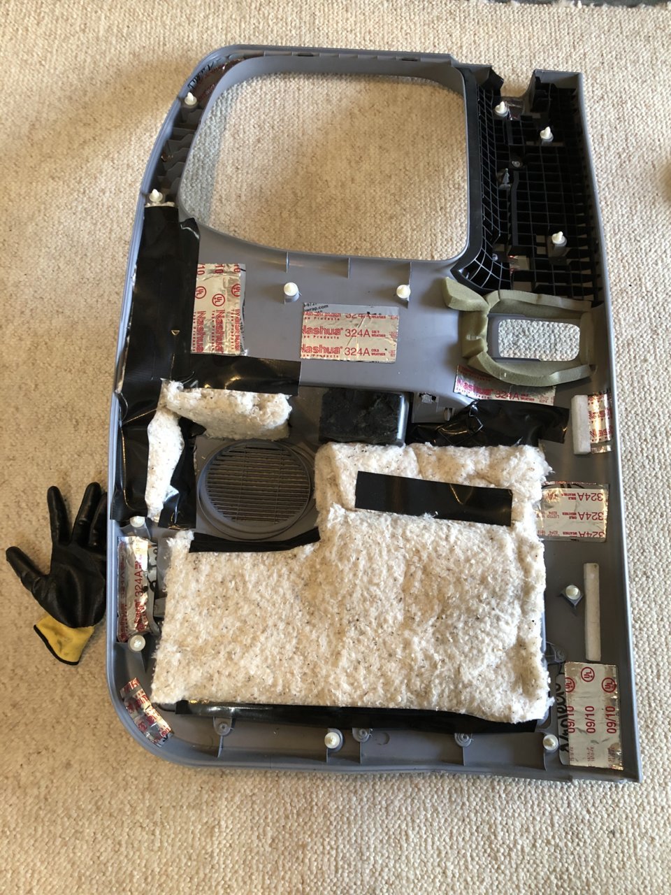

    Just a heads up for anyone who pulls their door panels for anything. Take a look at the backside of the holes formed for the speaker grille. Over 3/4 of mine were not fully punched through. Now I’ve never been upset with my audio but I’m sure that fixing this won’t hurt my sound quality at all. I started using a pick and realized I don’t have the patience for that. Fired up a torch and went back and forth ever so lightly and it opened up almost all of them.
    Forgot to get a before pic but here you can see some that are still closed.

    From what I have read, the orange coming up on the porcelain body is a normal occurrence with miles on the plug.
    You had 4 years on these plugs. IIRC, I remember you commenting on re-tightening all your plugs at the time you installed your coil pack. Commenting on them being a little loose.
    I still stand by my theory that these engines make for loose plugs. Steel spark plug threads and Aluminum engine heads make for differing contraction and expansion rates. You should ask your Japanese Specialist if he uses torque wrench. I bet he does or will at least say he does because even Blowing Bubbles uses one.
    I’d rather have to lightly snug plugs down every other oil change (8k miles) than have a stripped plug thread on soft aluminum from over cranking. This also lets you check the health of your engine.
    Not sure about whats going on with your new coil pack/brand/etc.
    Maybe buy a torque wrench and tell us what it feels like by hand when you go to loosen it in a real world trial test. Then do one plug by hand model instructions without torque wrench and see how they match up.
