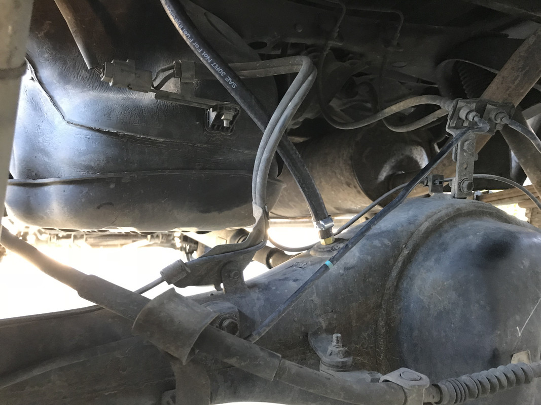

    Installed this little upgrade/safety measure. Those people that are selling kits with 6’ of hose aren’t selling you enough. I picked up 7’ and it works, but I would have liked anouther 6”.

    How’d that nut look when you pulled it out? You run the line up to the bed rail height?

    I think I used about 8ft for mine. I routed it up to behind the driver side tail light.

    Yep same spot for me. Up behind drivers taillight

    What size/thread/pitch etc. is that new brass nut?
    Looks like the old nut/breather can be re-used on the top end of the new hose?

    m18x1.5mm
    90% sure

    That 10% can and will always come back and be an ass biter.
    I’m assuming the one end is threaded (obvious) and the other end is ribbed that goes into the hose?

    I ran my vent hose under the inside edge of my bed rail. I’ve found to much mud and dirt packed behind my tail lights to trust it there.

    Looked just fine. I reused the stock breather at the other end of the tubing that I ran up behind the driver side tail light.
