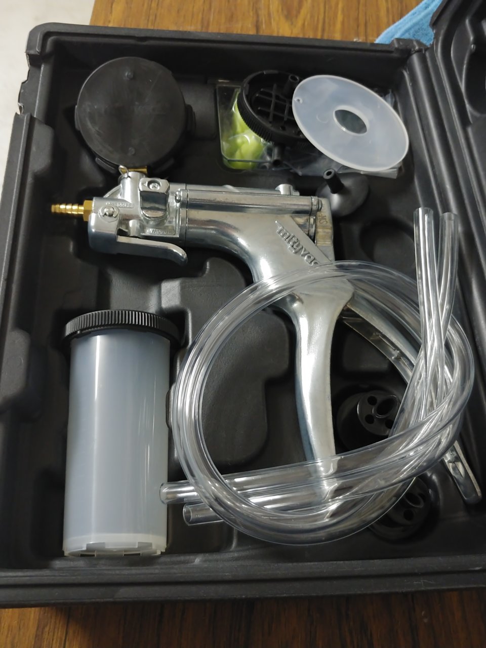

    Mityvac arrived today. Here's to hoping this thing works as well as the reviews claim.
    I'll knock out both vehicles Saturday. I'm really hoping that there is some air left in the lines and that the pedal feels better after this. If not, then I'll just accept the mushy pedal and move on.

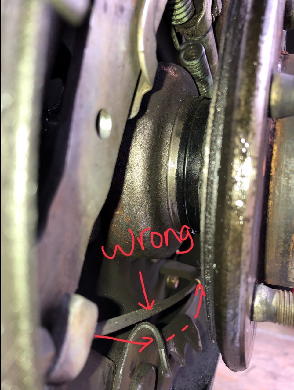

    Ever since I figured out my inner drum parking brake cables were not installed properly years ago, and therefore weren’t self adjusting my parking brake, its been a change for the better.
    Both rear drums were like this.

    Ive only used mine on my road and mx bikes but always had good results. Makes brake bleeding so much easier. Thats a nice setup you picked up.

    Mityvacs are great. Just out of curiosity, what brake fluid are you using?
