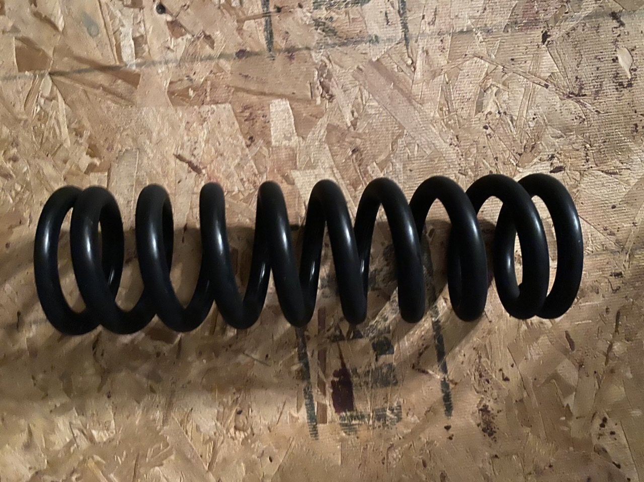

    What do you mean by backwards? Upside down?

    The piece at the bottom that’s flat is suppose to be at the top of the hat

    The machined end goes to the hat. The full coil goes to the bottom into the seat

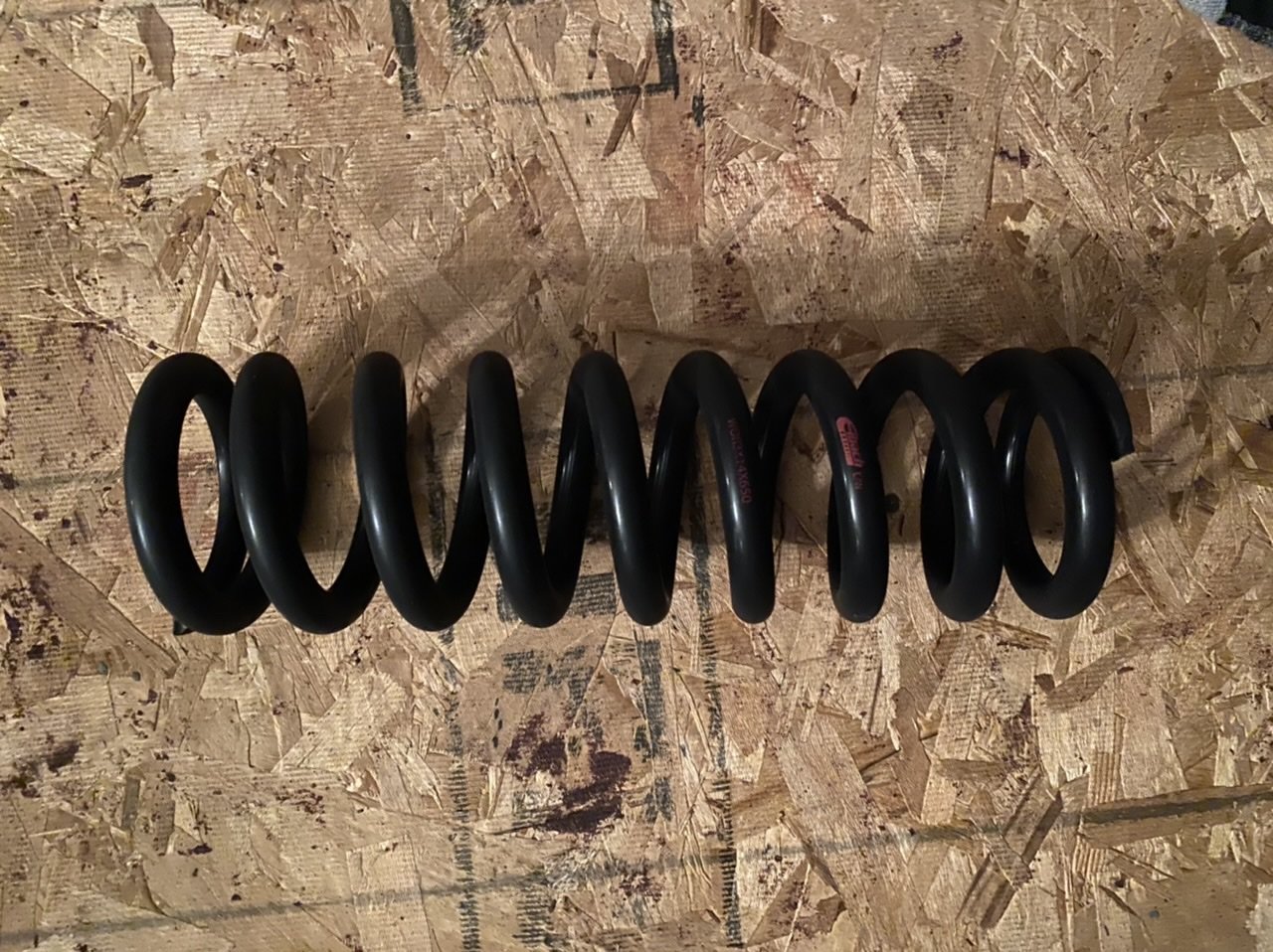

    There is no full coil end. both ends are machined. I have it installed logo up.

    Then that spring wont work

    That spring honestly looks like a 2.5” king/icon spring. Those are the only ones I can think of that use the machined ends on both ends

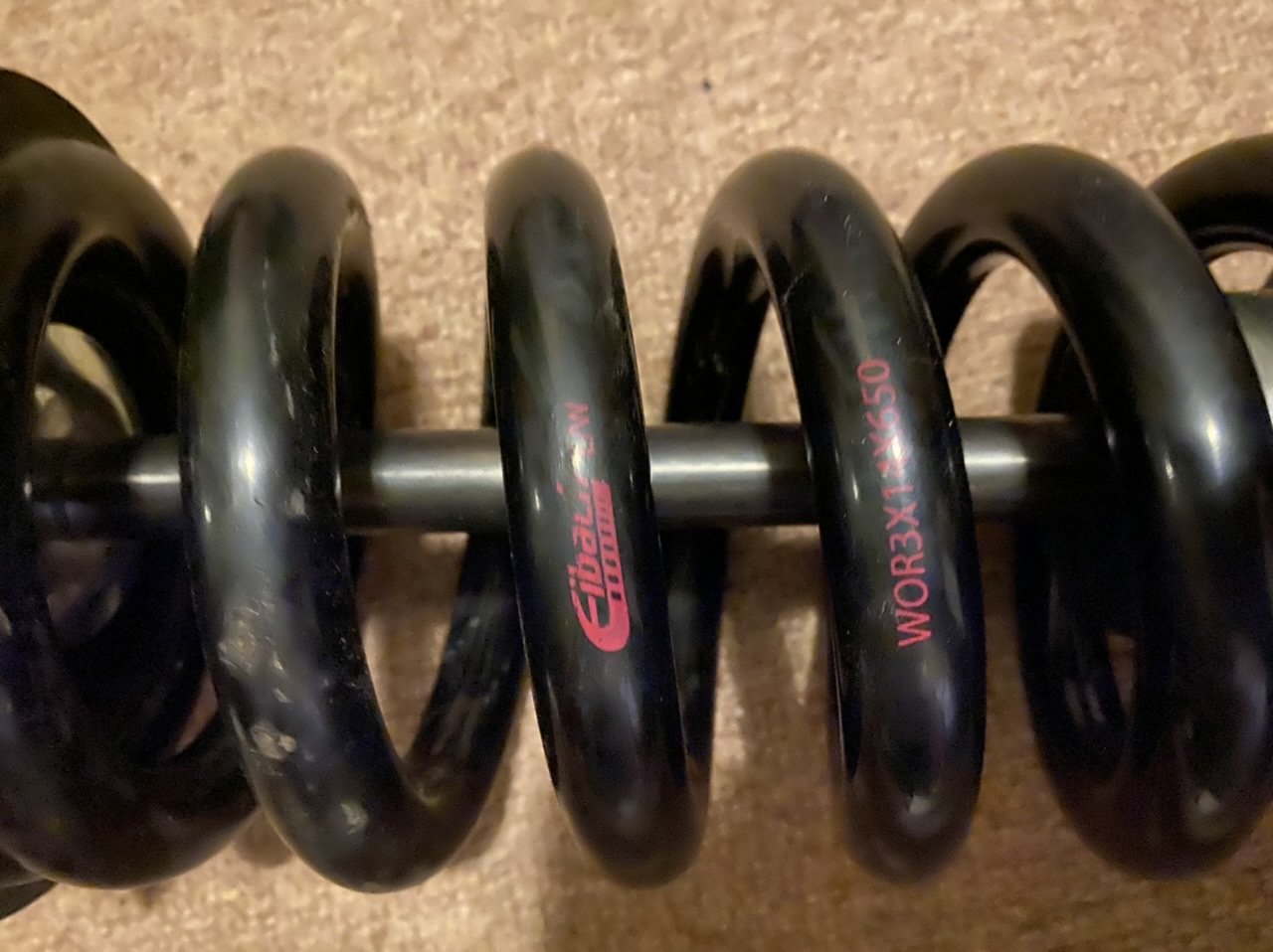

    So then what is wheelers using to assemble in-house? They don’t sell any spring that isn’t machined in both ends.

    It’s the wheelers spring manufactured by eibach.

    I would call them. I’m sure there’s a spring somewhere on there (I think the silver ebiachs

    I was kinda worried that they wouldn’t work, but there weren’t any other options, and I knew they assembled could. Should’ve been more dilligent.

    They are made for coilovers unfortunately, won't work for your application.

    I thought Eibach sold a coilover thats was already assembled? Another member bought them. Were you just trying to save some money?

    Yep, saved almost $100 by assembling myself, although now I didn’t. :annoyed:

    I love wheelers, but not their website...it sucks...and they have stuff not on there...you need these...they are not listed on Wheelers site but I bet they have them or can get them...see if they will do an exchange.
    E30-82-066-04-20
    https://eibach.com/us/i-7744-pro-lift-kit-springs-front-springs-only.html
    I THINK these are for 4WD as well....but confirm with Eibach before contacting Wheelers...good luck...:thumbsup:
