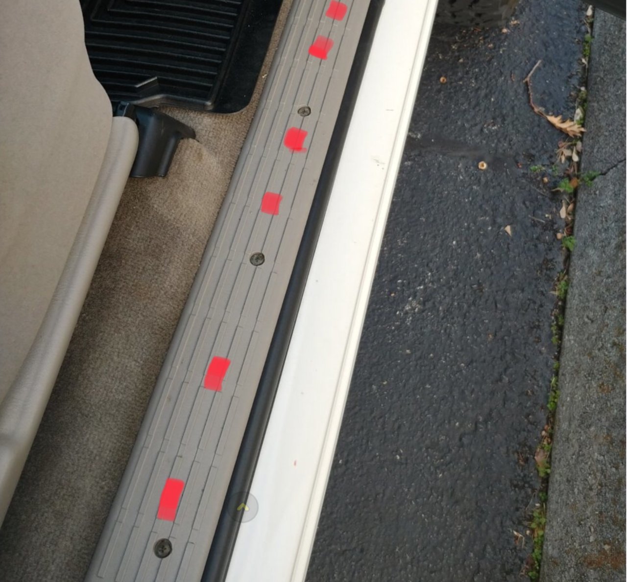

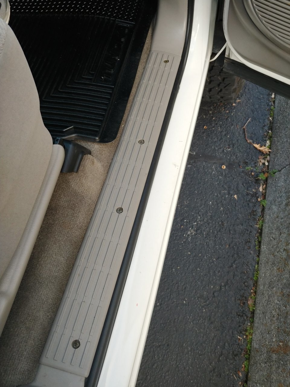

  10. Dec 31, 2019 at 5:33 AM
    FirstGenVol
    Dec 13, 2018
    #22934
    14,278
    East TN
    2002 AC TRD 4x4 V8
    What is the trick for removing this kick plate? I pulled all 4 screws and it didn't budge. I didn't want to break anything so I backed off.
    Is there a particular place I should pry? It almost feels like it's glued down.
    NUDRAT likes this.
  11. Dec 31, 2019 at 5:45 AM
    Professional Hand Model
    #14878
    14,993
    Fred
    Hand Protectors
    Pry it up with a wider type bar or screw driver. There are wedges built in connected on back of the plastic that tension fit into the truck body metal.
    FirstGenVol likes this.

    Wouldn't think my 2004 is different from ya'lls but while at pick-a-part right now, this is how mine is also. The red circles are the screw holes AND the clip mechanism, lack of better word.
    Before you go back in, squeeze the plastic ears inwards a bit to fit in rectangle body hole circled in red. Screws will then spread them back apart some.
    KarmaKannon and FirstGenVol like this.
