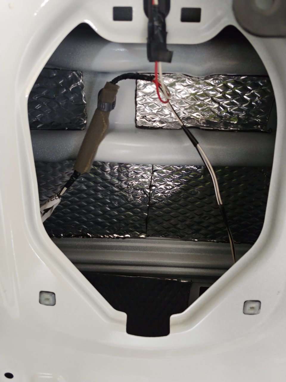

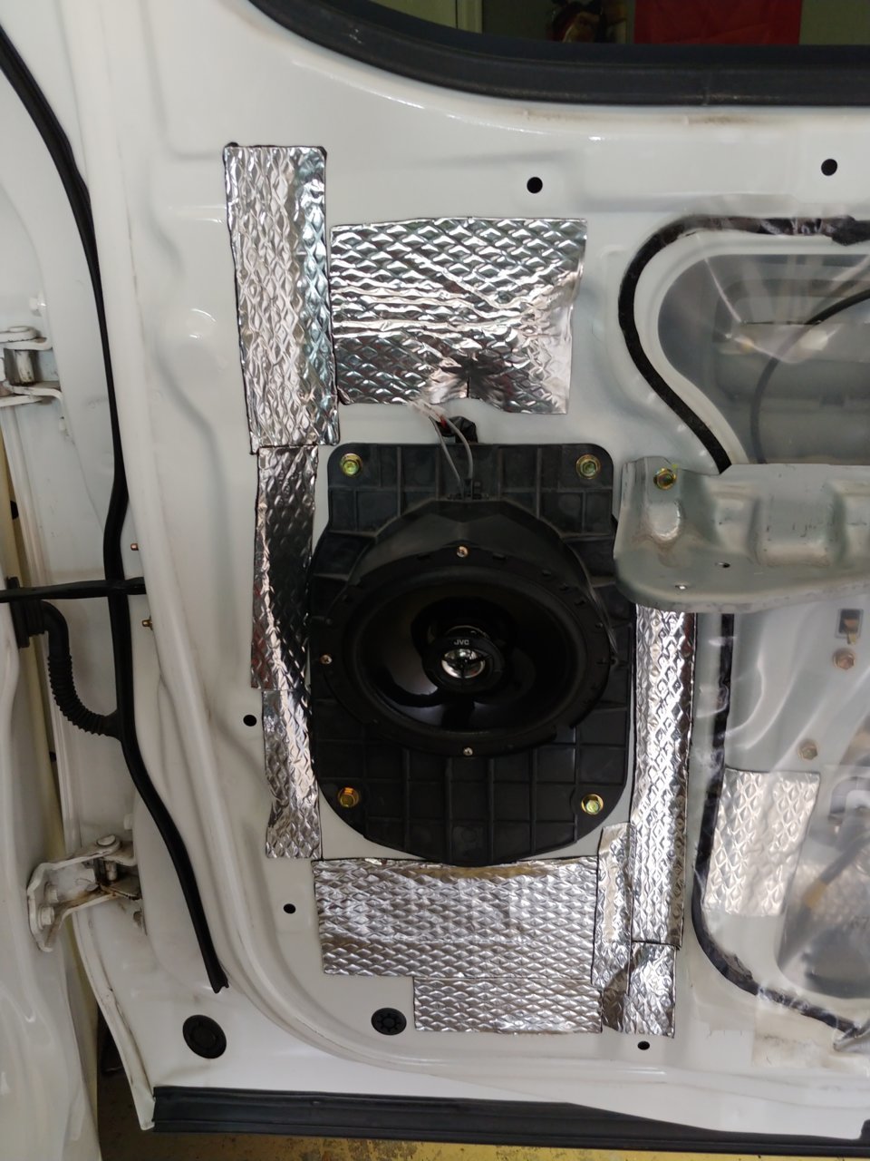

    Got the Noico project done just as the sun went down. I pulled the speakers and applied it behind them. I went on Noico's website and of course they say to cover every square inch. I probably could have covered more because I still have a lot left. I didn't realize a box would go this far. I'll pull the rear seat next. If I have more left after that, I'll go back over spots I missed or do some of the floor.

    You can put some on the back of the plastic door panels also.

    Doors definitely sound better when they close but not as good as some describe. Probably because I didn't cover as much. The stereo sounds a lot better though. My wife came out as I was finishing and we both sat and listened. She wants me to do her Rav4 next.

    @FirstGenVol my approach on sound deadening has always been to worry about flat areas most. Areas of curved metal dont tend to reverb much so they're last priority to me.

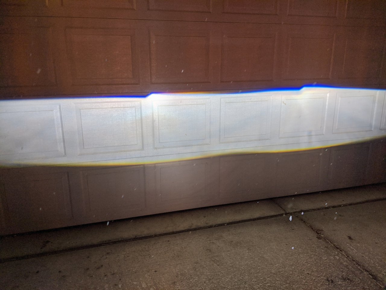

    I used some weatherpack style 2 wife connectors on those. I just ran the wire through the bottom hole left from the old bulb in the housing and I used the 3m poly to seal it.
    The light output is great. I had to adjust them up a bit and I thought it was too far. I parked on the side of the road and walked away from the truck and as soon as I was 10' from the truck it was apparent that I wouldn't blind anything taller than maybe 3.5'. As with all projectors, I may get flashed on a bumpy road as my headlights aim up and down, but under normal conditions it looks I have daytime running lights from the front. I guess I got the passenger side a little crooked, but it isn't too bad. I may fix it one day if I'm in the mood to remove my headlights and reglue the projector mount. I'm thinking I'll be just fine living with my already vastly improved light quality.
    A- it isn't perfect, but I'm happy.
    B- unless something changes I'm not going back to conventional headlights.
    C- I may still do the 55w ballasts.
