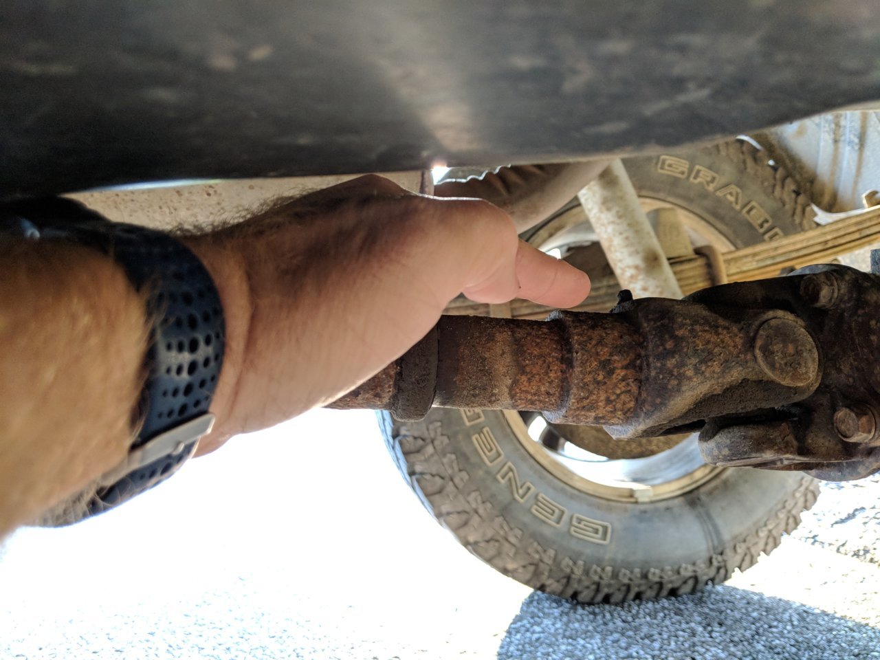

    Have you ever greased the slip joint on the driveshaft?

    No, I’ve only owned the truck for two months. It was at the dealership a month ago and they didn’t say anything about it. Can I self diagnose by crawling under the truck?

    Yup easy enough, put a few pumps of grease into this fitting and see if it gets better. If you really want to get after it unbolt the flange at the rear axle and see if the shaft will slide.IMG_20181003_175047.jpg

    Thanks! I’m assuming you want the shaft to slide?

    Yup it allows it to move with the rear axle.

    If you pump those zerks on the rear joints the grease should flow out of that shaft slide. I know mine does. Thats when I stop pumping the grease in.
