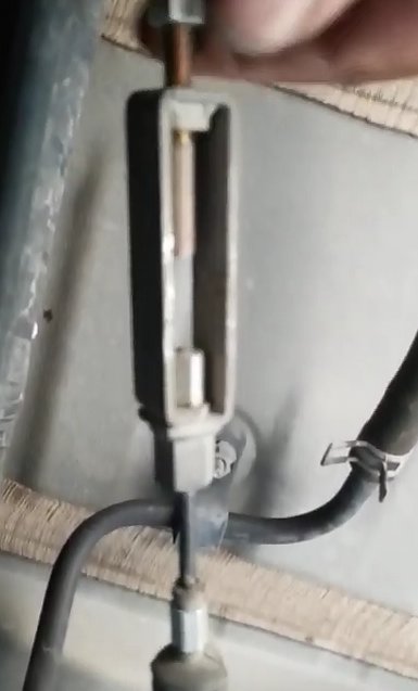

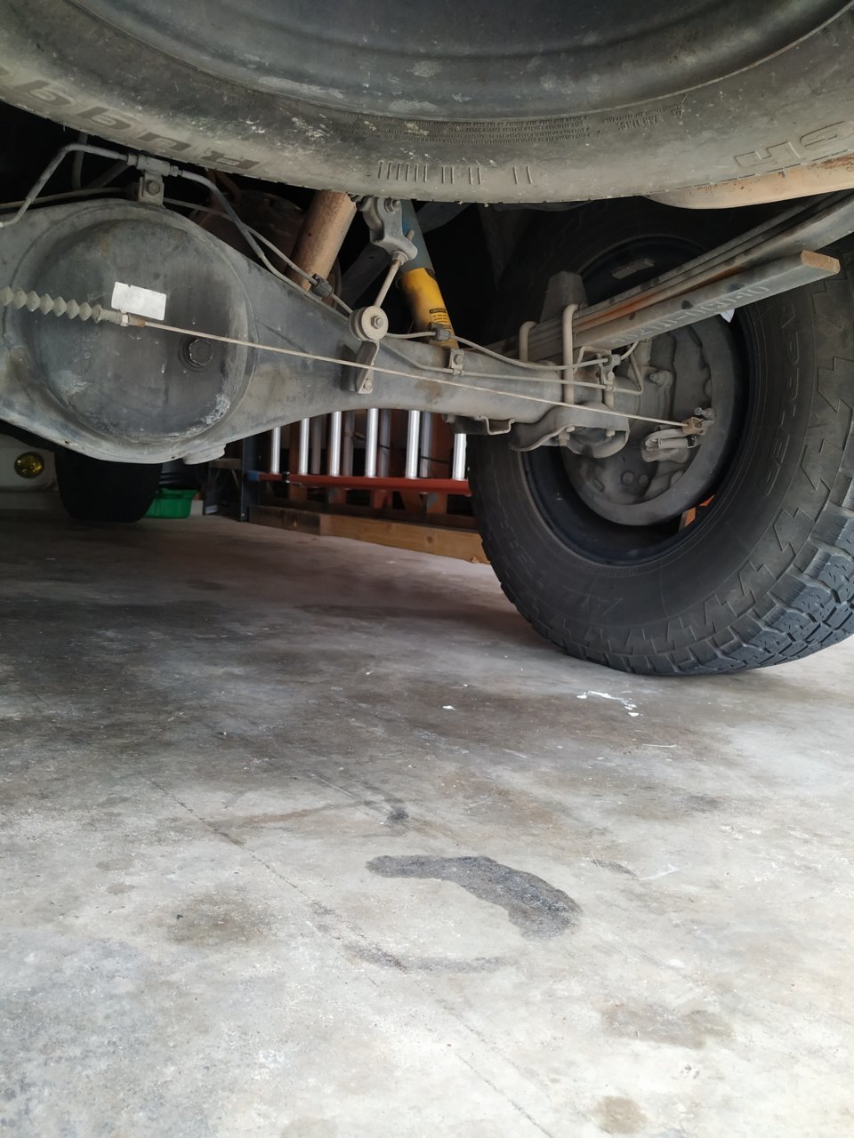

  14. Dec 20, 2019 at 3:06 AM
    FirstGenVol
    Dec 13, 2018
    #22934
    14,347
    East TN
    2002 AC TRD 4x4 V8
    I need to figure this out. Tried once but didn't make enough effort. How do you tighten the cable?
    NUDRAT likes this.
  15. Dec 20, 2019 at 4:58 AM
    Professional Hand Model
    #14878
    14,993
    Fred
    Hand Protectors
    Its a turnbuckle. Use two wrenches and adjust accordingly. Make sure you guys do this adjustment at the backside of the rear wheels, as well. This entire systems mojo is finicky. If one thing is off, then the whole deal is off.

    I did this before and did not get the same results as @TX-TRD1stGEN Clearly I didn't do it correctly. I'm a visual guy. I learn best from videos.
    Edit- I thought you said your parking brake sucked? Did you figure this out?
    Bulldog_tundra and TX-TRD1stGEN like this.
  18. Dec 20, 2019 at 6:04 AM
    #14878
    14,993
    Fred
    Hand Protectors
    I did. We put the drum adjustment cable where it is supposed to be on both rear wheels inside the drum on Monday this week. I’ve driven and exercised the brakes and the mojo is back in proper form. The PB can stop the truck at slow speeds now, whereas before it could not.

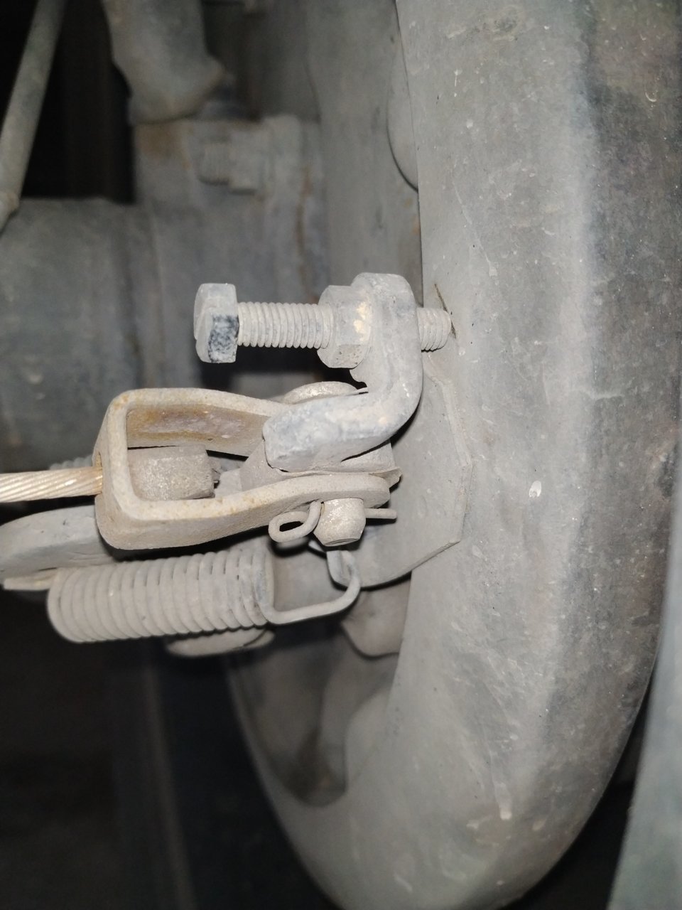

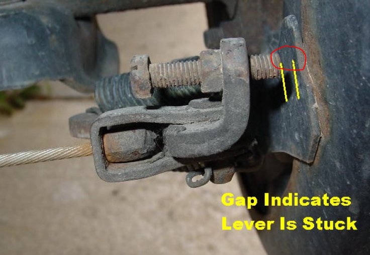

    @TX-TRD1stGEN
    help me out here. I don't have the gap between the adjustment screw and the backing plate. How exactly were you able to make improvements?
    Or are you saying you took slack out up towards the front of the truck?

    I adjusted the one up front in drivers side (2nd pic).
    FirstGenVol[QUOTED] likes this.
  30. Dec 20, 2019 at 8:12 AM
    TX-TRD1stGEN
    TX-TRD1stGEN Privileged
    Sep 12, 2017
    #9618
    890
    Seth
    South East Texas
    2000 Tundra 4x4
    Mine had no Gap and cables are all tight.
    I rebuilt my brakes last year as well so that might help?
