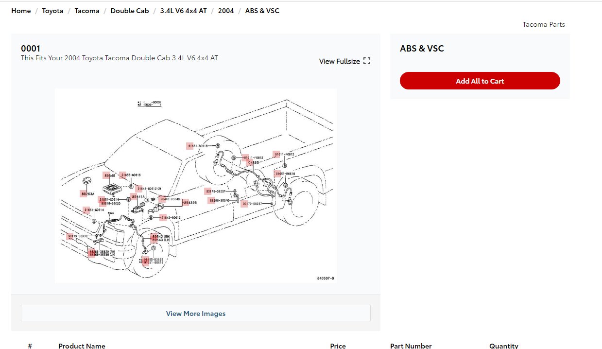

    I haven't researched this enough to know if it works with our Tundras, but the Andy Mod 2.0 does what you're wanting (turns off VSC while keeping ABS) on late 90's and early 2000's Tacomas and 4Runners. There's so much crossover among these vehicles that it's likely to work -- and certainly worth investigating.
    If you don't care about keeping ABS, the original Andy Mod is also in that link.

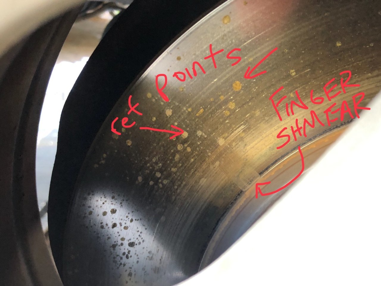

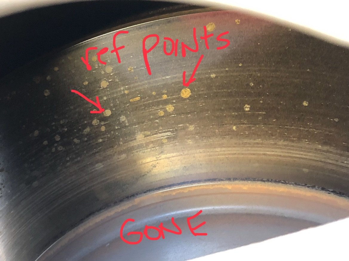

    Looking for advice. Jacked up front today for steering rack install and got distracted by a shiny object. Spun front wheels. Pass side had a decent spin. Driver not so. Could hear dragging on both, though.
    On drivers side, I made a mark with my finger on both rotors and spun one revolution. Results: The finger mark was erased after one revolution. See pictures.
    Dropped her and went about a mile drive. Jacked her back up and still the same resistance.
  15. Dec 18, 2019 at 10:06 AM

    are the spreader springs installed on the pads? Is the pas moving freely in the caliper? Those are things to check. If crud has built up and the pad is sticking to the caliper you’ll get slight drag. Same if the clip isn’t installed

    Not sure as I haven’t taken wheel off today.
    Brakes are new hand model territory. I’m down with doing a clean up on these front calipers. I’m planning on a brake bleed of all wheels, as well. Need materials and labor advice info. Pads and rotors are a 1.5 years (12k miles) old installed by others.

    There shouldn't be much drag but I think the pads touching the disc is normal.
    Check the temperature of the disk with a laser thermometer after driving. See if both sides are close to the same

    Ok. The pass side freely spins, but the finger shmear test shows it rubs off. You can hear a slight rub.
    Driver side spins with resistance, but isn’t hard to spin. Its stops its free spin faster though. You can hear resistance.

    All good suggestions so far. A little drag is normal. The only thing moving the pad away from the disk is that little spring and natural vibration. Taking temps of both sides will tell you if there’s a discrepancy. Your fingers should be good enough for what should be cold brakes. (No hard braking before checking!) Also look for pad wear. Make sure the guide pins are clean and all the contact points have some brake lube. I haven’t rebuilt the calipers on my tundra yet, but have done several on my other car. Typically pretty easy. Emery or steel wool on the pistons to clean rust and gunk. New seals, etc.

    First gen tacos and 3rd gen 4runners didn't have vsc

    01-02 4runners did.

    Very rare, but some 03-04 tacos did too

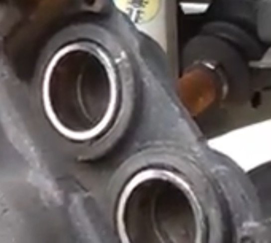

    Should these pistons be extended via braking at pedal and then lubed and then pushed back in for best lubing technique?
    I only see people smearing grease on the outside rim mating surface, but not actually extending piston to grease as much of piston as possible before it is recessed back in.
