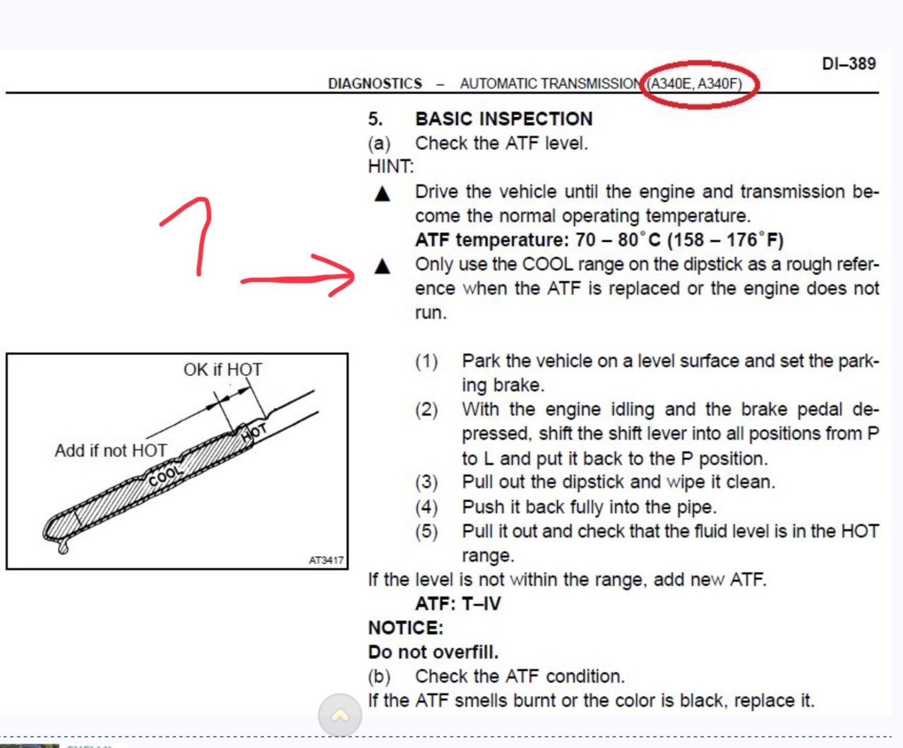

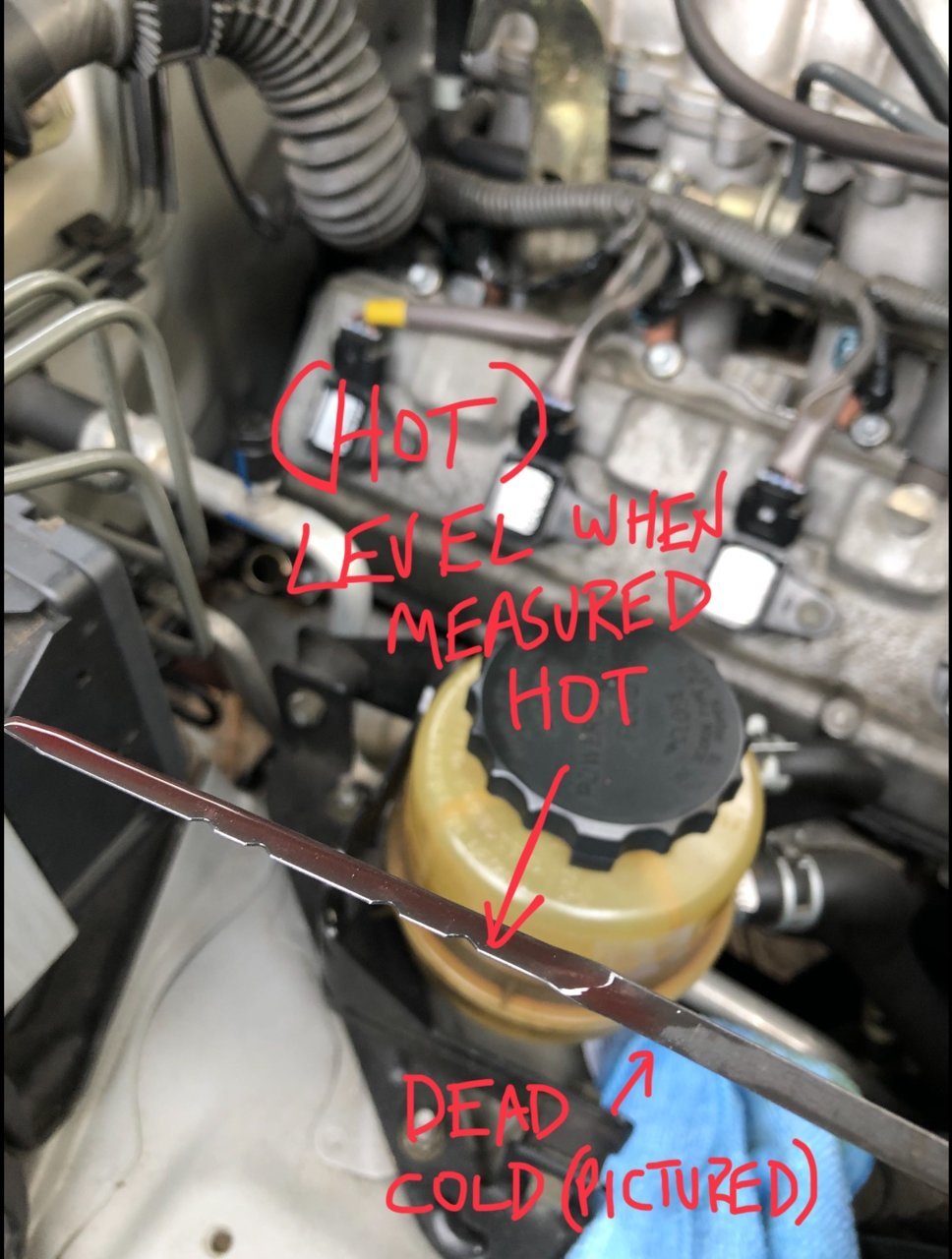

    ‘Splain this Flucy. Yes its on level ground.
    Why is there a lower hash ‘cold’ measurement on this dip stick by Toyota? When ‘cold’ reads higher than the upper hash ‘hot’ when the proper engine level is attained? Baffled.
    Sumting wong.

    The pan is the lowest part of the system so the fluid drains back into the pan while the truck is off.

    Yes. This was my assumption, that gravity did its work, as well. With that being the case, why are the cool hashes lower on the dipstick than the hot hashes?

    Yes when running. No in N. I checked it per the Toy spec (see above) for A340f transmissions. Says to check in P. Run it through all gears and then put it in P.
    The above pic in post #12552 is my dipstick dead cold 40°
    When engine is at idling operation temp (guessing) and after being warmed up and driving (guessing temp again), the level reads as stated in other arrow in pic (hot).

    I'm guessing since it says "rough reference" is that it gives you a level to start without overfilling since it's easier to add more than remove it.

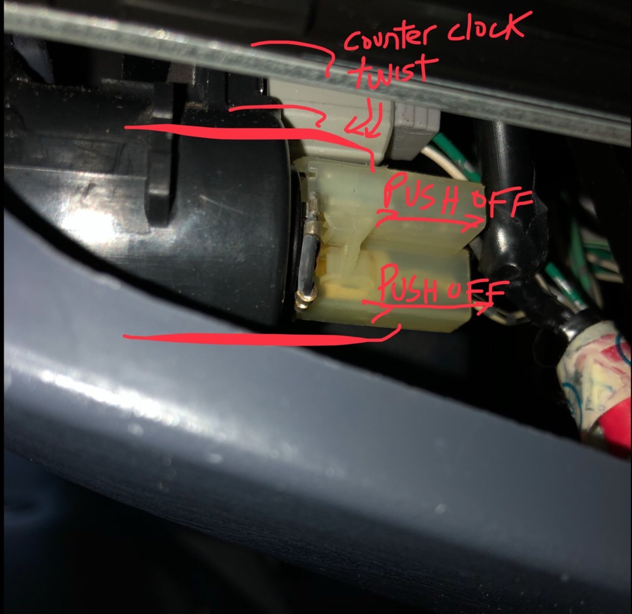

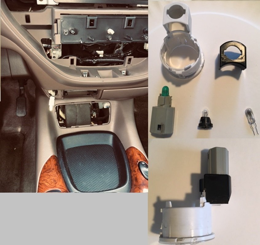

    Decided today was the day given the weather that I would attempt to replace the cigarette lighter illumination bulb. Wow and quadruple wow and I'll add that when this one burns out I will definitely get another gal of patience at Wal Mart because one gal was not near enough. Then agin it may simply stay burned out
    I viewed the below video and then deviated where I felt it was better for me. As for the pictures I added, the black holder with bulb was a left over from led change out of Instrument Panel using NEO4's in it's place.
    One will either need to get with @Roman if they wish to purchase the original grey socket with bulb. I used a good minature T bulb(don't know size #) similar to the bulb below with leads. In order to remove the bulb from the below grey socket, one has to push the 2 pins out of the socket....pushing the pins from inside of socket towards the outside of socket. The bulb with it's leads and the 2 pins are then free. To replace bulb, feed the leads of the bulb thru the holes where pins came from starting from outside socket toward inside. The bulb will be in rest and the 2 pins can be replaced and be able to slide right by bulb. If one does get to the point of replacing the bulb, most of what I find hard to explain will become self evident. If not, Please feel free to ask....time to have a stiff drink :eek2:

    Exactly. I’ve tried about 4 ways so far without complete disassembly like you’ve done. Tell me if this is possible using 90° needle nose pliers.
    Grab and push off bottom plug. Grab and twist bulb housing off. Remove bulb and insert new T-bulb with base (LED from a batch of extras). Almost like fine surgery.

    short answer yes for lighter plug, with the upmost care. In fact having worked in electronics 40 yrs, I did not want sparky showing up so I disconnected the battery….but that's just me. As for the illumination bulb, once someone has gotten that socket plus bulb in hand, the info I first shared above should possibly be more clearer. There is no T-bulb with base unless someone is referring to grey socket, shown above, with bulb and green condom.
    I'll add very very fine surgery that's almost not worth it unless someone is hard headed like me at my old age :)
    Oh @Professional Hand Model, your model hands will not be pretty when you finish. It is some tight quarters in that there dungeon :oops:

    I tried the push method and backed off as the others wire tension stopped the backward push. I swear it looks like Mr. XM’s prior work is preventing me from the method I described. I took off the ashtray sliders frame which gave me more room than my posted picture side view where its still in place.
    I think you are correct in the battery disconnect. My pliers were getting close to Zzzzttt!

    There lower marks on the dipstick are for engine running, not fully warmed up yet.
    With the engine off its going to read high.
