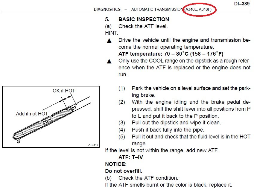

    Speaking of transmissions I’m starting to think I may just take the trans out and send it to the tranny shop. It just feels... off in 5th gear on the gas. Wonder if line pressure isn’t high enough. We’ll see what my trans guy says when I see him,

    From FSM:
    10. AUTOMATIC TRANSMISSION FLUID LEVEL
    (a) Park the vehicle on a level surface.
    (b) With the engine idling and the parking brake applied, shift the selector into all positions from the P to
    L, and then shift into the P position.
    (c) Pull out the dipstick and wipe off the fluid with a clean rag. Re–insert the dipstick and check that the
    fluid level is in the HOT range.
    (d) Do this check with the fluid at normal driving temperature (70 – 80°C, 158 – 176°F).
    HINT:
    Wait until the engine cools down (approx. 30 min.) before checking the fluid level after extended driving at
    high speeds, in hot weather, in heavy traffic or pulling a trailer.

    Is this FSM for the A340f transmission?

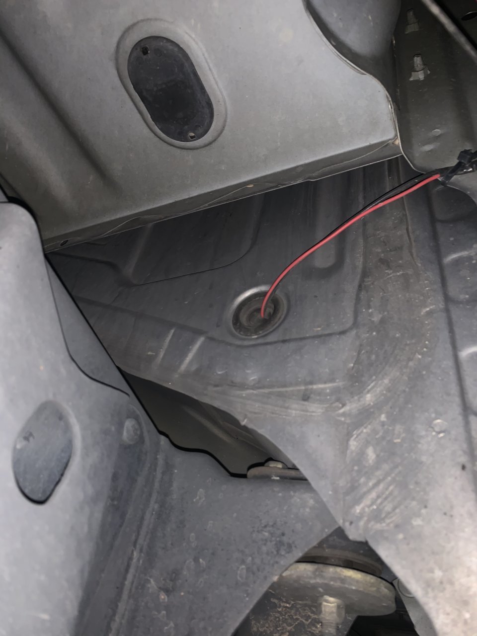

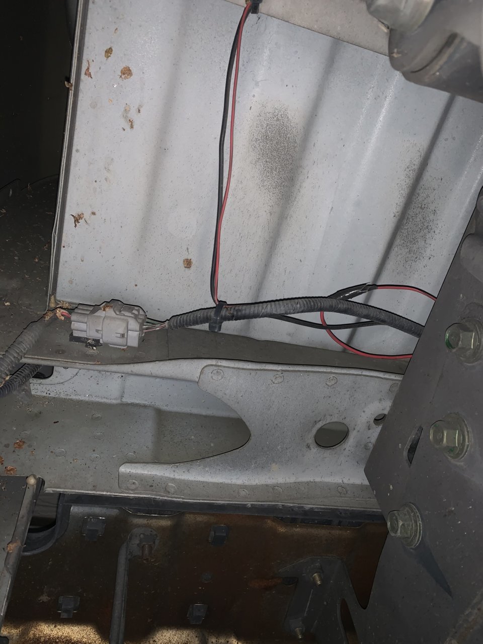

    I just looked at mine again to show you the steps and I took some pictures of wiring it up from the rear license plate but realized I can’t open my truck yet to show you were the parking and reverse wire from the radio splice in because I just primed my windshield pinch weld and have it taped up, but if I pull it off tomorrow I will take pictures and I can help if you have questions on what wire goes where. I have that exact head unit. 4573CA11-33FD-4EE1-9BC5-11B019FAA6AB.jpgDBA712B4-FE9A-4E35-B0A0-7EEA9413E99E.jpg

    A340 E&F

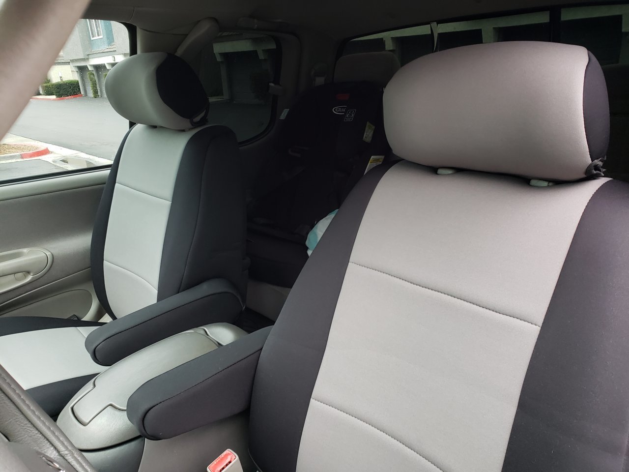

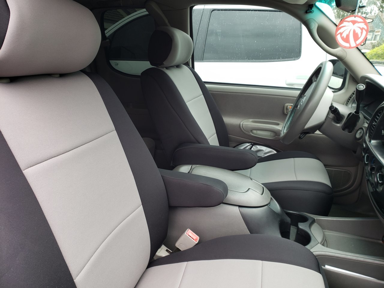

    Got my Cover Kings from AutoAnything installed today. Really happy with how they turned out. Went with the thicker neoprene version to get some more padding on the worn driver seat. They fit and feel great! :thumbsup:

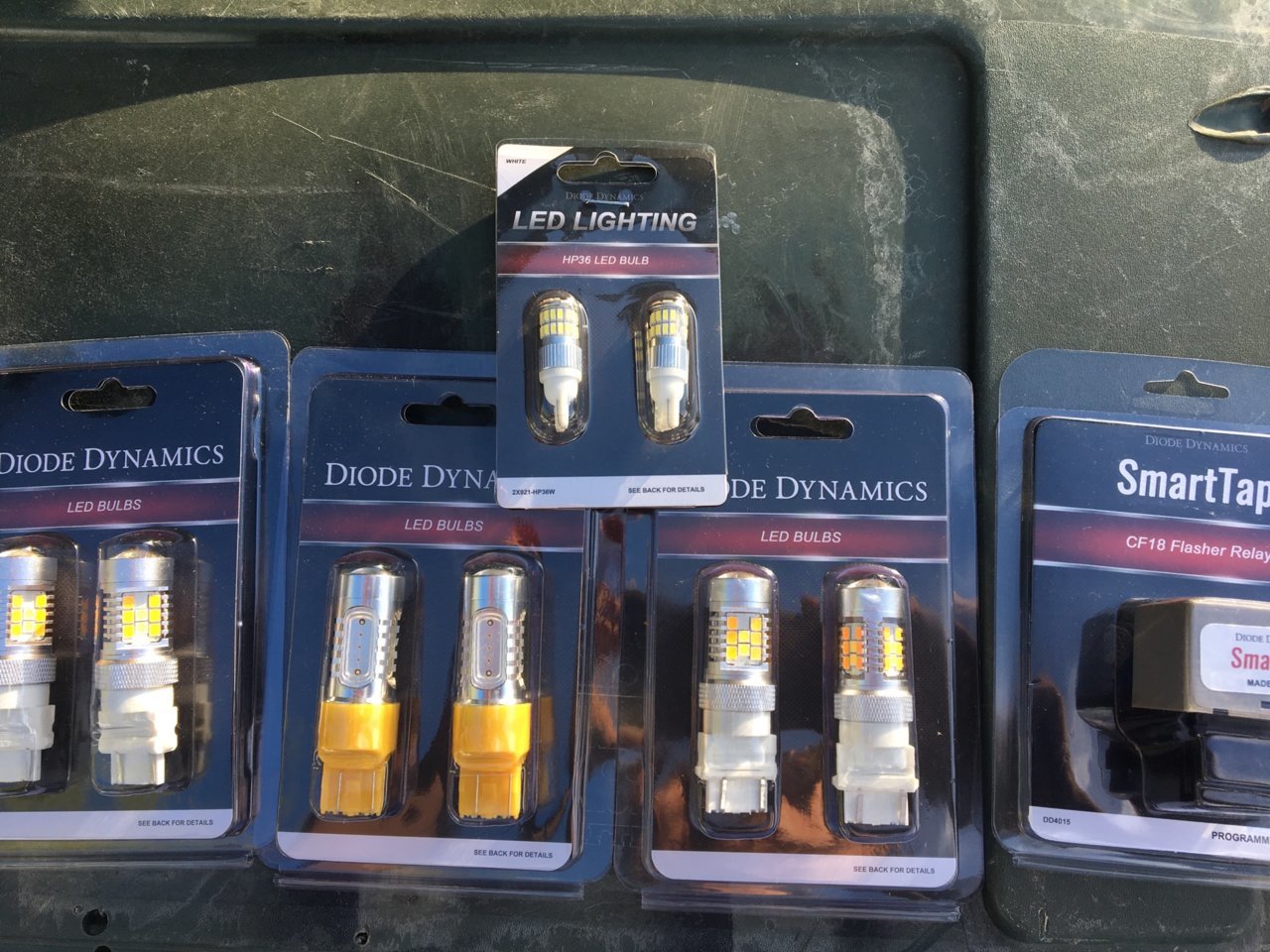

    Diode box came in! Front turn switch backs, cargo, rear turn, and the smart tap flasher relay!5453DE5F-9D10-447F-B08B-9567C0ACEA51.jpg

    I love the smart tap in my Avalon. Need to get one for the tundra.
    Still have to get leds for it come to think of it.

    Thanks for this. I’m wondering if ambient temperature has skewed my levels. Last I checked in the fall during the high ambient heat and the fluid level was in the hot range on the stick (engine running). Today was cold and its reading in the cold range. I don’t have these really cool gadgets to read my temps so I have to go by feel.
    I know for sure the engine was warmed up as she was idling for 10 minutes and the RPMS in park were 750 (settled into non choke idle status). I’ll mull things over tonight. Transmission is shifting really good so I’m not too worried about this.

    Don't know if you recall but after my fluid change few weeks ago I posted a pic of dipstick showing somewhere between cold/hot and was suggested to add a qt. So far I have not because I am mulling also because like yours, it's shifting really good. In fact, drove to Nashville yesterday and the whole way I was very impressed how sweet she sounds as the flowmasters hum....leaving well enough alone for now :)

    Tomorrow will be spent checking the fluid level dead cold ambient and working it from there.

    keeping in mind fluid expands when hot(up to temperature)

    Nice, looks great! Just got the same UCA's this week. Doing the same thing to mine along with new lowers and poly rack bushings. Also picked up some new OE leafs and Icon RXT add a leafs as well. Now just need some time to install it all.

    A340E is the Tacoma version iirc. right?

    No, E = 2wd. F= 4wd

    E is 2WD
    F is 4wd
  29. Dec 6, 2019 at 4:06 PM

    Don't do tacos sorry. This came out of 2003 FSM.....2003 TOYOTA TUNDRA (RM956U)
    E-2w
    F-4w
    edit.....you got your answers above, getting slow at my age :)
