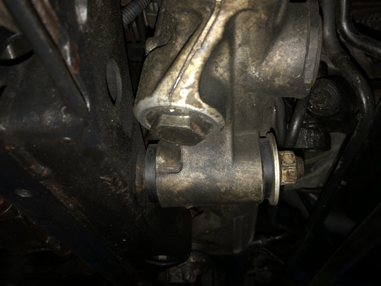

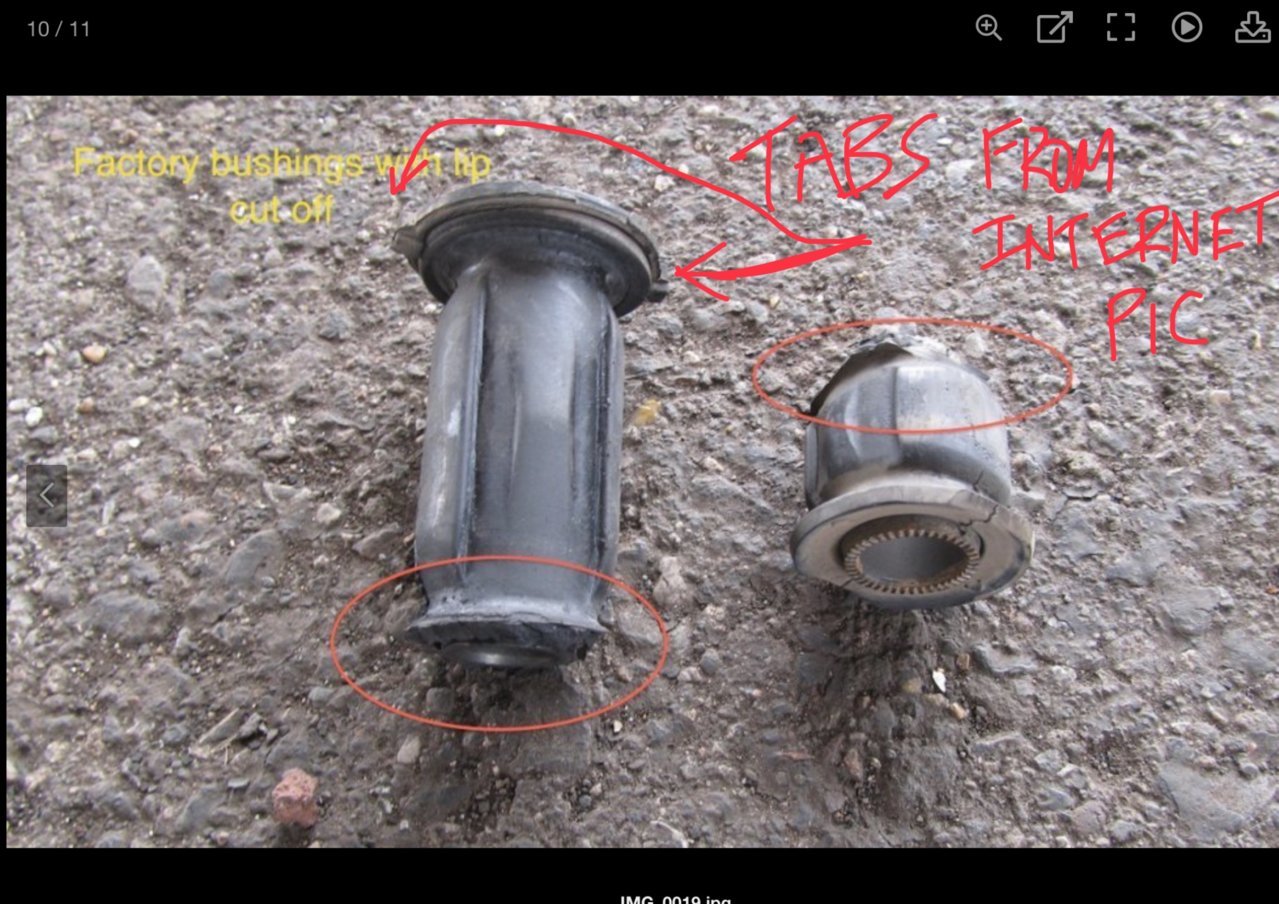

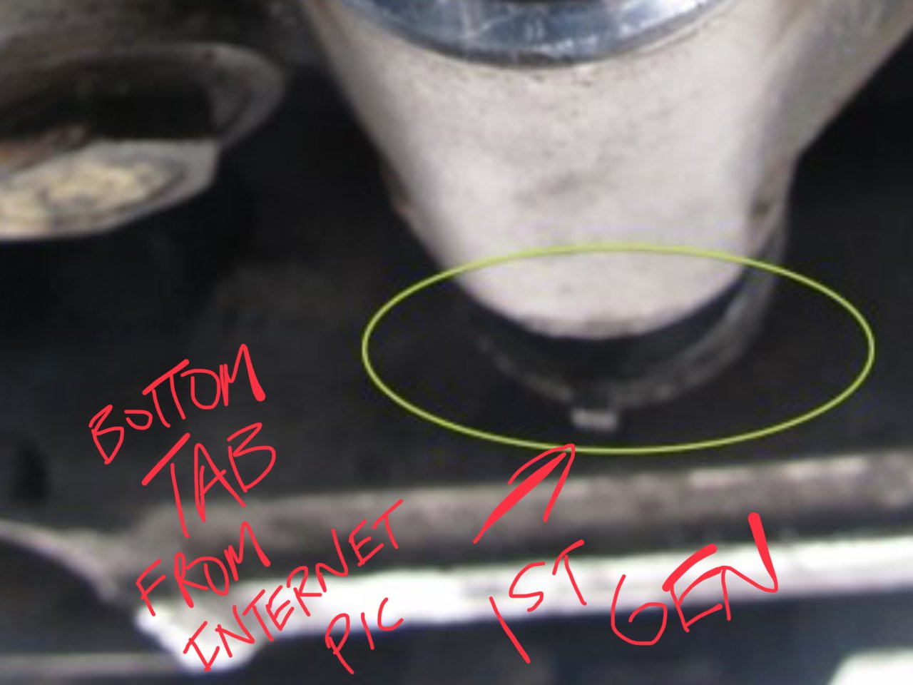

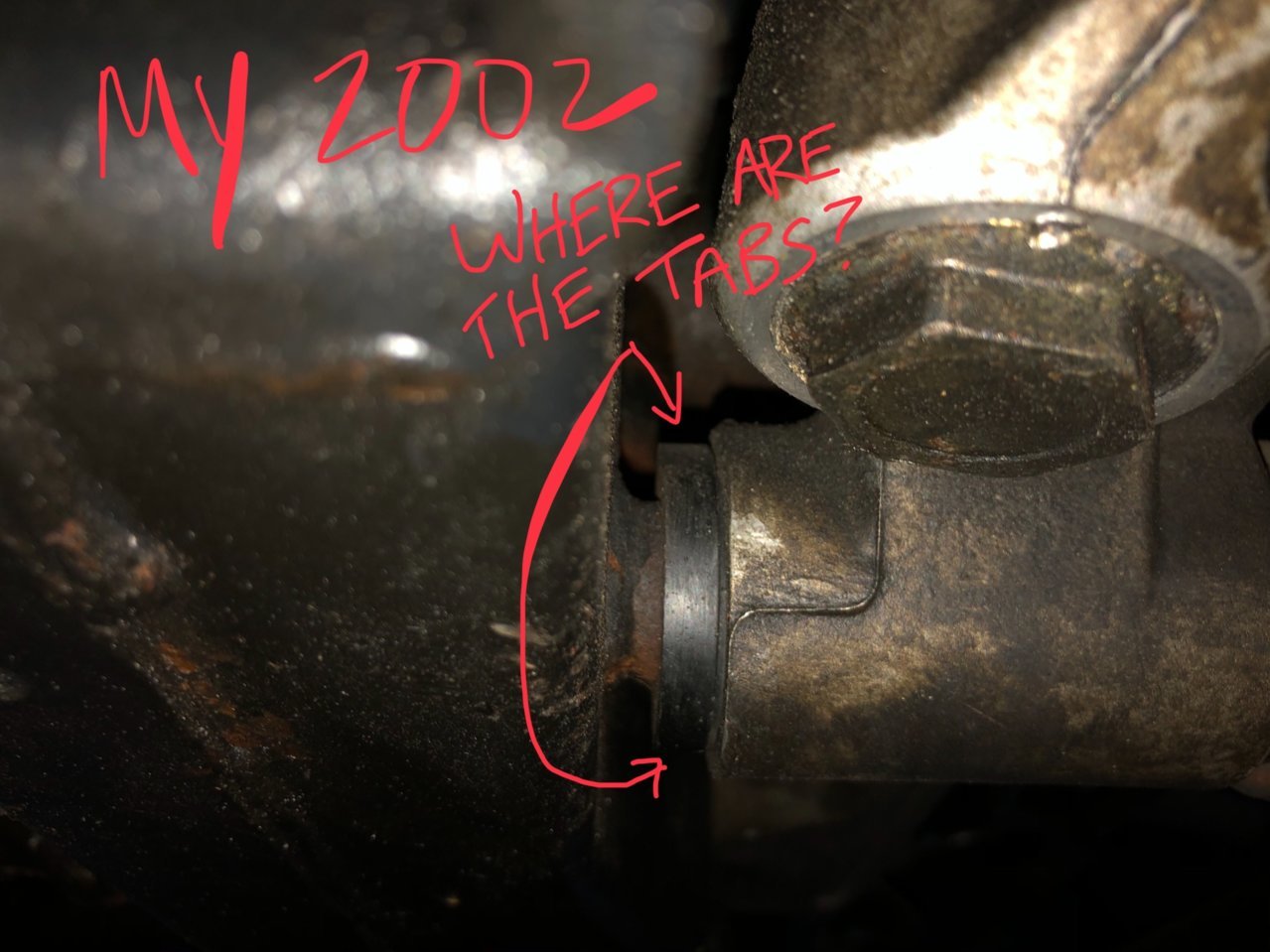

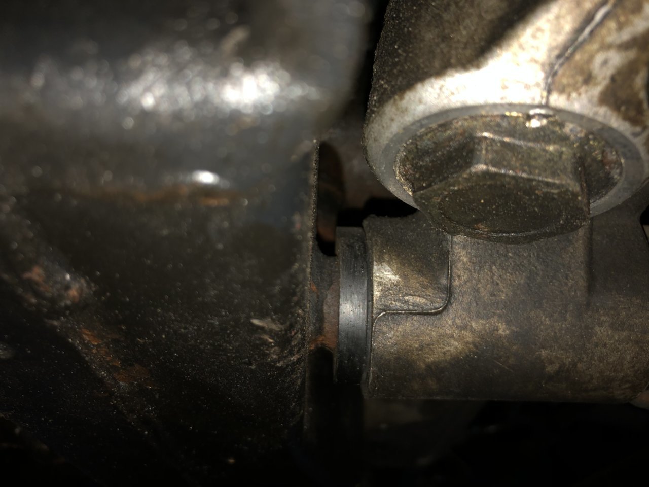

    Were my bushings replaced in the past? Not last year during front suspension work per the receipts. Maybe a long time ago and can’t remember?

    Use both washers. One between frame. One at factory location

    Maybe my set back today was for a reason? That drivers side nut also felt suspect. It twisted a tweak but I stopped because it felt like the nut was stuck and the bolt maybe was twisting to shear inside. I know this seized feeling. Might need to order some back up bolts just in case one breaks.
    A little easy everyone does it job turns into a big ordeal.

    Those are not factory bushings. The back washer is there to give the bushing a bigger surface area to hold. Otherwise you’ll just wear the bushing out faster

    You’ve confirmed my suspicion. I’ve no idea when or who did this bushing replace. Not a big deal, but nice to know. One more thing confirming I need to get the new ones on soon. Thank you.

    Has the rack ever been replaced?

    Not sure. My focus was on other things all these years until recently. Basically just keep new fluids in her on a timely basis.
    I do know both bellows leak ever so slightly. Never a drop on the ground, but just a wetness on the bellow. Rez levels always look good, too.
    Looking like the total rack/bushing deal should all be done at once versus Mickey Mousing around. I’ll wait till the rez empties out on me till I do the rack and bushing at this point. Too much work unless the truck tells me otherwise.

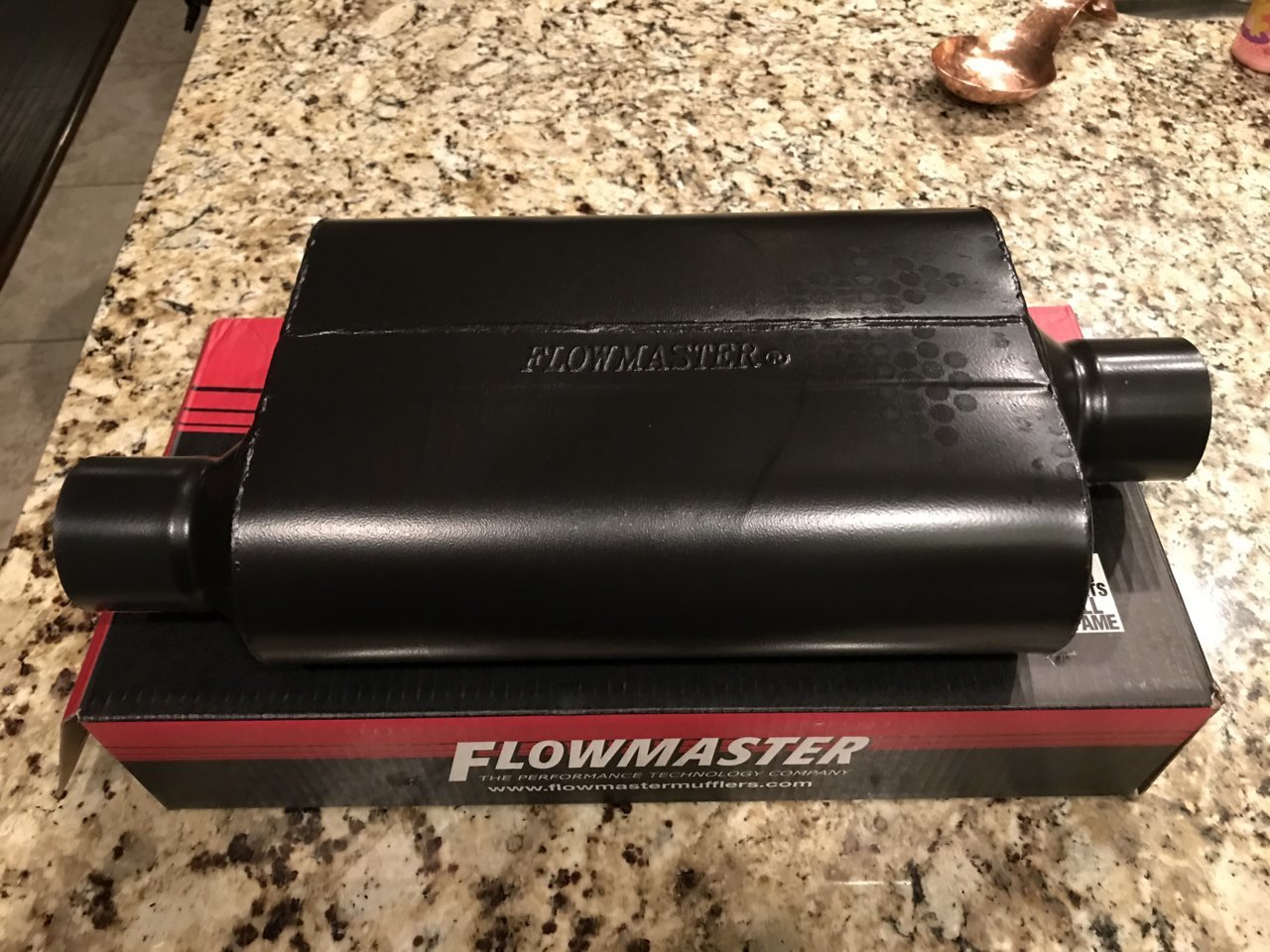

    Bulldog_tundra
    Bulldog_tundra New Member
    Jun 14, 2017
    #8138
    175
    USA
    2006 Double Cab
    Bilstein 5100 (Top Notch Front) 1” Rear Block Flowmaster 40 w/ 3” Tip Bumperplugs Front Plate Delete
    Chopped the resonator and muffler, left the stock tail pipe and ordered the wrong size inlet tip (2.25”, need 2.5”) ‍♂️ Went with an original 40 series to change things up.
    Ran true dual super 44’s on my ‘13 and loved them, ran a 14” magnapack on my ‘03 and it was a little muffled/fart-like at times, wasn’t a huge fan.
    So far so good with the 40, can finally hear the V8 on start up and idle, really liking the deep rumble.

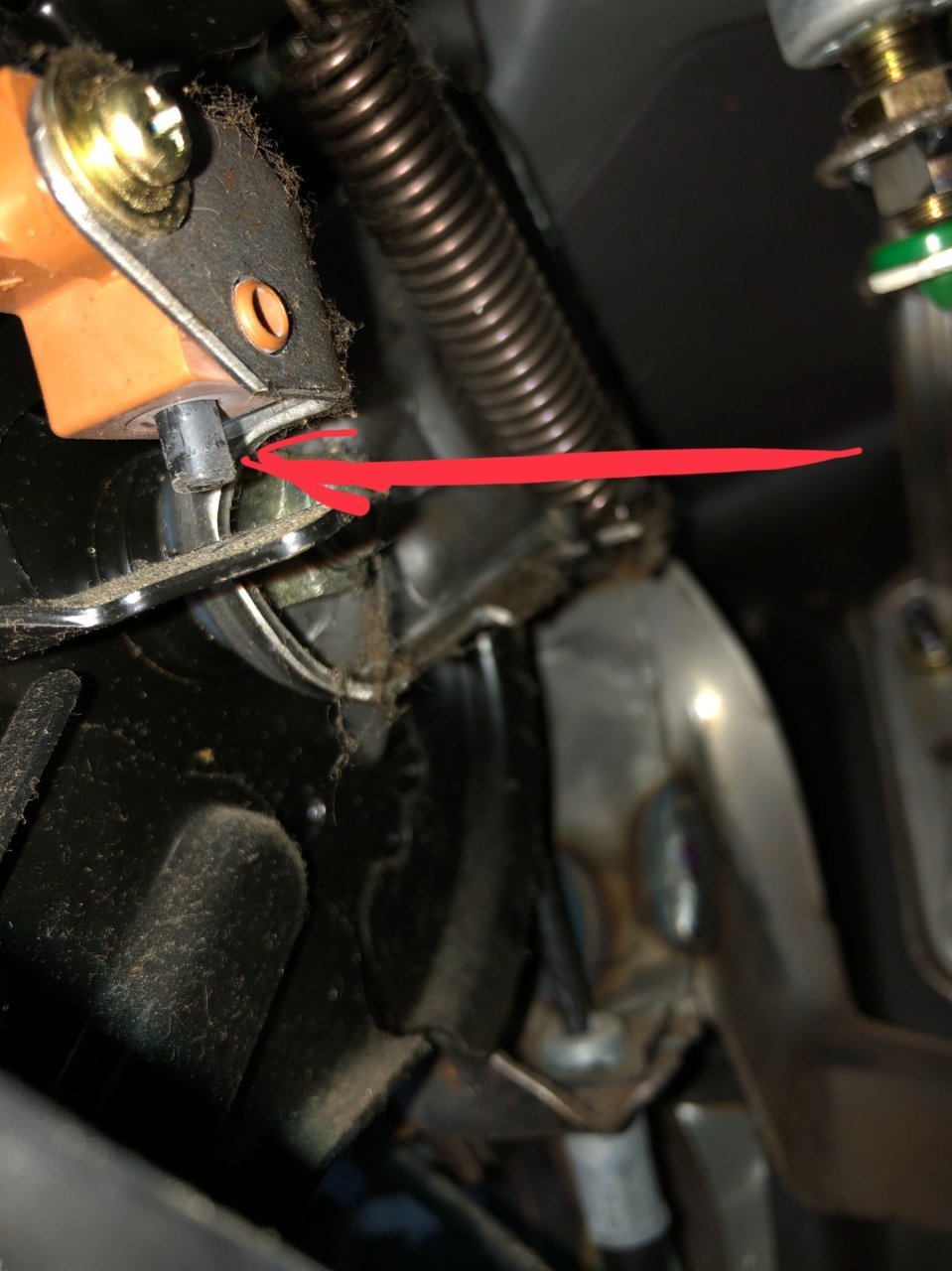

    Alternative Day Time Running light delete? This is located at the parking brake. Looks like one could simply unscrew the switch and flip it or tape off the plunger.

    Does this turn on your parking brake light on dash??

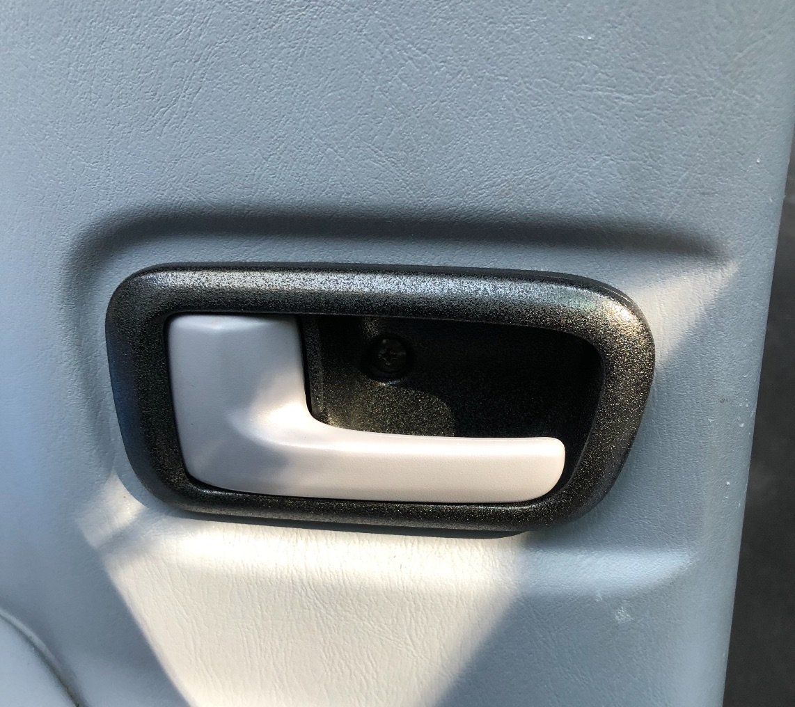

    Oiled up the steering rack bolts. Checked all fluids. Same boring stuff on a truck with no problems.
    Cracked both my front door handle cups removing the side panels for service work and sound insulation last year and decided to either buy new or fix them today. Experimented with the back cups and spray painted them with bed liner to give some contrast to all the ‘Moon Mist’.
    Front handles are getting fixed up with some adhesive now. Looks like I’ll be spraying them along with my exterior trim tomorrow or Friday.

    Yes it is. I love the finish on it. Self priming and sticks very well especially to plastic. Quick drying and easy to use. Might end up doing a few other accents in the cab with it, as well.
