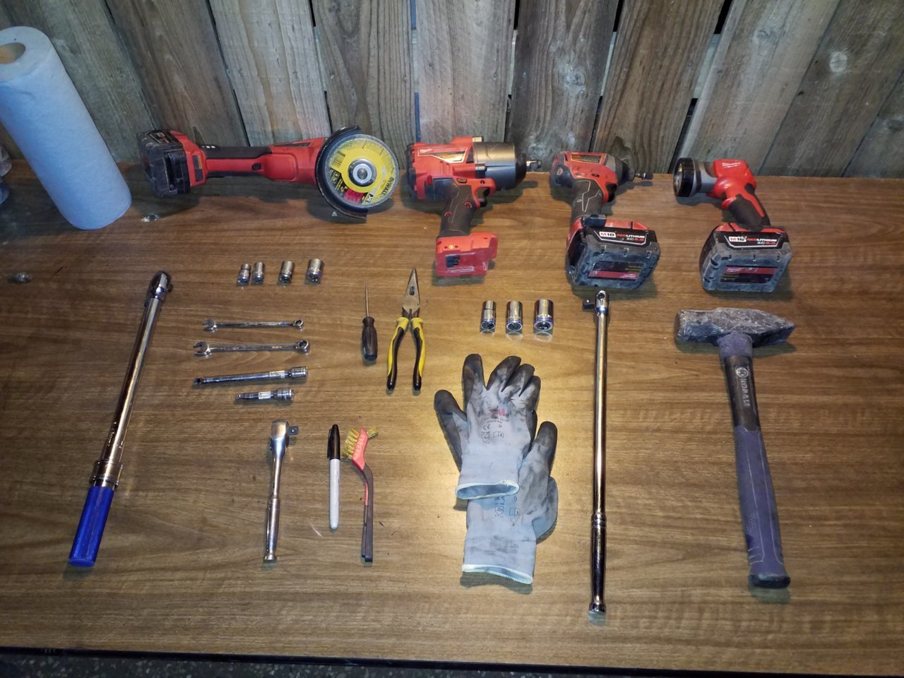

    I tried it all bud. You saw the arsenal of tools. Breakers with extensions plus 1” pipe extension on that. Seized!

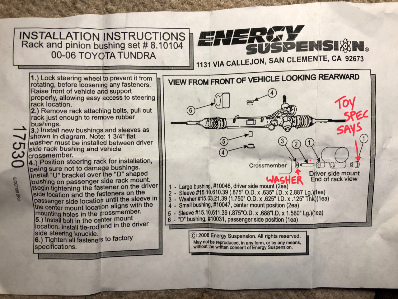

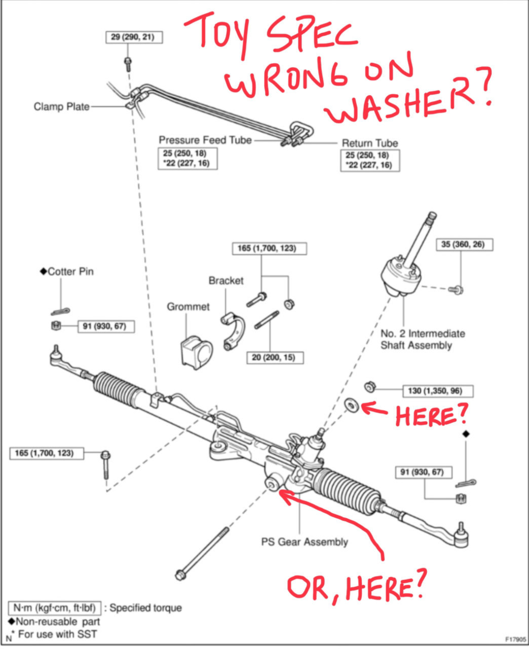

    Need some analysis on the washer location. Toy says put it under the nut as the drawing/spec. Energy Suspension says put washer between cross member and back of steering rack. Am I reading this wrong?
    Is the difference because of Energy Suspensions design? Read somewhere Toy spec’d the washer wrongly, but have no access to Top Secret files to confirm.

    The one in the key goes between the frame and bushing. The oem
    But then goes on the other side of the bushing. The oem bushing has a built in washer on the frame side
    Can kind of see it here (01 Tacoma, busy same setup)

    So what I’m hearing you say is the Toy diagram is correct.
    Also, the Energy Suspension instructions are correct.
    1) Follow Energy Suspension directions. Toss the OEM washer as one is not needed there now with the new bushing design.
    OR
    2) Save and re-use OEM washer and reinstall it at its original location along with the new kit AND the new washer goes in the new location between cross member, as well.
    Please confirm. Thank you.

    Here is how mine looks now. @empty_lord
    Looks like a washer is missing on the backside compared to your picture.

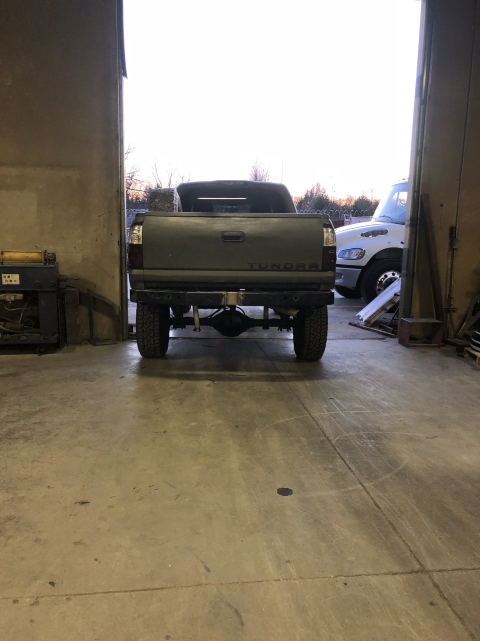

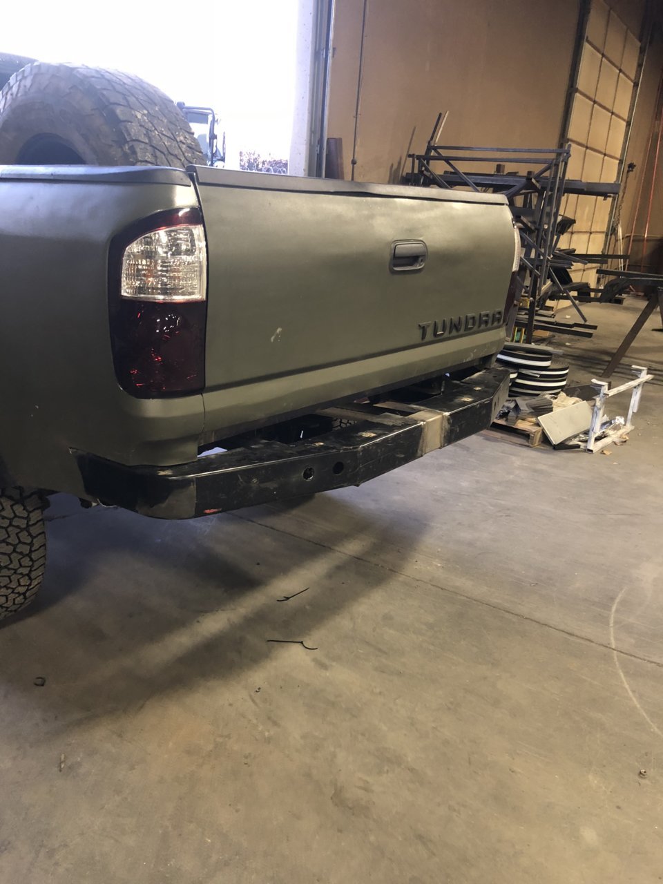

    A0EBD81A-F917-4492-A70F-5D93013A5C65.jpg AD815218-F8FD-4272-9881-B59F65C90724.jpg Started building a rear winch bumper from and old Land Rover front bumper.

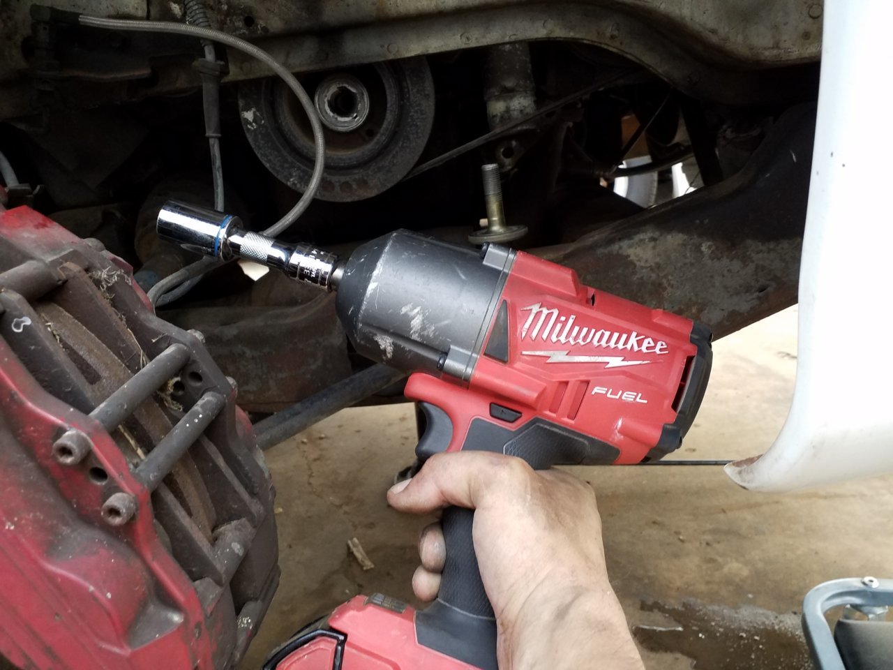

    I'm not sure you can get an impact in there. I am sure I wouldnt heat that up, too odd of a spot. The only way i could get it was a good sized wrench and some swivel adapters on a socket to break it loose. From there I used a regular socket and did the annoying 1/4 turn at a time.

    Thank you for this. As I’m machinating through it all, I was wondering if that impact drill would fit for that top d-bolt.
    I barely had room for an 18” breaker with a 6” ext. connected to a deep socket impact 19mm. Lots going on right there.
    I didn’t do the heat/torch due to the rubber power steering hoses being direct above and there is no other angle to torch other than from the top side (possible but did not try yet). Figured I’d button it up and regroup like I did with the 12 hole injectors install. Remember that one took me 2 tries? First was my probe attack. Second try was a victory.
    Main thing is nothing is messed up. I’ll soak this d-ring over the next few weeks. Crawl under and keep wrenching/tapping it a few times until it gives. Funny thing going into this job I thought the center bolt would be the bear to get out so I started there first. It was tight, but I made it happen. Figured it was downhill from there and then I hit the d-ring wall. Almost 20 years of seize on it.
    Maybe give Kroil a try per @FirstGenVol

    Wait I'm a little medicated. The d ring bolt you can use an impact on, I thought the center was what didnt work.
    I'm having a hard time remembering but I think one of those d ring bolts has a welded nut inside the frame, the other has a bolt poking through and you have to hold that while you spin the nut off. It could be the other way around though. I would be careful to examine if the stuck one has a welded counterpart, you dont want to break a welded fastener in that area.
