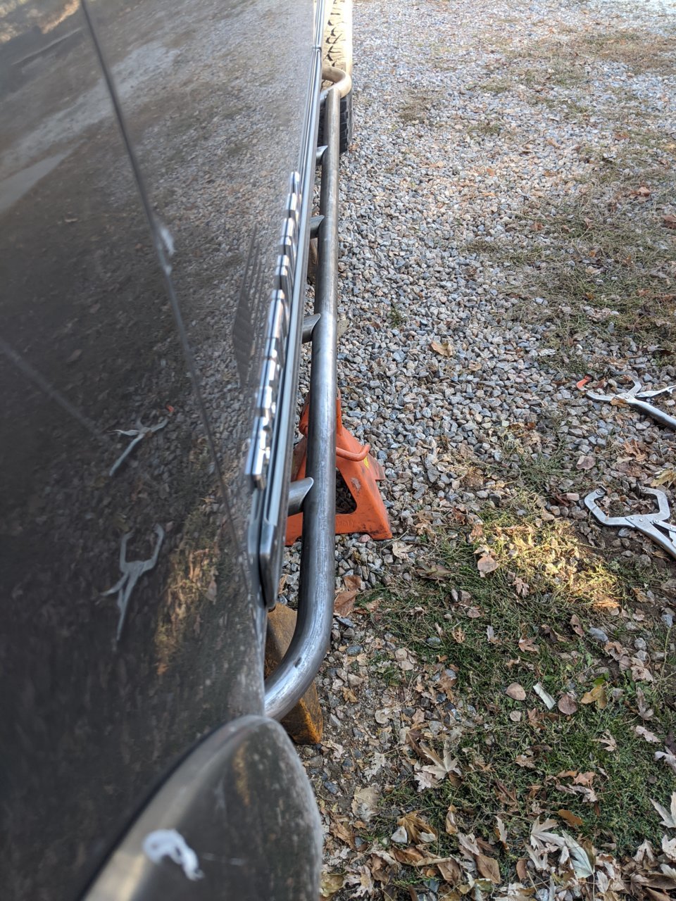

    I would think you would want to have them out as far as the outside of your rear tire rim. I guess you are using kick outs to cover the rear wheels, but wouldn't you want them wider to protect the side of the truck as well - assuming a 'sheer rock wall' at some point in your off-roading life?

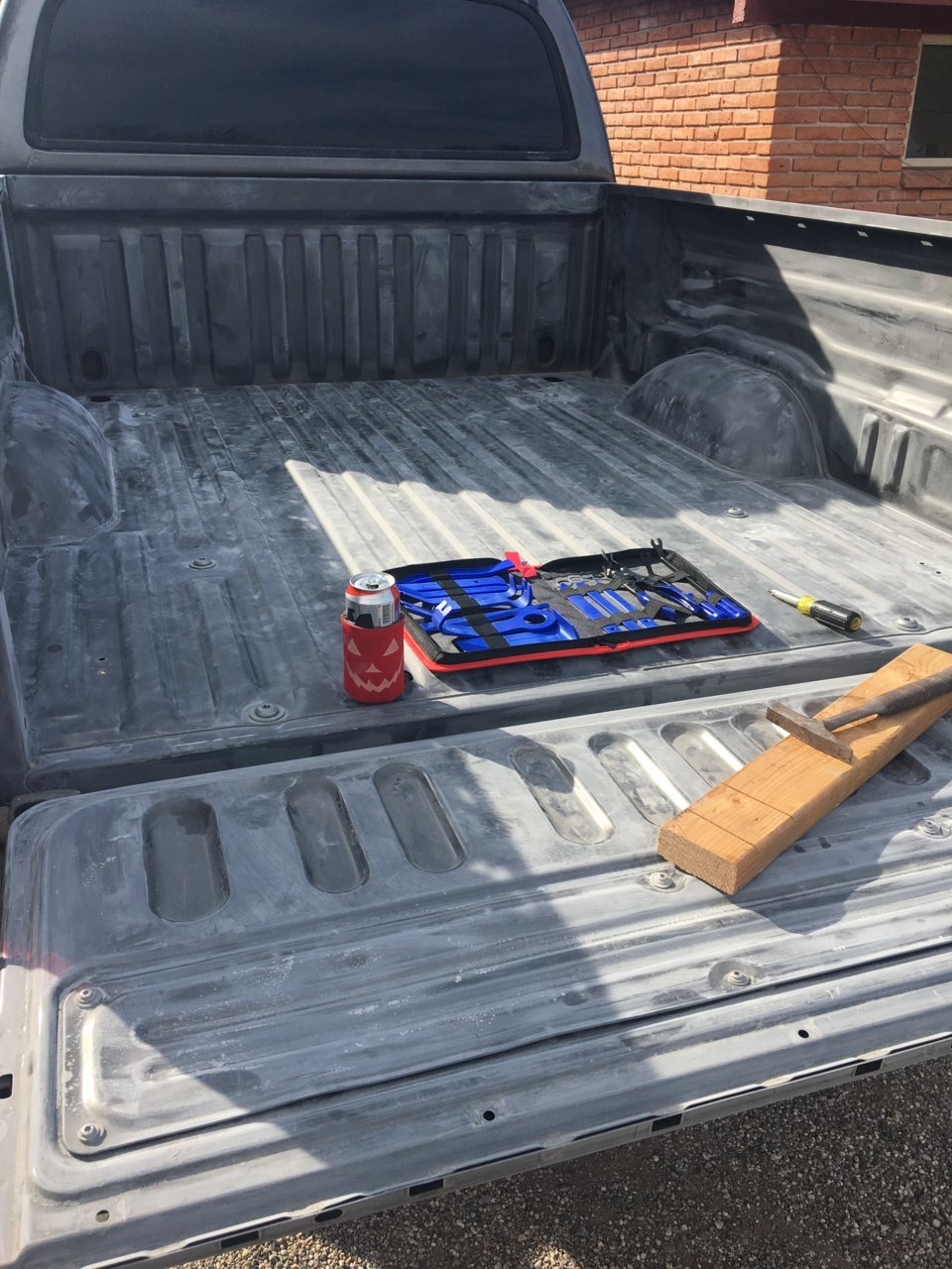

    1st Gen Tundra Tail Gate Assist Success!
    Should work on any truck, as well.
    All measuring is up to you. Pictures should be self explanatory to get the ball rolling. Hardest part was the ‘Hansel Move’ reaching through the gate hole to install the washer and nut. The double sided tape helps hold the washers temporarily until you can thread the nuts.
    In retrospect, I’d try to move the upper strut stud hinge plate (mounted on vertical truck bed frame) UPWARDS about an inch based on post installation quarterbacking/guessing. Works great as is and it would be too much work to relocate and not sure if the moving up would make (a little) better action?
    Speaking of action: The gate falls its normal unassisted speed from vertical to about 2/3 down which, at that point, is when the designed assist strut action kicks in. Brings the last 1/3 of the gate fall opening to a very soft landing. Closing the gate is normal until the last 1-2” of latching where you can feel the strut give slight resistance as it resets the chamber. Doesn’t easily latch closed like before, but needs a slight push to fully engage the latch/lock points.
    Lots of weighed forces on the tailgate falling action, so I added 2 more bolts with underlying fender washers (for 5 total) in the above picture. The washers are very important to distribute the weight forces better back up towards the mounting bracket.
    Took about 2.5 hours on this first prototype. Could do it in less than an hour next time.
    Total parts under $40

    I brainstormed hard on this one last year. Your posting pics restarted the fire. I already knew it wasn’t feasible on the inside (between gate and bed) as designed from prior research. Finding those strut studs I posted is the key to this job. The Simpson strong tie angle is key as well. Figured I had all the homework complete and it was time to take the test.
    Hope it helps everyone. Really is a nice ‘mod’.

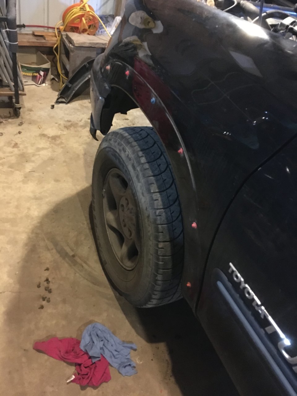

    Got the first flare off and found....
    NOTHING! NO RUST!

    now, does anyone know how to remove a headlight? I can’t get it off for the life of me.

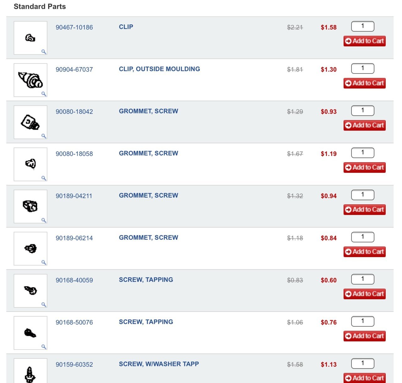

    I a related question, anyone know a part number for those little clips for the flares. One is broken on my rear flare and pops off all the time.

    Try these for starters.

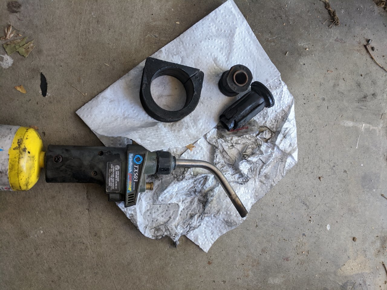

    Some new poly bushings for the rack

    Hows the new steering feel?

    Like a virgin

    There are a few bolts to pull out, also look at the corner markers and remove any bolts there. You have to pull the corner marker straight forward and really he-man that thing out. Then the headlight can come out.

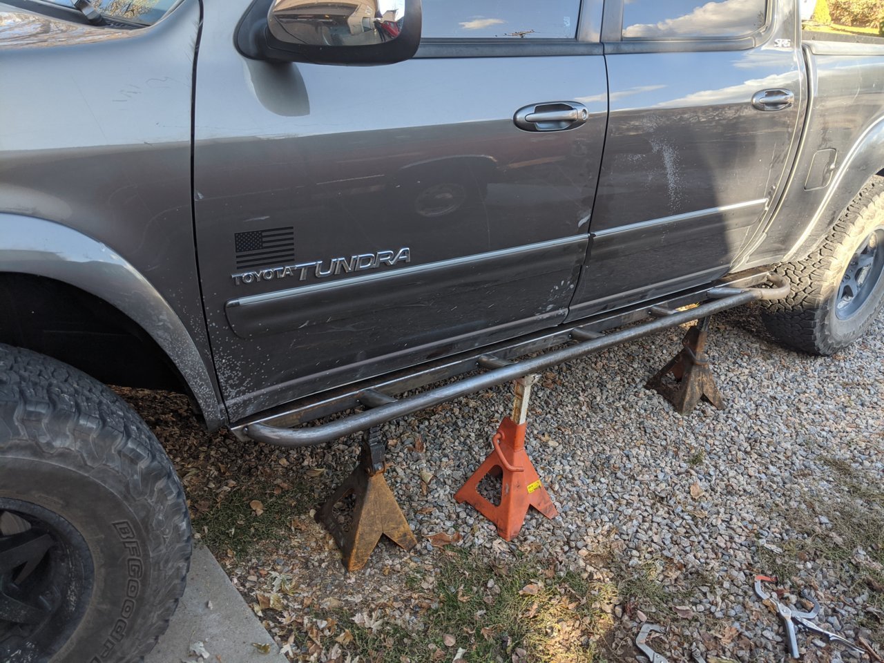

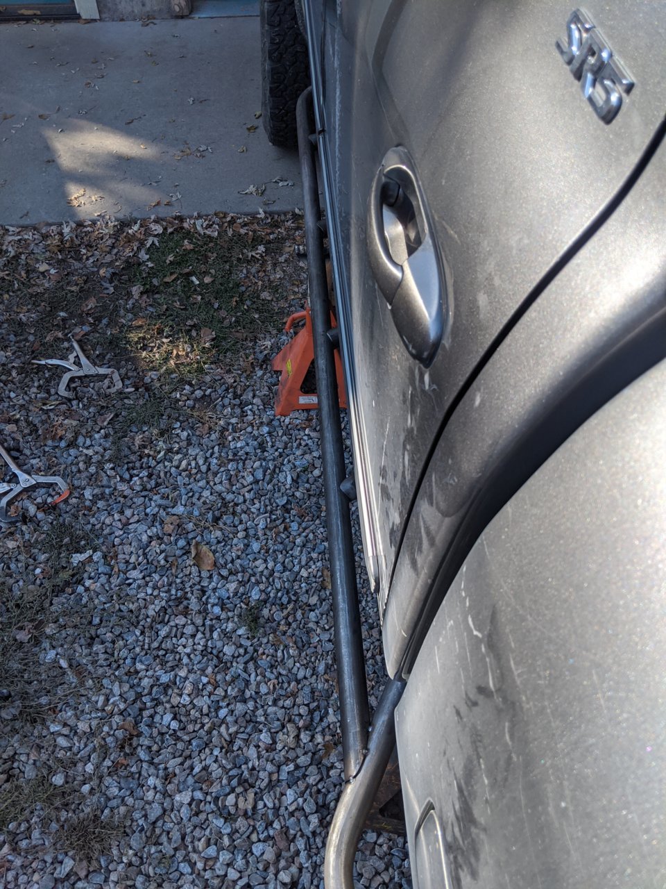

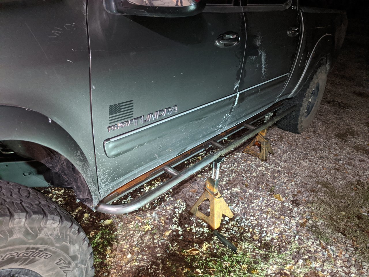

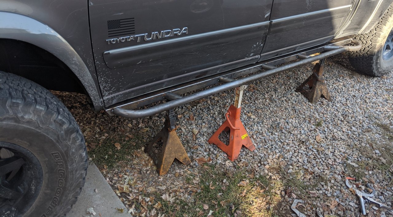

    Hard to top hand model today. He took something difficult and made it look almost easy. I took something fairly difficult and decided to make it harder because I like pain... Obviously!

    gosh I'm tempted to do this myself at my buddies who has a welder. How much in materials...couple hundo?

    That would require I actually think about the final cost of something. I like piecing it together and not adding it up. Here goes ..
    Maybe $80 for 20' of 2" square tube
    The 6-8' of 1.5" square was remnant so I have no idea
    So far about $50 in 1/4" and 3/16" steel plate
    The about 20' of 1.75" DOM is around $150
    So maybe $300 with some bolts and drill bits and such. You could easily make them less expensive by using different materials, making them weld on, or being able to order with a good discount. My work doesn't do much quantity on steel so I got some better deals than what I posted, but not by a whole lot.
