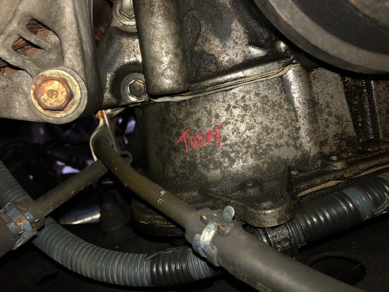

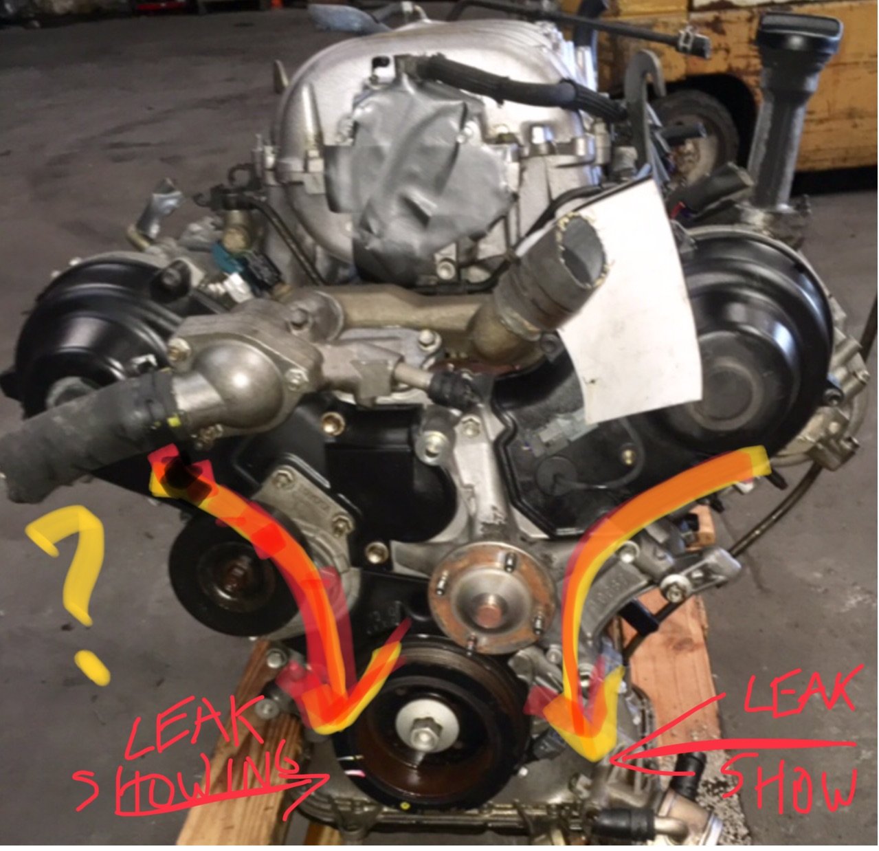

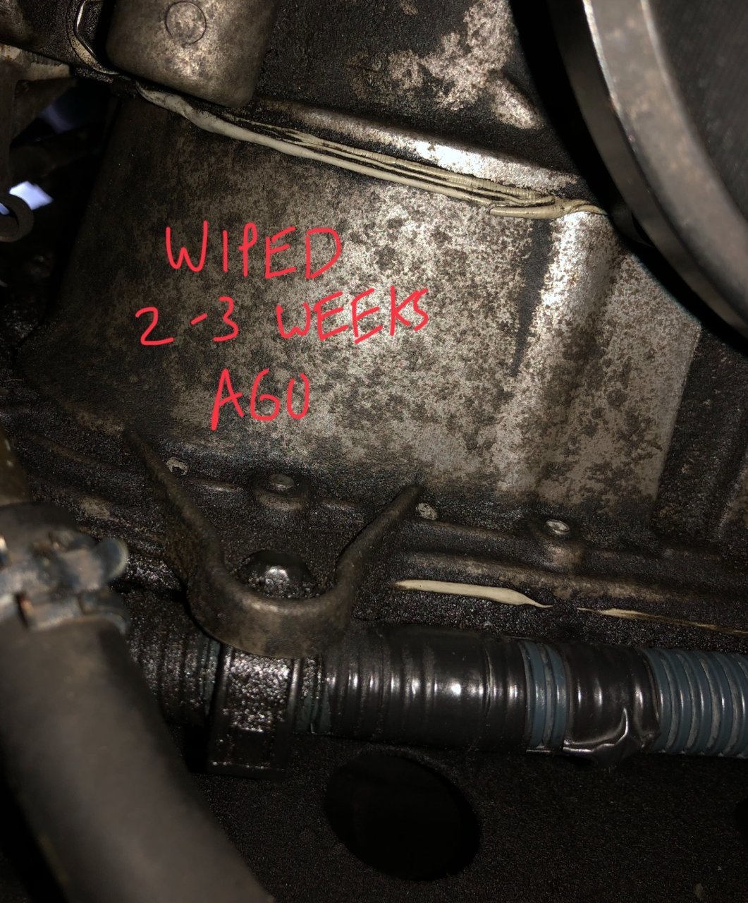

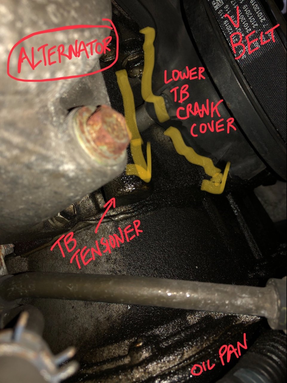

    Confirmed the 02’ has an ongoing cam(s) seal leaks. Looks to have been going on for years due to the long time clogged PCV blowing them both out.
    The Mobil 1 Synthetic High Mileage has really swelled the gaskets around the engine block etc, but the cam seals not so.
    Not sure to let this one go or tackle it as the leak looks to be trailing down inside the Timing Belt cover. @empty_lord Whats the call? Fix or let it be?

    Wait till your next belt change. But keep an eye on it. And keep it clean
    It’s likely just seep that’s been going on for years

    Thanks. This was my thinking when I asked you last week about the cam replace tutorial. You mentioned you had one and didn’t seem like a biggie to you. I’ll monitor it. I wiped off that area a few weeks ago and took some pics. Looked and took some pics today and there is some weeps glaze.

    Yea as long as your not noticing it on the dipstick it’s not worth tearing the whole front end apart to replace it. Granted your cam seals are 10x easier than mine

    Thanks. Dipstick has never seen a noticeable drop in level since the last few oil changes. Never any drops on the driveway. I’ll continue to monitor.
    Next Timing Belt change is due in 50k more miles which equates to about 6 years of driving for me. This truck comes back up on its reinvestment reassessment to keep it in another 4 years. By then, I might be working for Toyota as a technician.
