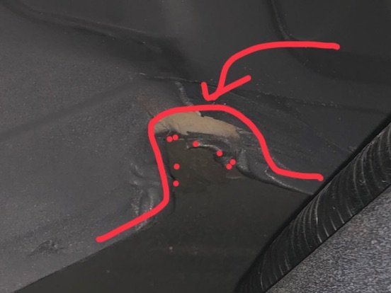

    [​IMG]So uh this is a straight cab.
    [​IMG]This is mine...
    See the problem? We thought it was factory shaped like that... but as I’m
    Finding out driving it, the cab seam is separating now.. this will be fun to fix.

    Seam separation. The cause for concern

    Construction adhesive or seam sealer and then some undercoat. Maybe some rivets and hammering and not exactly in that order. That's probably what I'd do.

    I’m going to see if I can pull the thing straight with my enerpac from the floor pan. Seems to be where the damage took place
    By the body mount

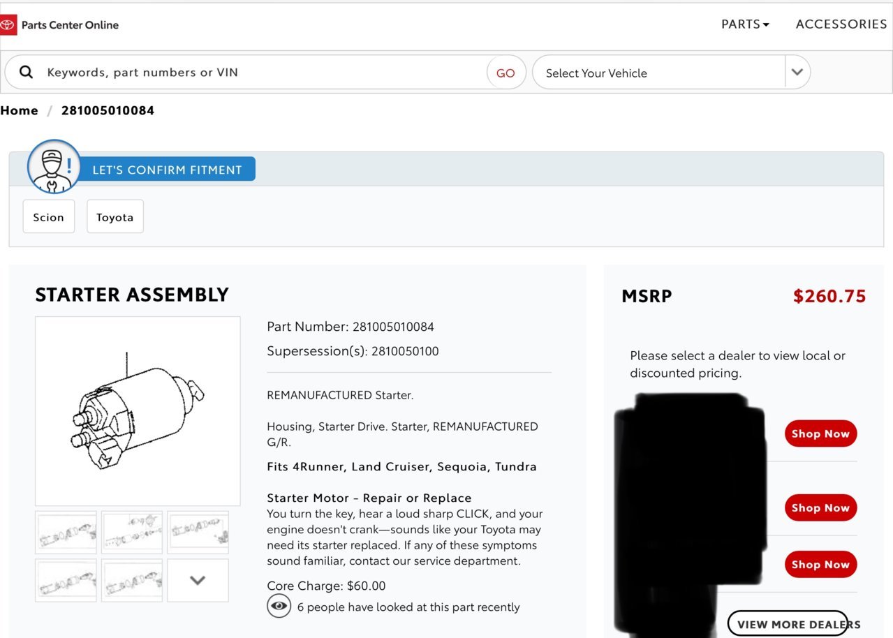

    Nice. My one mechanic likes NAPA.
    I’ve strongly considered this remanufactured starter which the stealerships offer. Or, you can buy a new one from online stores for about the same price.

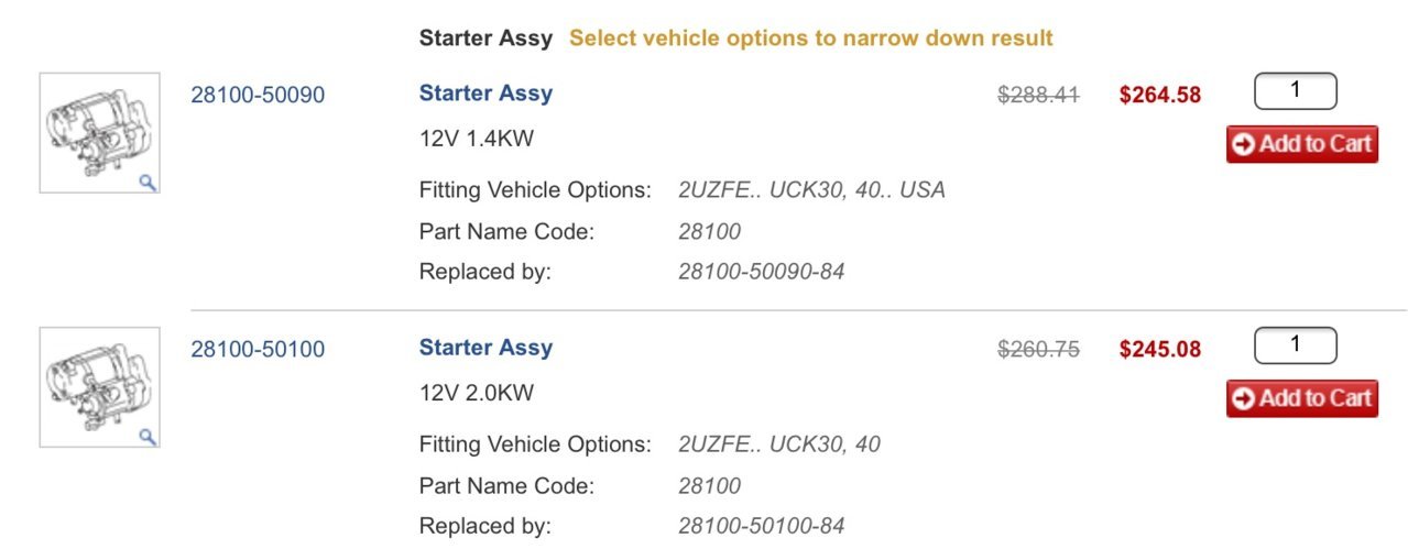

    It was on my window sticker and you should be able to pull it up on your VIN search.
    Ironically, the HD is less expensive brand new compared to the lighter duty new.
    Not sure what makes it HD other than more power (2 vs 1.4kw) juicing the mice.
