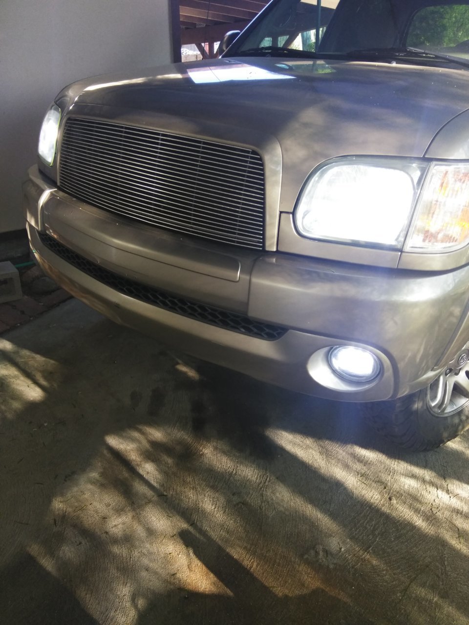

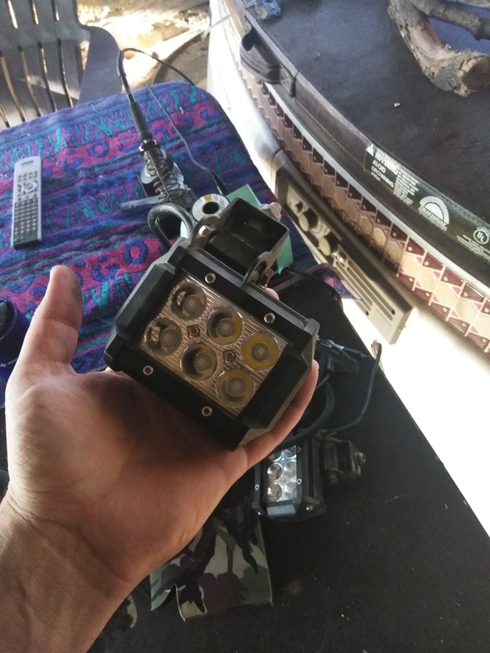

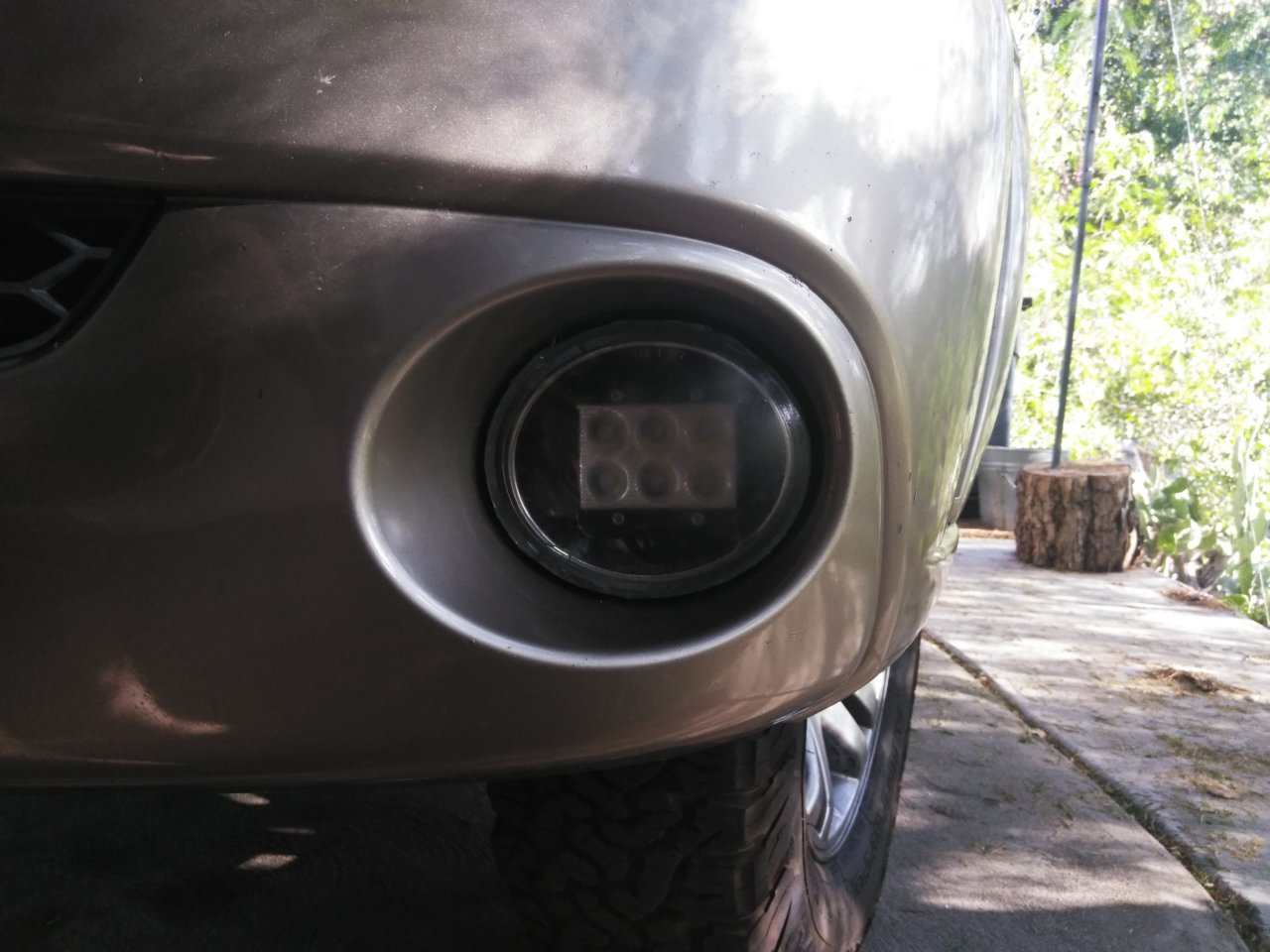

    Today I stuffed some led pods into my fog lights.
    Wired them to the normal fog light bulb. I just removed the glass buld and soldered the led pod to the 9006 connector part of the light bulb. That way I don't have to cut my wires on my truck. Had to take apart the foglight assembly and stuff the square led into the round fog light assembly. Lol
    Sealed everything up. Looks good .I'll post a night picture in a few hours.

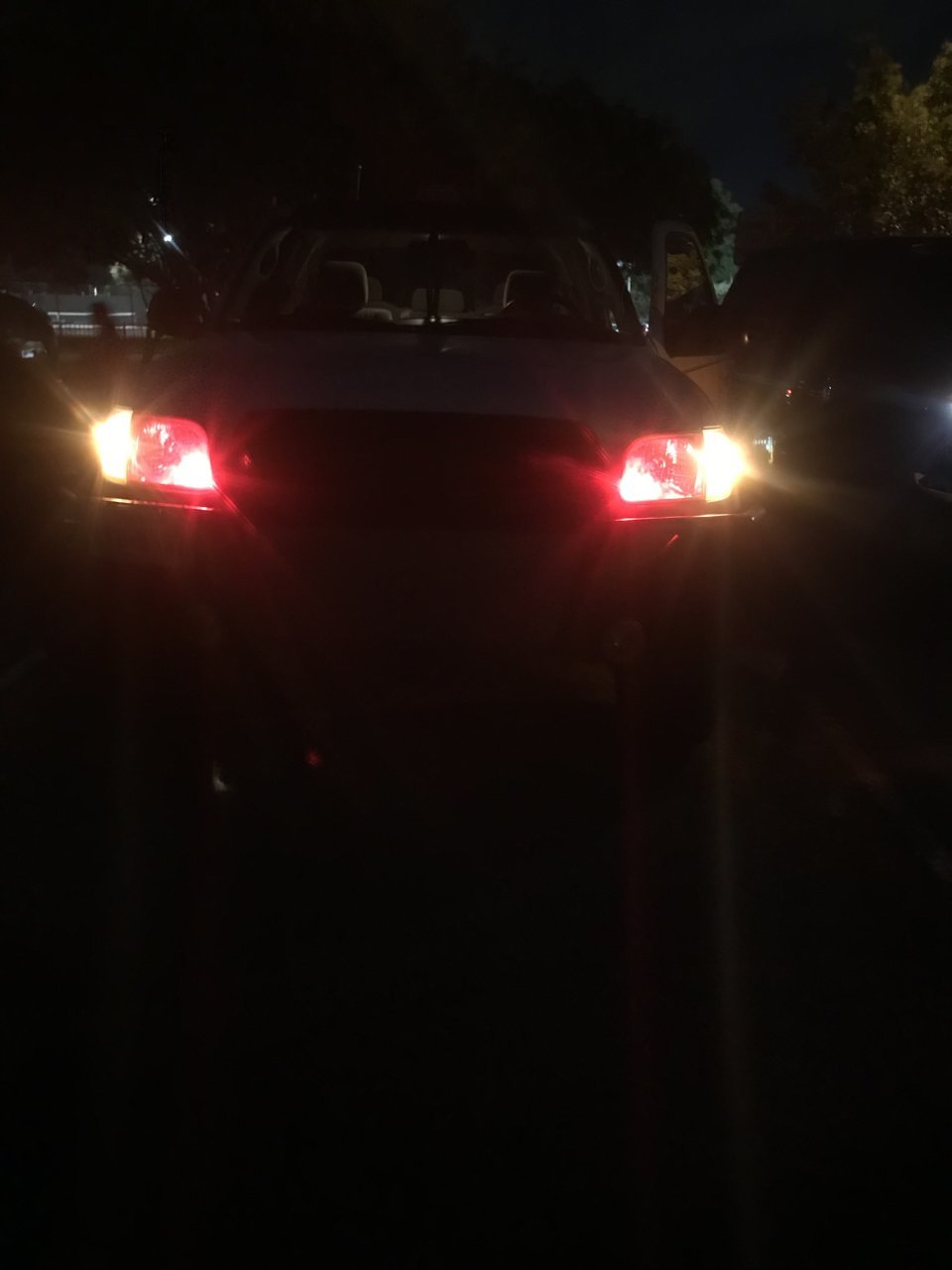

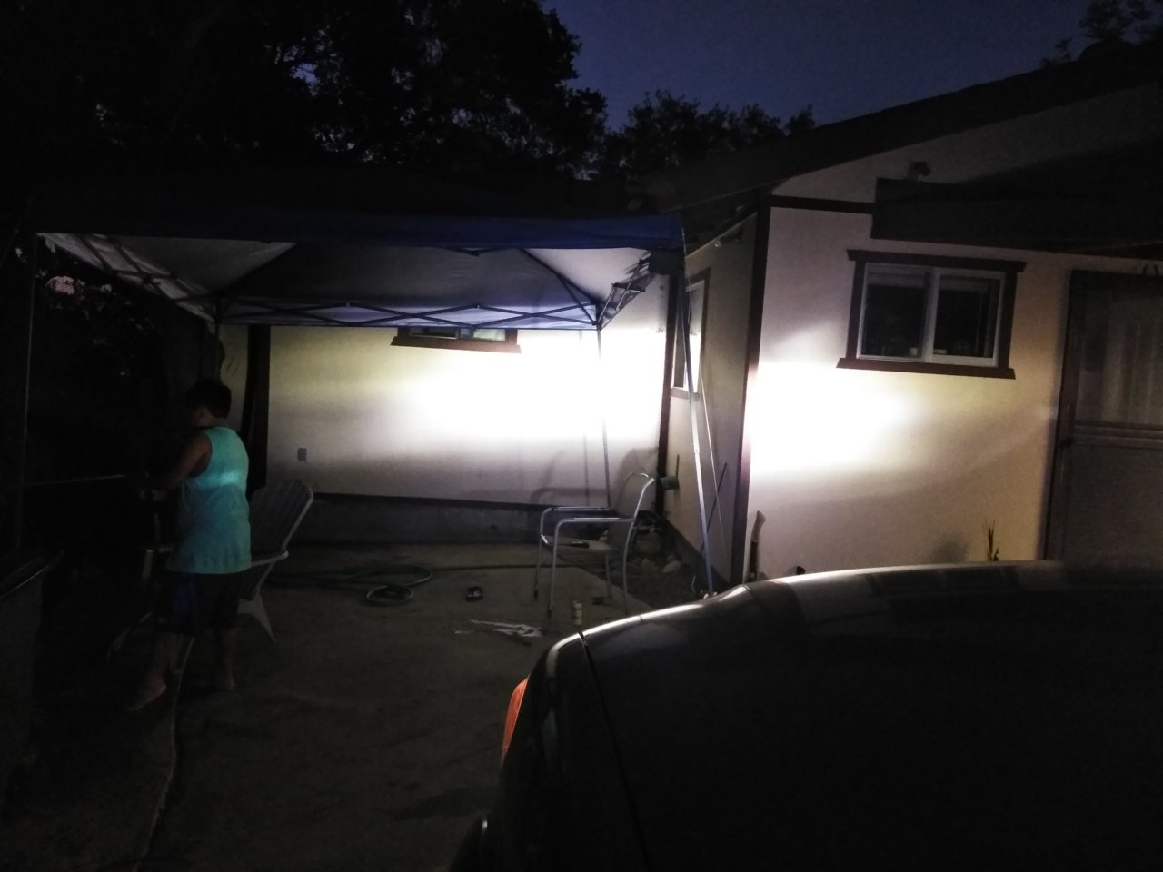

    Night shots. Shitty driveway shots
    First pic .Led headlights
    Second pic. Led headlights and fogs.

    Looks a bit high. I'm in San Diego tonight and happy that the warm humidity just left.
    Interested to see how you connected that.

    My driveway is up hill.
    I'll try to get a decent level shot at night

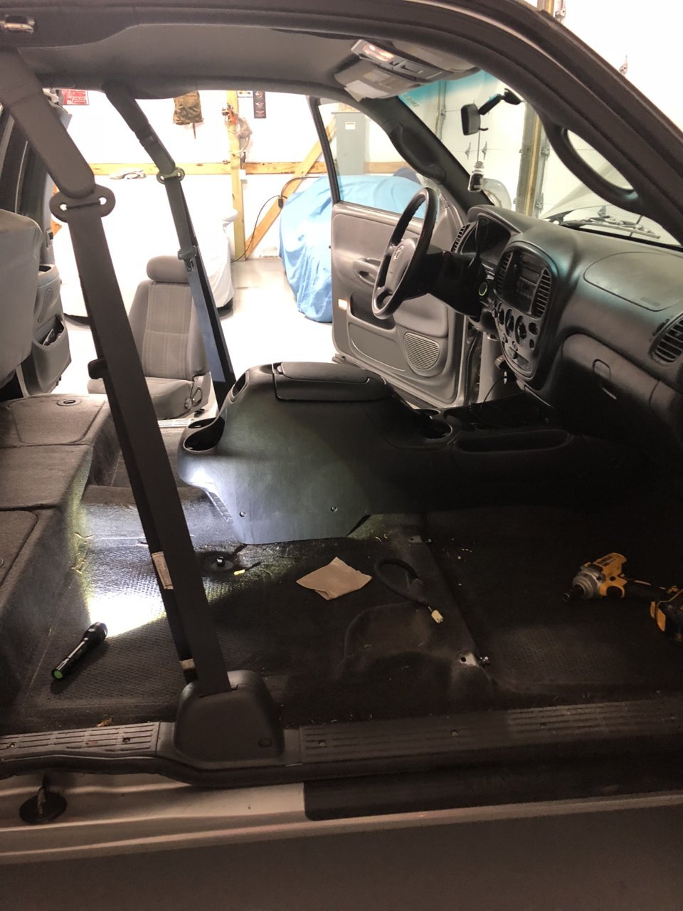

    Just pulled all the seats out gonna shampoo the carpets

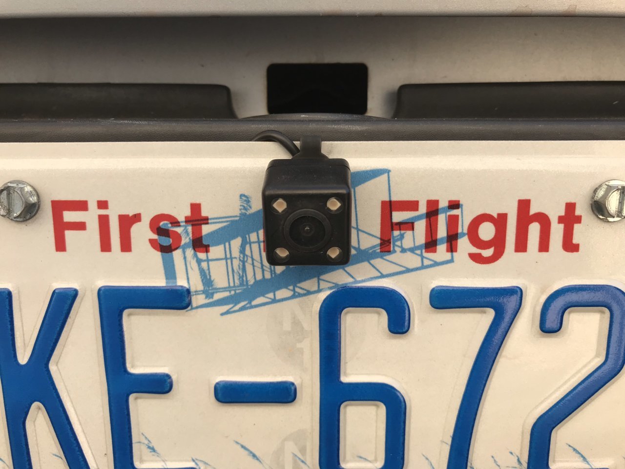

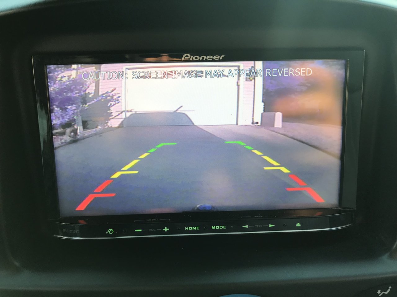

    I installed a backup camera in my truck going to an older pioneer double din. It works great no problems and the look on someone's face when I back right to the trailer perfect every time makes it worth it. I will grab some pictures today.

    gavin g83
    How was the install, which did you use.
    I am about to order.
    Wanted to know what you used, i am gonna go with new double din head unit and backup camera

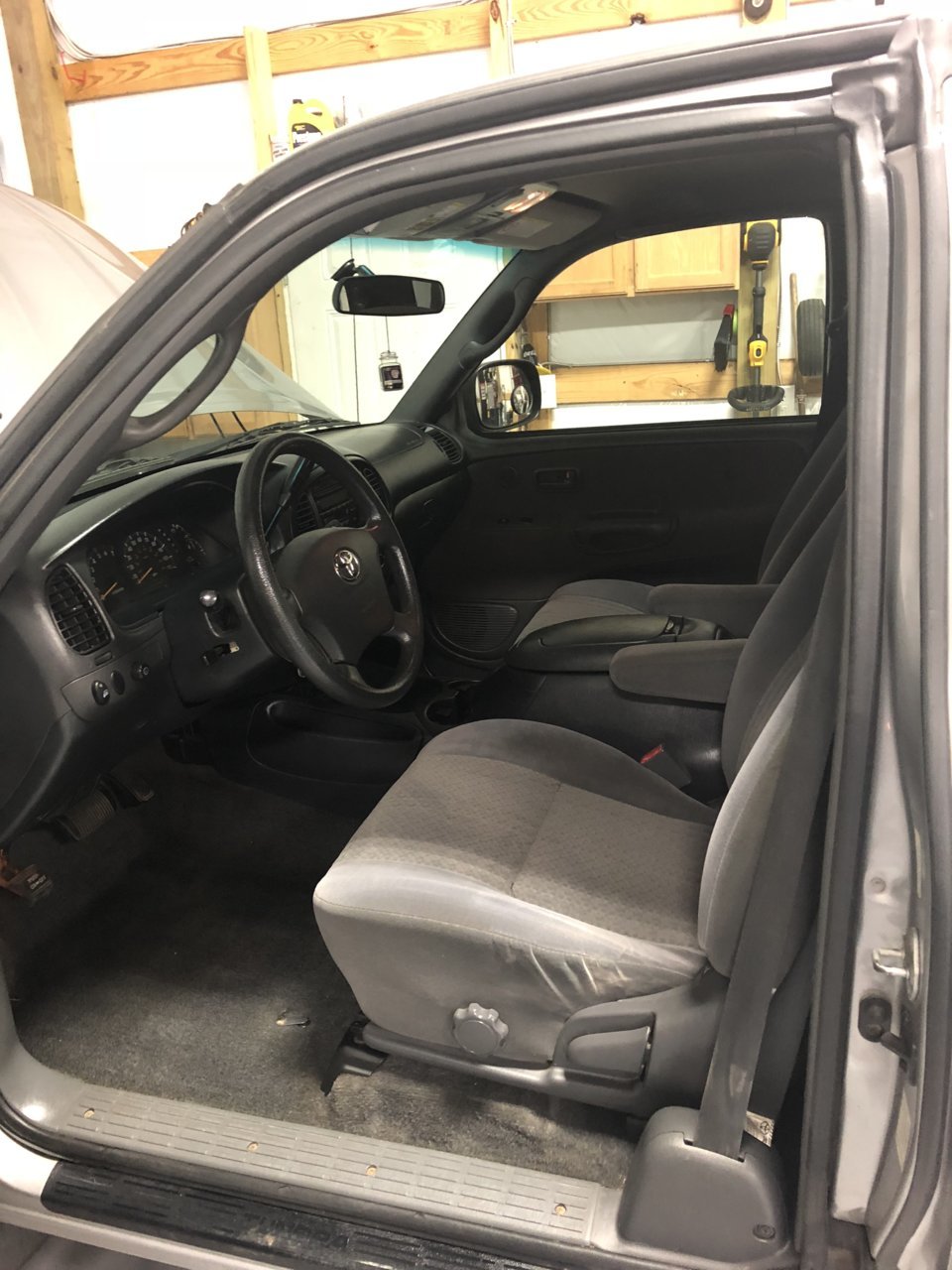

    CD76CC55-9CD2-41C0-8AED-B1D8FD66111B.jpg That was before and here is after.
    It amazes me how this makes a car smell so much better!6CD980BF-D6D2-4BBF-8EBE-9FDC43275743.jpg

    The install is easy just take your time. Ran everything down the drivers side up along the frame and used an existing grommet to get into the cab. The camera is the Ibeam TE-BPCIR I got it on Amazon for about $40. I would recommend using a camera that has the IR built in I have always had better luck with them at night. I had an old Pioneer Z110 laying around so I used that for the deck.

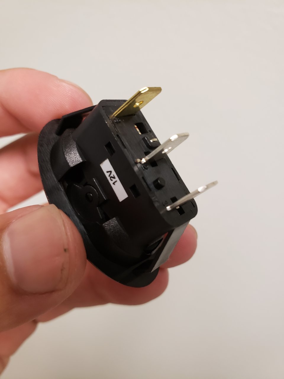

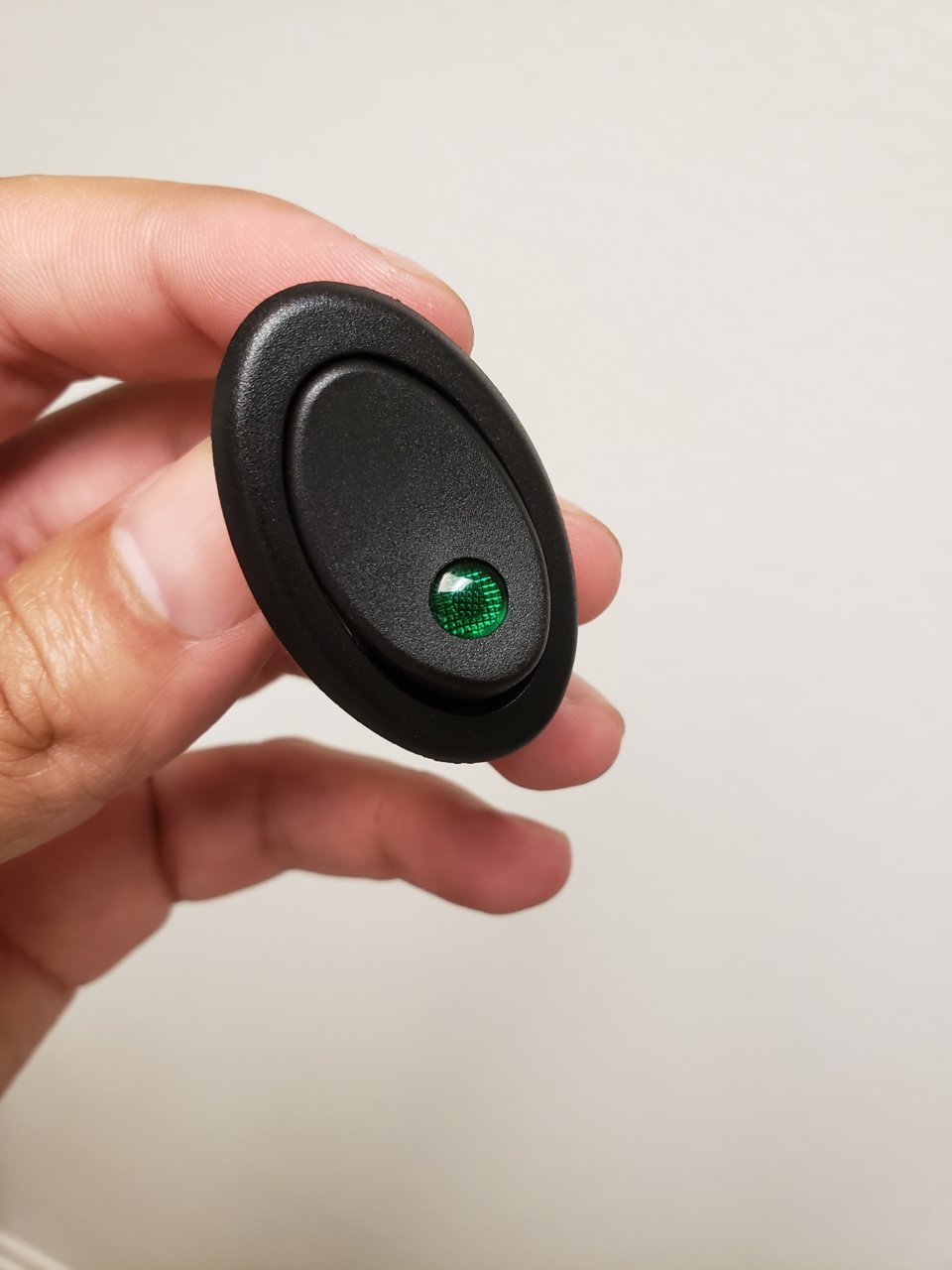

    Found a pair of these. Not sure how to wire them, no instructions :rolleyes:
    When I get back from my trip I'll install one to run my backup lights. Planning to eventually put some lights where the bed meets the rear window later so switch #2 is for that.

    Bottom lead should be 12v..
    Middle lead is negative. ( for the light on switch)
    Top lead should be load.
    Some switches are marked load and source..
    Some switches use gold as 12v and bottom for load.
    Edit i hate when switches are not marked..

    I'll try that, thanks. They're marked 1, 2, 3 lol. Tried downloading the instructions but the site says I need a valid email address. Only thing worse than unmarked switches with no instructions is buggy websites. :rolleyes:

    One should be 12v
    Two ground
    Three should be load.
    I hate manufacturers like that..
