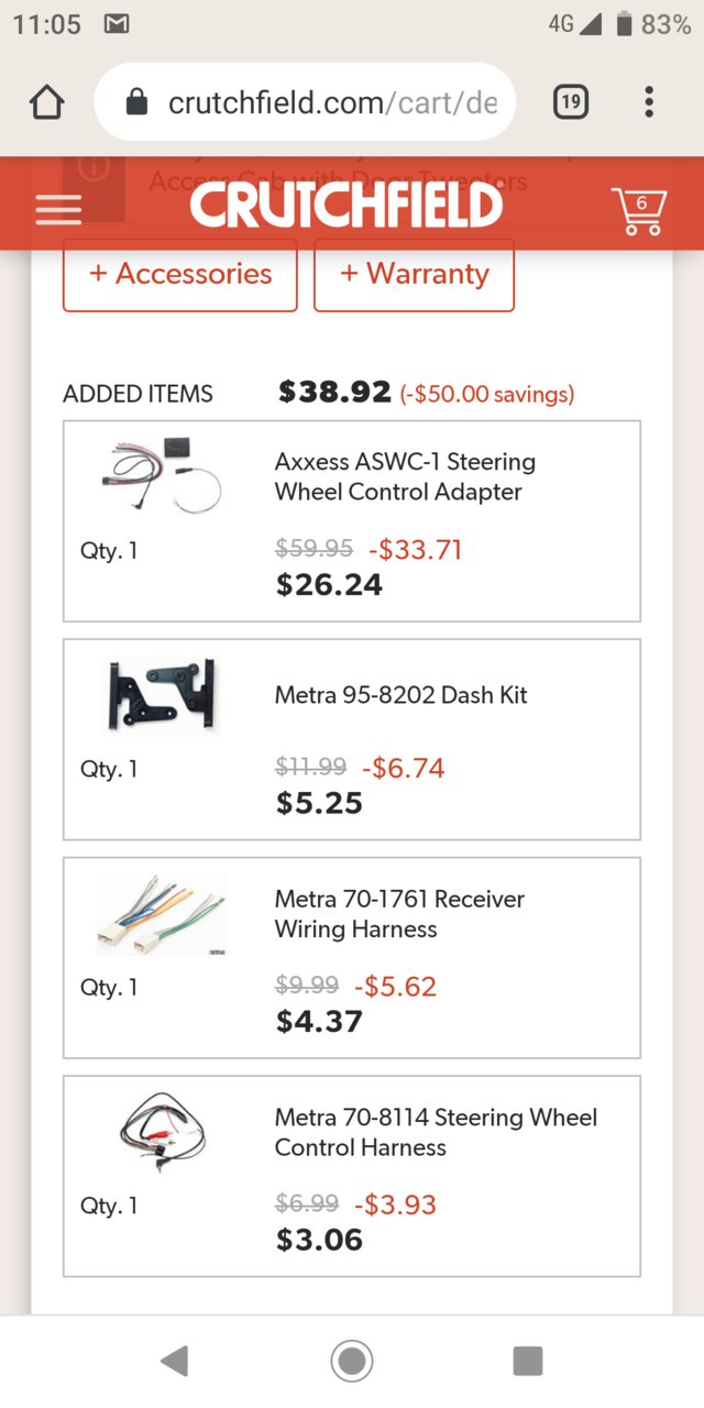

    Well I had to make a run to car toys for a different harness. Needed the Toyota premium audio harness. They tried to sell me an all in one harness for.$129 but I go just the one plug I needed for $25.
    I finally crashed from lack of sleep. But now I'm confused because I'm left with a blue power antenna wire, and a black and white amp ground wire. I don't know what to do with them. I want to just tie the amp ground into the other chassis ground wires.
    I've never had an audio project go so off the rails before. Especially after I prepped so carefully. I'm so ready to just throw it back together stock and take it to a pro on my next day off. I'm so frustrated.

    Got the pioneer in the dash, the steering wheel controls work, the touch screen works, it's paired with my phone but the speakers don't seem to work.
    Now with this harness there's no wires to wire into the pioneer speaker wires. However there are av cables. I followed the directions and plugged each color coded cable from the harness into the pioneers red and white av cables but I have no sound.

    Did you have the factory 6 disk without JBL?
    If so follow that single harness down behind the dash. You should see an amp that is held in by two 10mm. Pull the entire ac controls out of their respective clips and you can get to those 10mm with a long extension. On the bottom of that amp you should see two plugs that match the 70-1761 harness that you have. No need to buy some stupid expensive harness.

    Blue antenna wire turns on the amp when the radio is powered up.

    Check the manual. Some of the power antenna wires will only output on am/fm so the amp would turn off if switched to a different source.
    Most I've seen have a separate antenna and remote turn on lead.

    I guess I didn't really explain this too well so Ill give it another shot. If your truck has the 6 disc without JBL, then you have two options.
    A) Bypass the factory amplifier. (preferred) This is how it should be done in my opinion, speakers are now powered off of the head-unit as most traditional systems are. Locate the amplifier that is located behind the A/C controls. Remove amp, install new radio with the 70-1761 harness. This harness will plug into these wires:
    B) Integrate the factory amp. This will be sending a pre-amp signal into your factory amplifier that you have no control over the settings. This will use the harness that plugs into the factory 6 disc and you will need to use the 70-8112 harness. This harness will plug into these wires:
    Whichever route you choose you're still gonna get noise. Its just that you're more likely to like the noise you get going with option A.
    Here is the amp in question.
