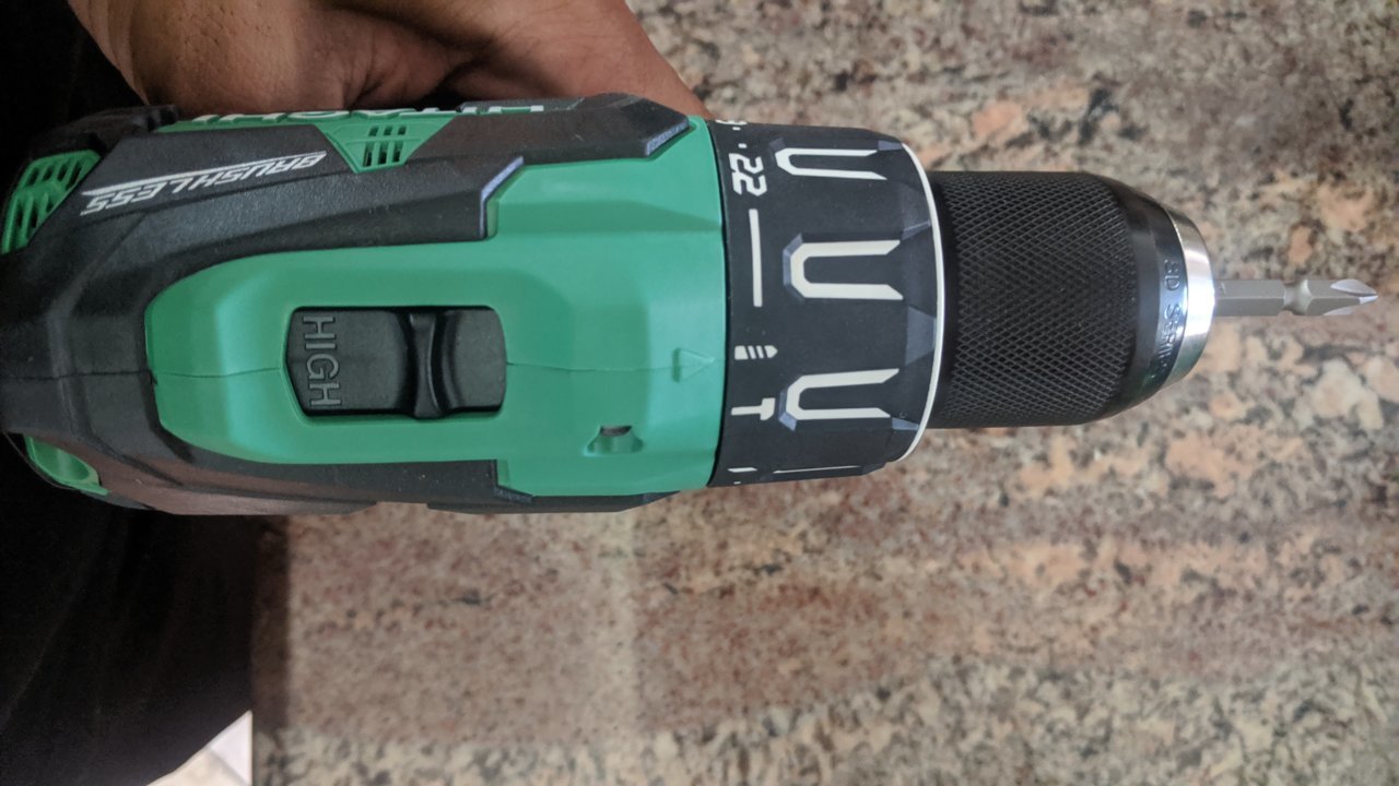

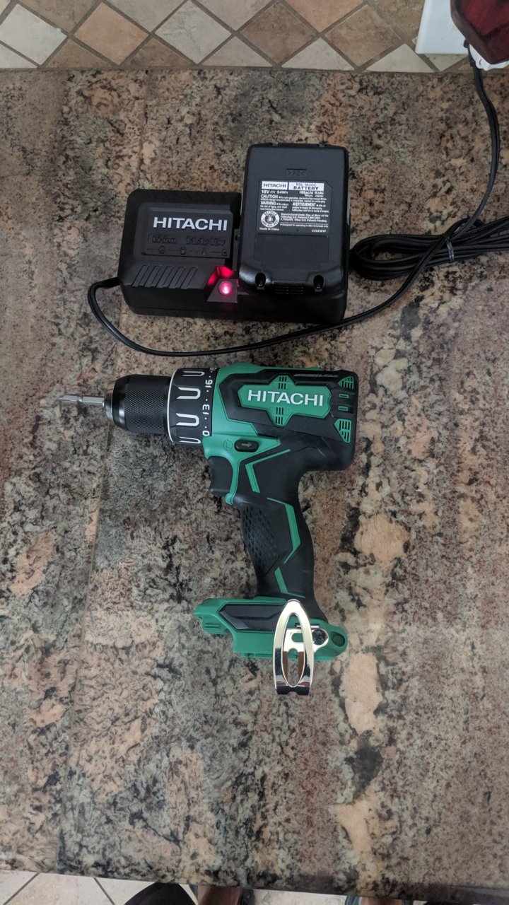

    Lowe's is having a clearance sale on Hitachi tools, I picked up the 18V hammer/driver drill with charger and 3ah battery for $99.IMG_20190706_150341.jpg 15624400661437054129016076079145.jpg

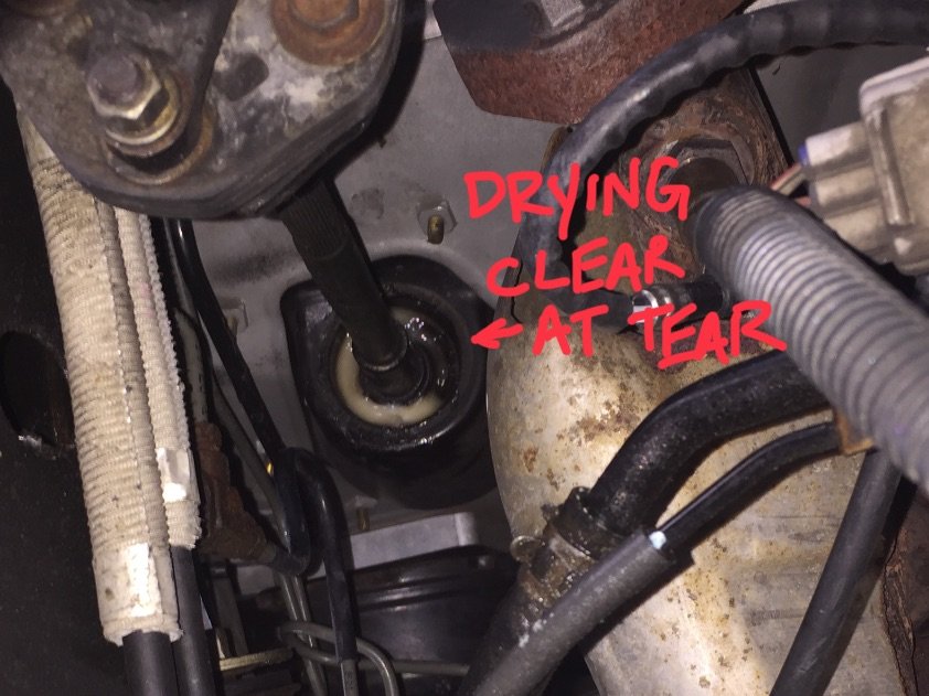

    Steering Boot Caulk Repair: Holding nicely. If yours is still salvageable like mine, then use some acrylic caulk in the squeeze tube to fit up in that tight space. Definitely quieter in the cab.

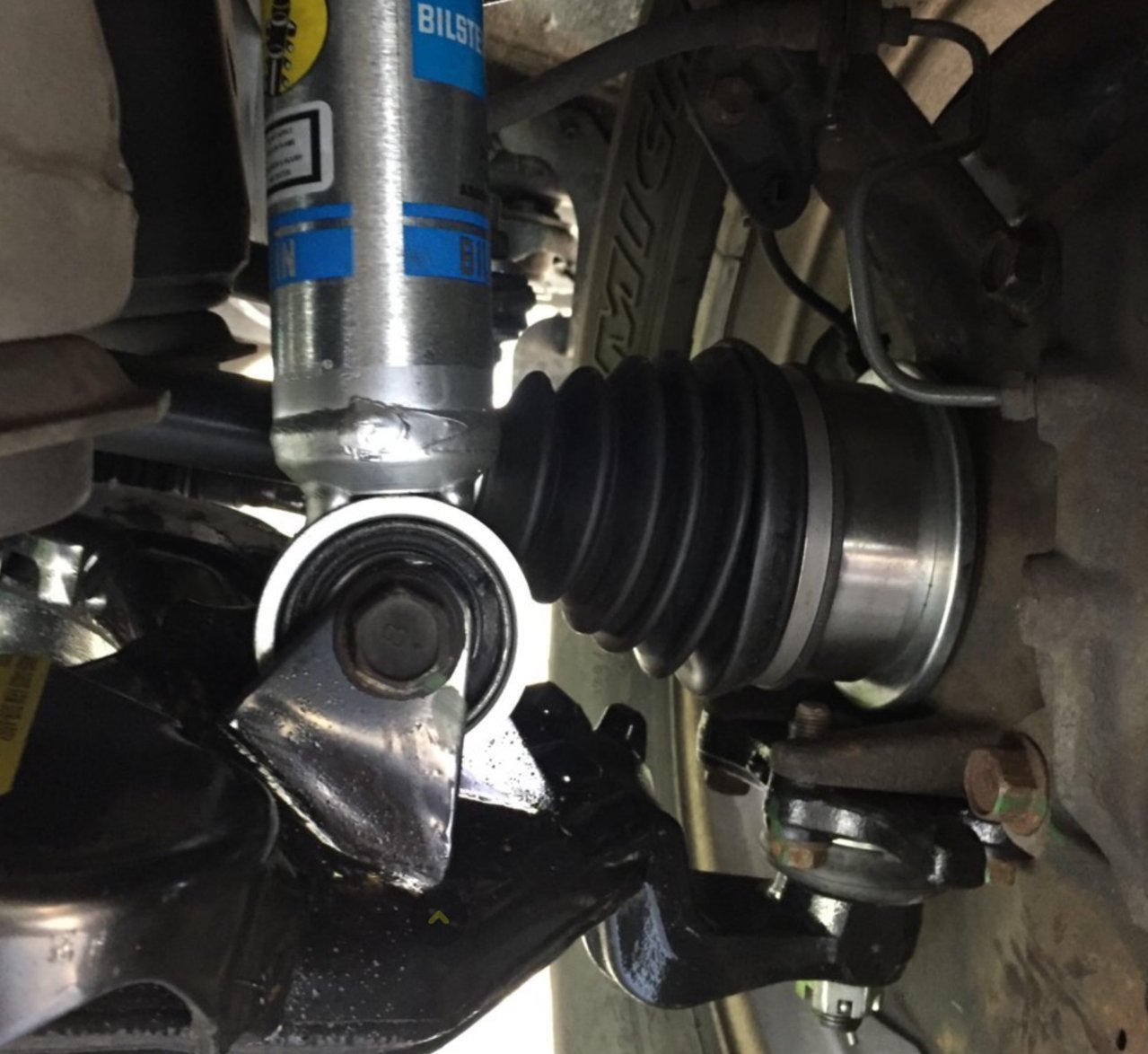

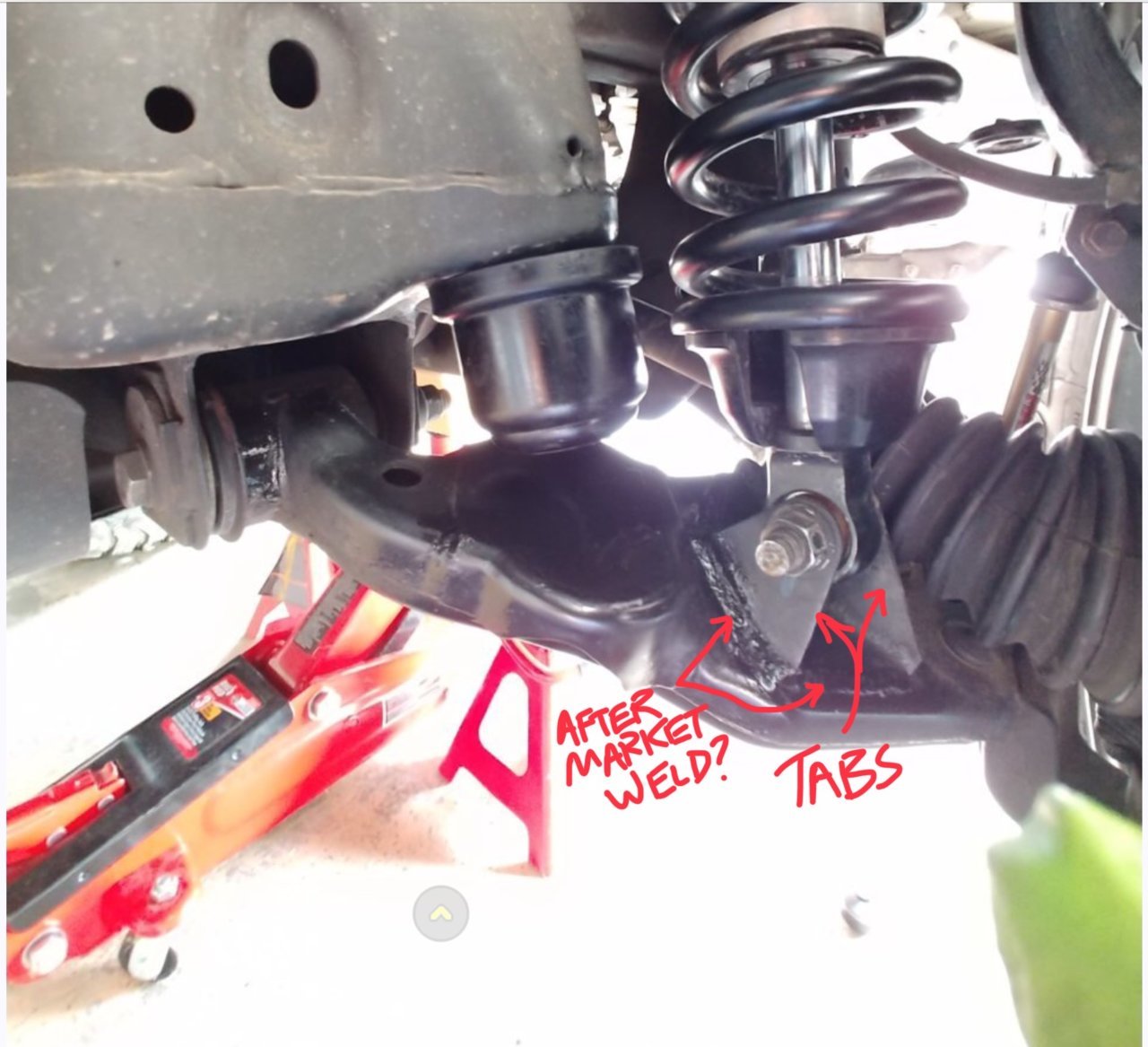

    Unfortunately, it appears you are correct. It must be the tone ring. I replaced the ABS sensor again and I'm still having false ABS moments. It sucks. Thankfully, it doesn't happen often so I'm just going to live with it until I replace the CV's.
    On another note, I finally installed the Super Bumps. I guess the SPC UCA's allowed for more clearance with the truck jacked up.Today was also the first time in a few months that I drove the truck with the sway bar on. It definitely makes a difference.

    What's up with the tabs on the lower arm?

    What tabs? Can you circle them? The green thing is my glove in the picture.

    I caught that too, looks like it's fully welded but for sure looks out of place.
    The tab your lower shock bolt goes through.

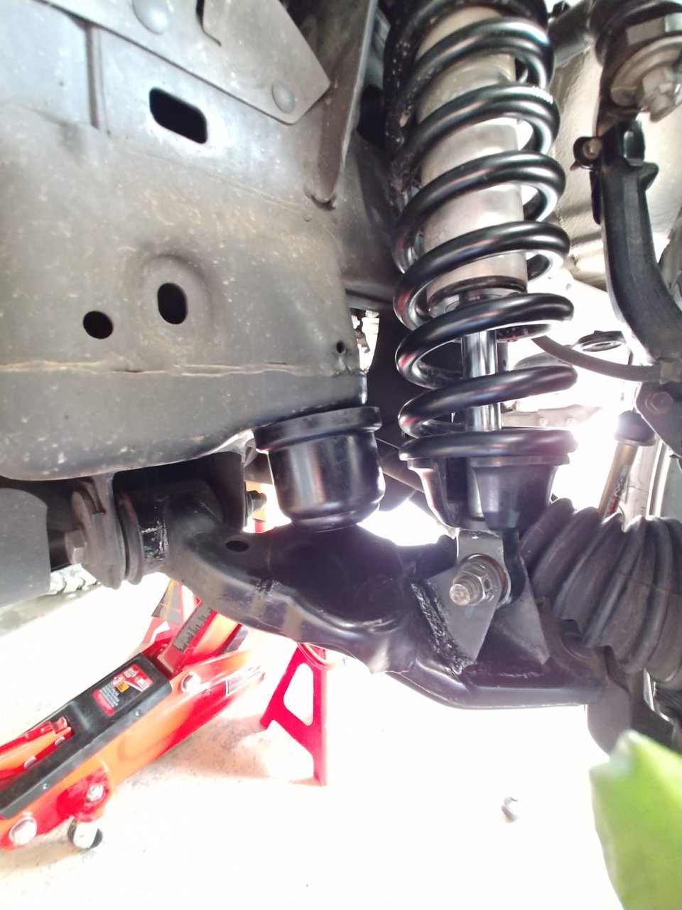

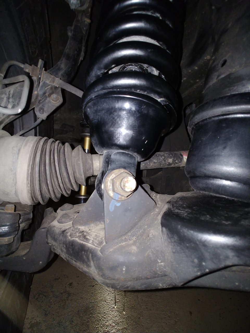

    Here is a shot of brand new OEM LCA’s. Tab looks different than @FirstGenVol. Maybe those Monroes by prior owner?

    Its probably fine, just looks almost like the tab has been replaced.
    Heres mine

    You're the 2nd person to mention that. I'm not opposed to it.
    Have you tested that under hard breaking in the rain? I had an 02 Corolla without ABS. The few times I had to stomp the brakes in the rain I ended up intentionally going into the grassy median to avoid hitting the car in front of me.
    You guys are scaring me. I can't imagine why the previous owner would have welded new tabs. The only scenario I can think of is rust but the truck honestly has very little rust. Unless he just hit something so hard it broke them...jesus I hope not. I'll post some better pics tomorrow to get your thoughts.
    @Professional Hand Model , I was the jackass that put those Monroe's on. Long story. I wish I could blame the P.O.
    Damn, after looking at your pics mine definitely looks different. Someone welded those didn't they... And a rough weld at that.

    @FirstGenVol you should be fine, just looks a bit odd. Does the other arm look the same?

    You tell me. Could these be aftermarket LCA's?
