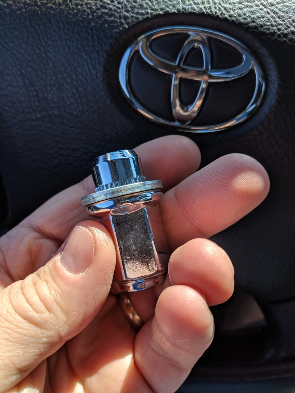

    I bought a lug nut for the Tundra while i was buying sway bar links and a thermostat for the wife's damn Durango.

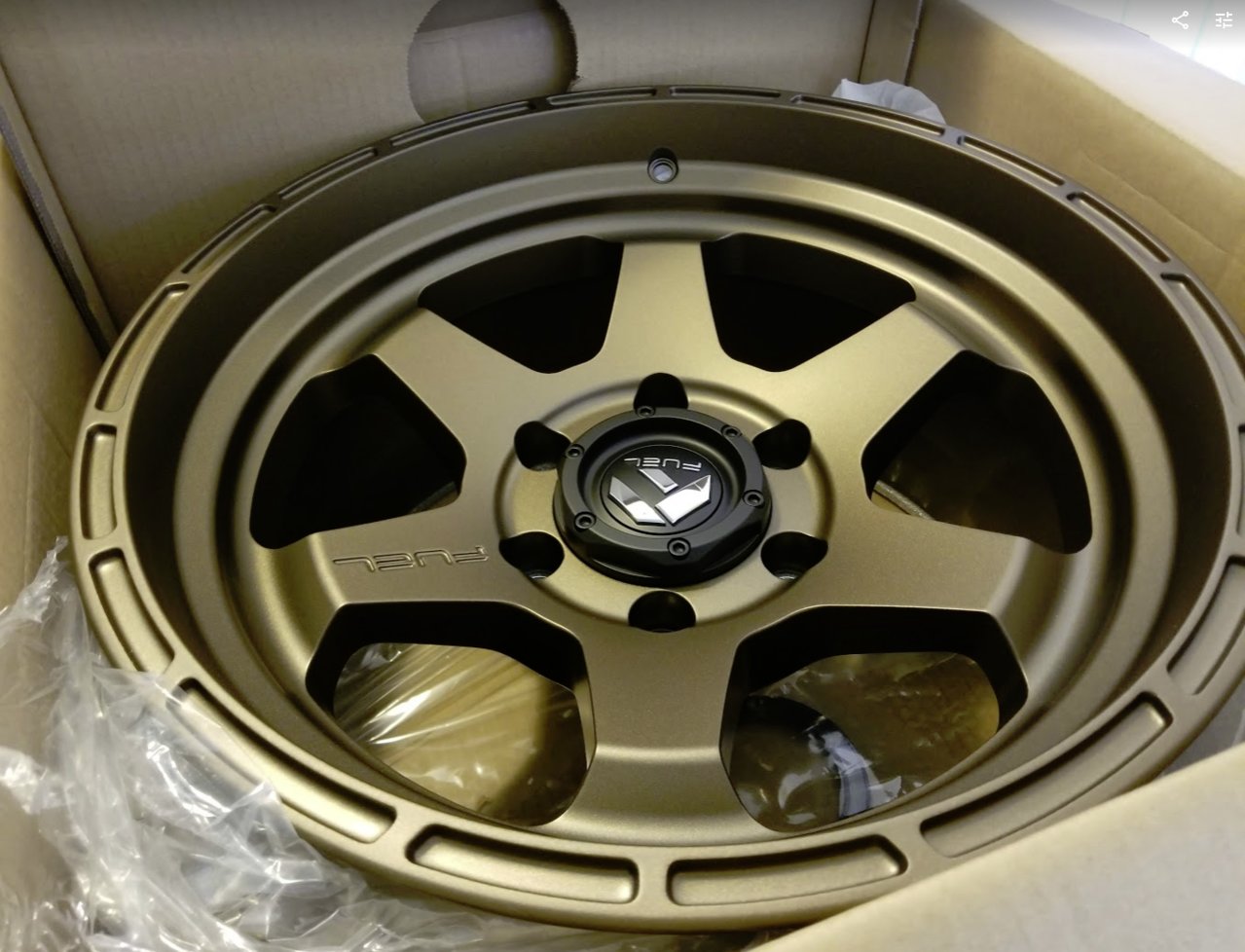

    Wheels came in today. Was going to get them mounted but the kids are with the in-laws so the wife made me take her to dinner instead.

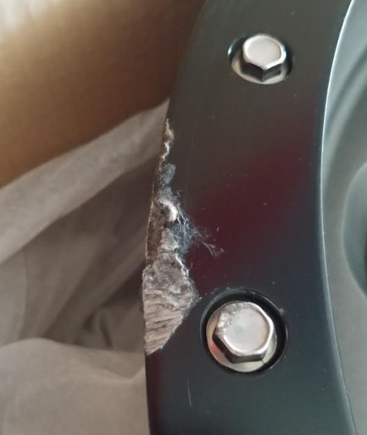

    Very similar wheels to what I have and we have the same color and brand of tire. Almost like they are cousin trucks haha.

    Or after he files it down he can be super picky and get some body filler in there. That's what I'd do. Nobody would know.

    Fix. That's cheap to enjoy your truck more everyday.
    Fix if for no other reason than to not get sponges & rags caught on it when cleaning truck.
    Before you have it on the truck & it becomes a PIA to get it fixed.

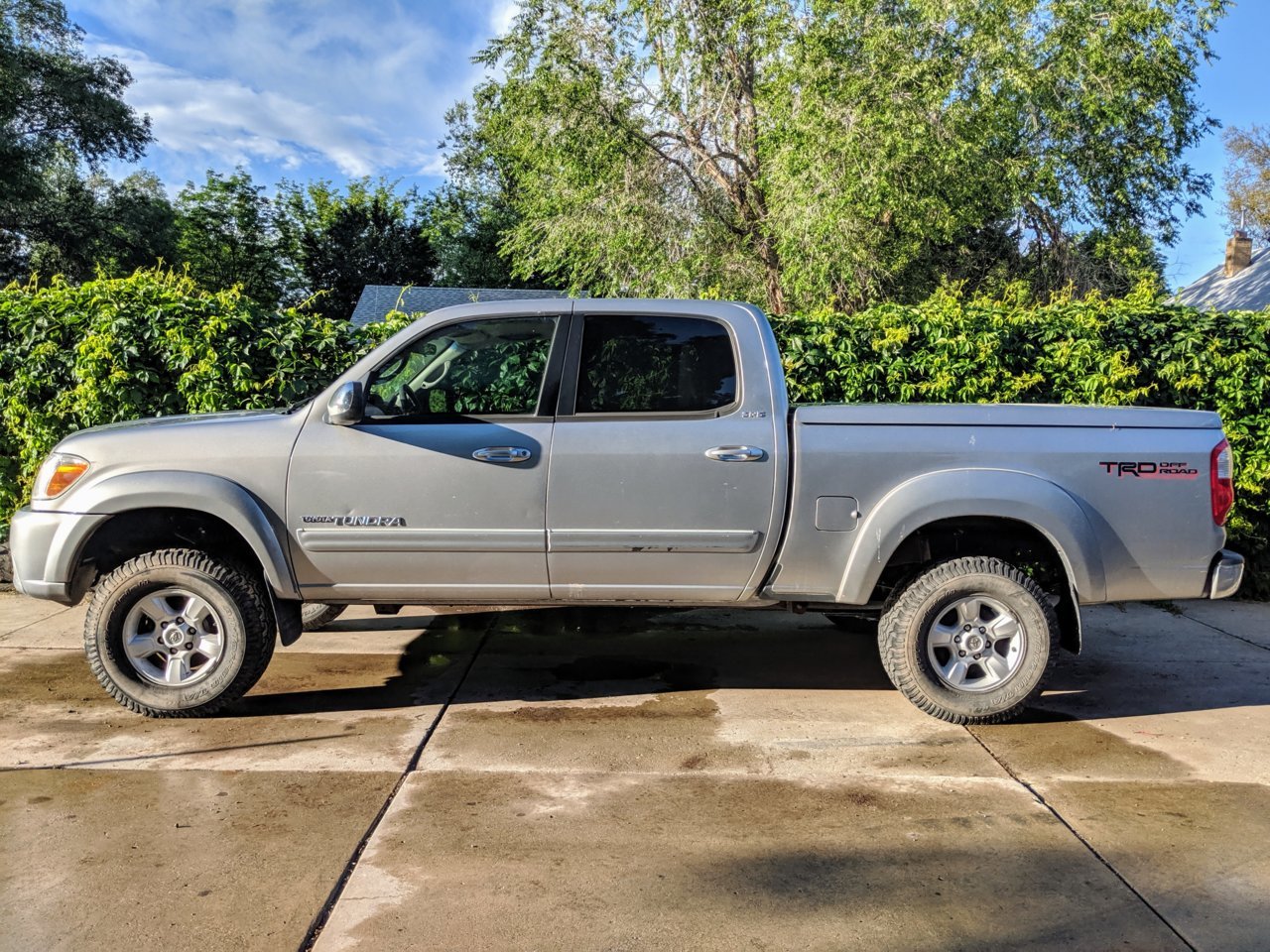

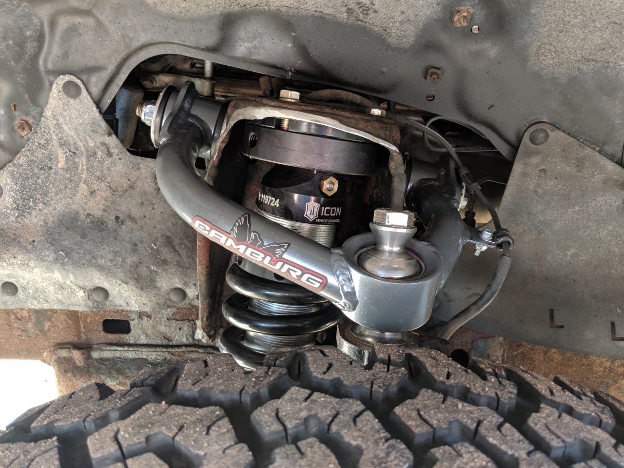

    So it is mostly done. ICON 2.5 extended travel coilovers, Camburg upper control arms, 1/2” spacer driver's side, 1/4" spacer passenger side. Stainless steel performance brake lines front and rear and toytec differential drop kit. ICON 1.5" add-a-leafs, ICON 2.0 VS rear shocks. Coming: SCS Ray 10s 16x8 and BFG All terrains 295/75/16.
    It sits damn near level, front sits a tad high but I wanted to allow for break-in and sag.
    ICON coilovers set at 1 5/16” of preload (top of adjuster cup to bottom of shock cap)
    Bottom of fender to center of hub measurements.
    Front Driver: 23”
    Front Passenger: 23"
    Driver Rear: 23 3/8”
    Passenger Rear: 23"

    Which brake lines did you get and what length are they?
    Thanks
    Clean truck!

    Correct me if I am wrong but those are 33.3" correct? They look like they fit no problem. Can you confirm this is accurate?

    They are from Wheelers. The rear is 2" longer for lifted applications. The fronts are the same length.

    Lol. No, those are 265/75/16's. A 295/75/16 converts to 33.4 x 11.6

    Oh, it said "Coming 295" in the post. I thought that seemed off.
    Thanks for the clarification.

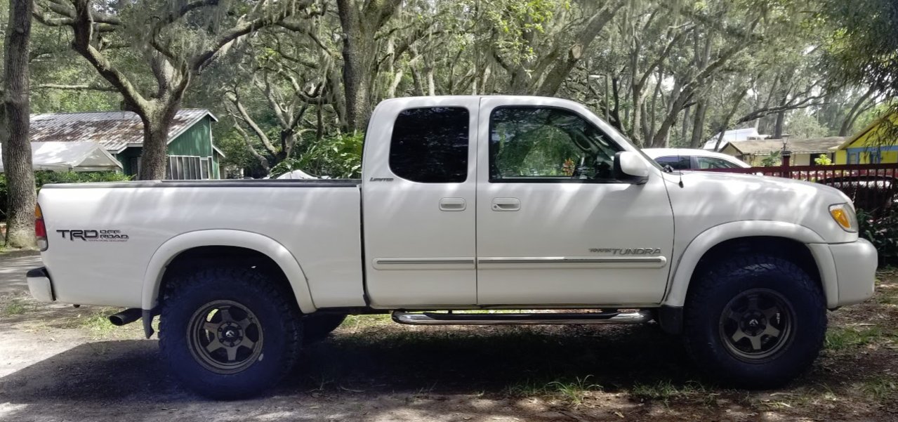

    Sooo.... I got some trimming to do tomorrow! But overall, love the wheels, the offset and tire choice.

    Are you lifting it at all or just chopping the shit out of it? :eek::D
