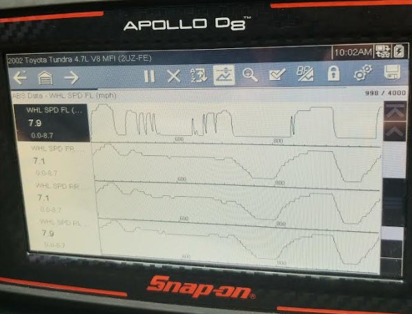

    This false ABS activation is driving me nuts so I took the truck back to the 4x4 shop today and asked them to hook up their fancy SnapON tool. Below is the readout it's showing for all 4 ABS sensors.
    As you can see, the left front sensor(top graph) is not tracking the same as the others. There are times when it's not picking up any activity at all. Their best guess is that the replacement sensor I bought off eBay is a dud. We inspected the tone ring per the advice of @empty_lord and it looked fine.
    It appears I'm going to have to eat the $50 I paid for this sensor and buy another one. I'm not sure what else to try.

    It almost looks like there's a break in the wire and the signal is dropping out.

    It appeared fine when I installed it but if it's under the external shell I suppose I wouldn't be able to tell. The tech helping me said the only other thing he could think of is an issue in the line after the point at which the sensor plugs in. He said that would be very unlikely though.

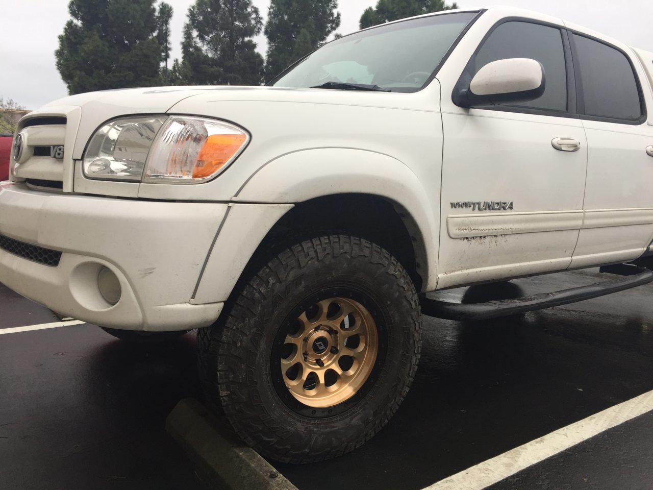

    Did those rub and what was your offset and lift? I just bought 285/75/17 ko2s for 17x9 Fuel D666's with -12 offset.

    -10 offset on these assuming he got the 17x8.5. I would be surprised if they didn't rub.

    I had some rubbing on the frame when turning in reverse at full lock. Granted this was my pavement princess so I didn't wheel it or fully flex out the suspension. Probably a pinch weld adjustment and trimming some plastic would have been enough.

    Looks like the aftermarket sensor isn’t shielded.

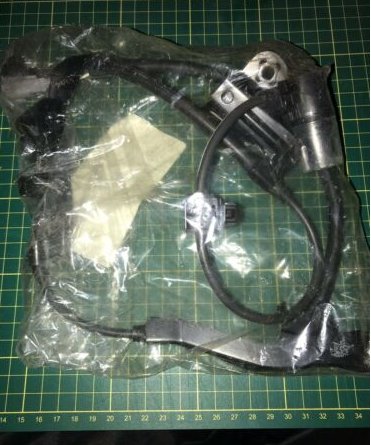

    It was an OEM sensor I bought off eBay. It was listed as new for $50 compared to $200 everywhere else. Perhaps the seller screwed me but it came in official Toyota packaging.

    Got pictures? I’m curious. I’ve had multiple people burned by “oem” parts on ebay

    If you still have your old one try swapping left side to right side if you can. If the issue stays at the same wheel it might be not the sensor but wiring beyond the sensor.

    These are from the listing. I'll take more when I remove it. But it looked just like the one that came off. I'm going to take a chance on a $20 one from Amazon. They have good reviews and if it doesn't work I'll just return it. I'd rather try this before dropping $200.

    Bag looks legit. Should be some part numbers on the sensor itself when you pull it.

    A time ring issue can also appear like your graph there does. These tone rings are pressed onto the hub so not super easy to inspect

    Do what I did on my 03 DC taco and just pull the abs fuse. Problem solved.

    No rub here with 285/70's on a level kit with mud flaps removed on -12 rims

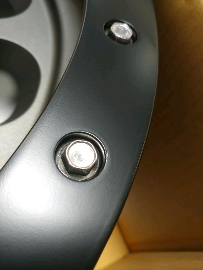

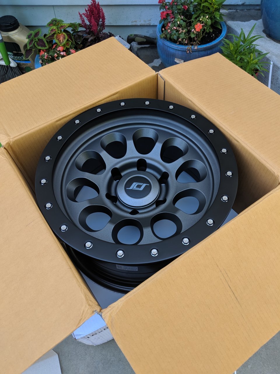

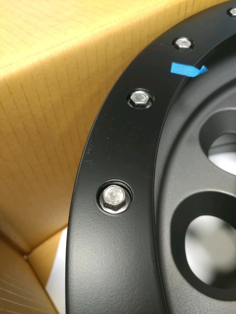

    Nice! I got brand new blemished delivered Wednesday. Vin gave a pretty good deal consider 3 out of the 4 wheels took me a minute to find the "blemish". He sent me photos via email before I pulled the trigger and they look far worse in the pictures. $798 shipped. Last photo is of the "worst" one after I unboxed it, see if any of you can find the damage. :D

    Very nice! Good move snatching up those "blemished" units. They look great. I've been meaning to ask how the progress was going. Did you receive the ICON's yet?

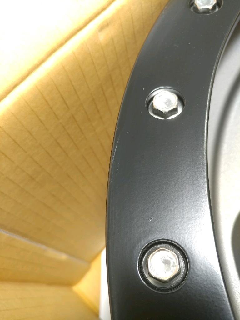

    Here is the worst of the damage on the used ones I bought. I found a guy that will fix this for $75 but I can't decide if it's worth it.

    That's a pretty good chunk, but $75 to fix it will be worth it. I received the camburgs and ICONs a couple of weeks ago and currently have been working on it after work since Wednesday. I got both the ICONs on and one of the camburgs. I got stopped last night by the drivers side CV coming apart. Not sure what cause this yet but I got figure that out before continuing. It has gone pretty well up to that point. I went with the 700# spring instead of the standard 650# and they claim that with the 1" of threads showing i should be right around 3" of lift but I say bullshit. Anyone with a double cab 4wd have any intel about ICONs with 700# spring? I have searched and I can't seem to find anything.

    I'd say file that down smooth and shoot it with some paint. Put it on the passenger side and you'll forget all about it.

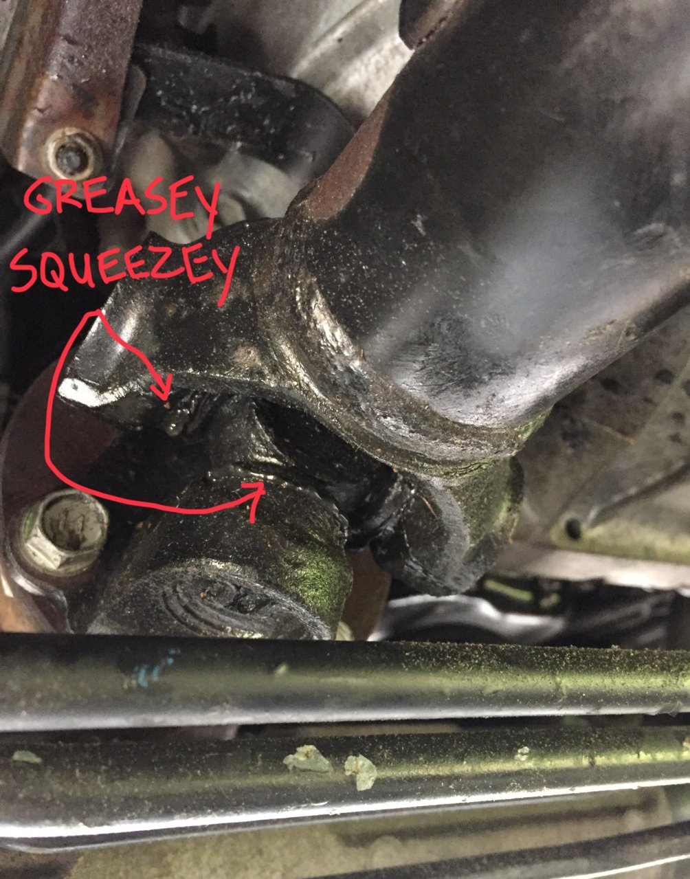

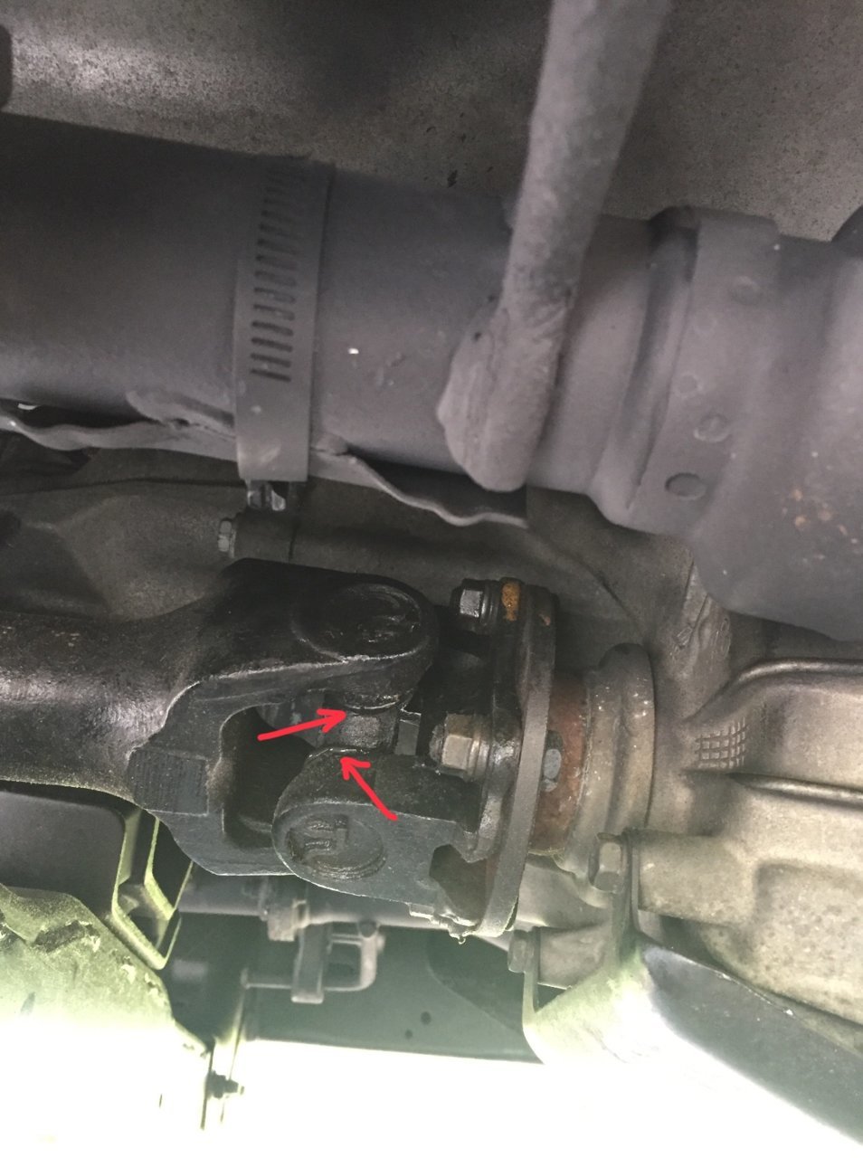

    Proof that the 4wd prop shaft can be greased at the zerks.
