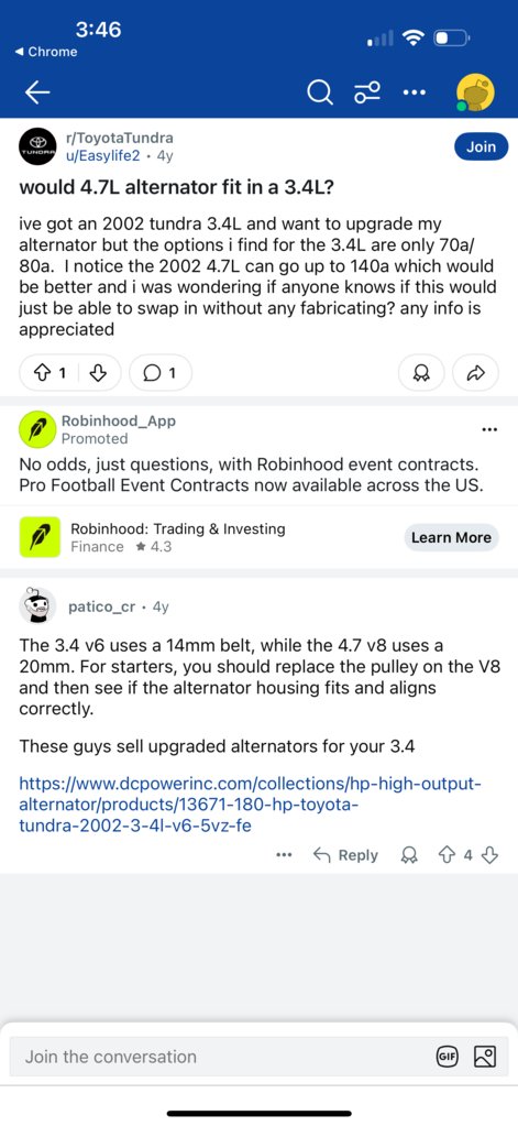

    Thanks, looks like Rock Auto is my solution! Just ordered the 100amp V8 4.7version of alternator, should bolt right in, correct?

    I’d dig deeper. Do you have the 70a or 80a because a taco forum mentioned a different shaft diameter so a pulley swap wouldnt work.
    for some reason i thought the 5vz alternator bolted to the side of the block, but that was incorrect, which made me dig into the rabbit hole a bit.

    Imma keep it stock
    Not much available for upgraded the alternator for the 5vz

    john deere and cadillac according to the taco forum & expedition portal.

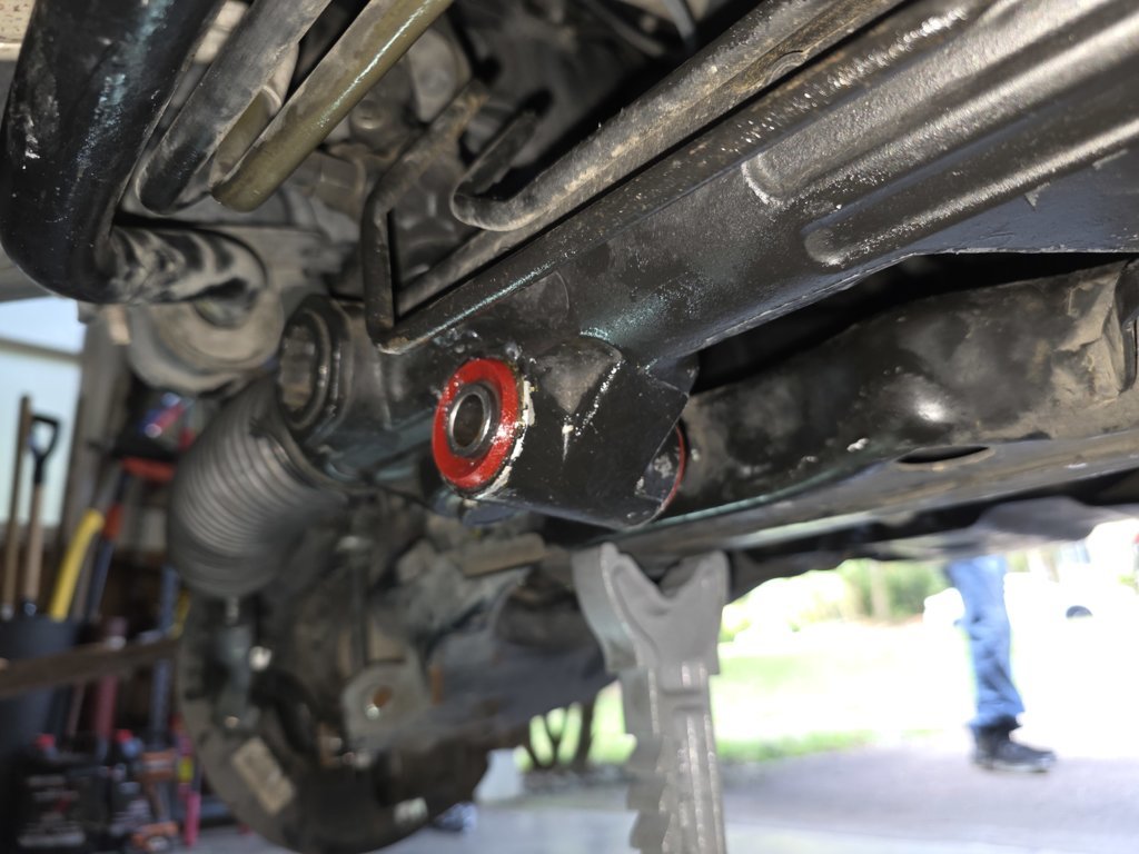

    Nice! In what ways was it worth it? Less slop or better turn radius?

    Do they make the poly bushings in black? My rubber OEM bushings are always getting destroyed from steering fluid leaking all over them

    Less slop, less travel and a its not spongy on turns anymore.
    @Jack McCarthy I only saw them in red when I ordered from total chaos.

    The Black Mamba,
    I see that link;
    https://www.dcpowerinc.com/products...00-3-4l-v6-5vz-fe?_pos=9&_sid=84a144888&_ss=r
    180 Amp HP High Output Alternator (Toyota Tundra 3.4L V6 5VZ-FE)
    Regular price$639.95
    Not ready to spend $600+ but the Chinese writing on the alternator on my truck is gone, maybe my Vin could tell me what the original alt was, I'm creative on making this work if it's possible but I'm not at home and in Hilton Head right now. The idea is to vector the part to my return, my main concern is the wiring connectors and physical mounting measurements. Will see what I have when I get back to San Diego and compare both to each other side by side
