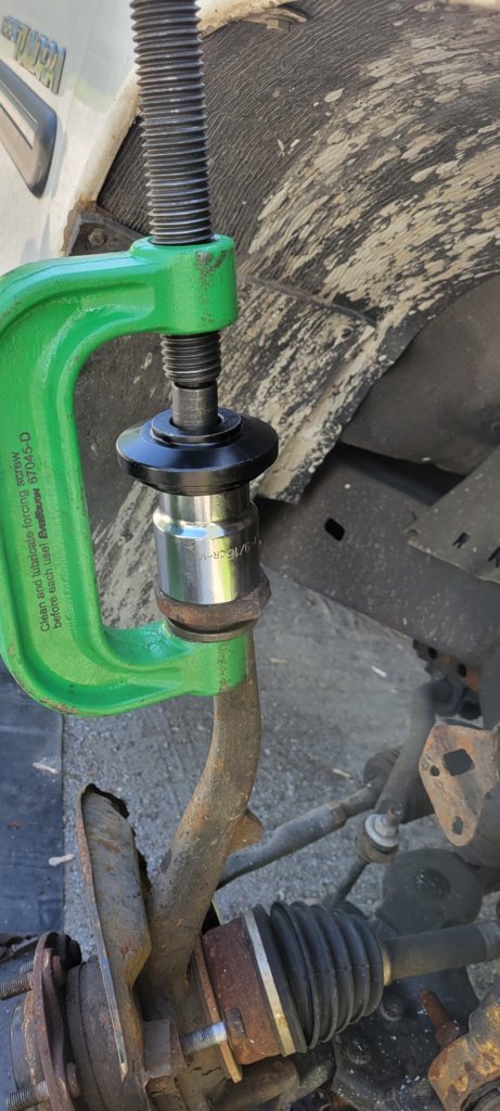

    For those of you that have done your UCA replacements yourself. Im seeing ill need a ball joint press. Any other special tools?
    Is it possible to do the ball joint removal and install from the spindle without removing the spindle from the axle? Also, I dont have the strongest impact, will I need a pretty beefy impact for this job?

    there’s a really long drawn out post of people trying and giving up in one of the sticky’s. You can do it, but you need the perfect cups on the press. It definitely makes life more difficult working under the fender. Timmy’s video is great and he took the spindle off.
    here are some people that did it, in 20 seconds I think they are 4x4. They didn’t use oem, so obviously we can’t follow up since they died in an accident shortly after filming.
    https://youtu.be/dpvCGWRPlVw
    https://youtu.be/a29VKBcXgg0
    Not sure what year this is, but wow this guy.
    https://youtu.be/bl9t1KHLvBM

    https://www.tundras.com/threads/upper-ball-joint-removal.42150/
    You'll see suggestions that pulling the spindle can make pressing easier but doing it under the fender is possible.
