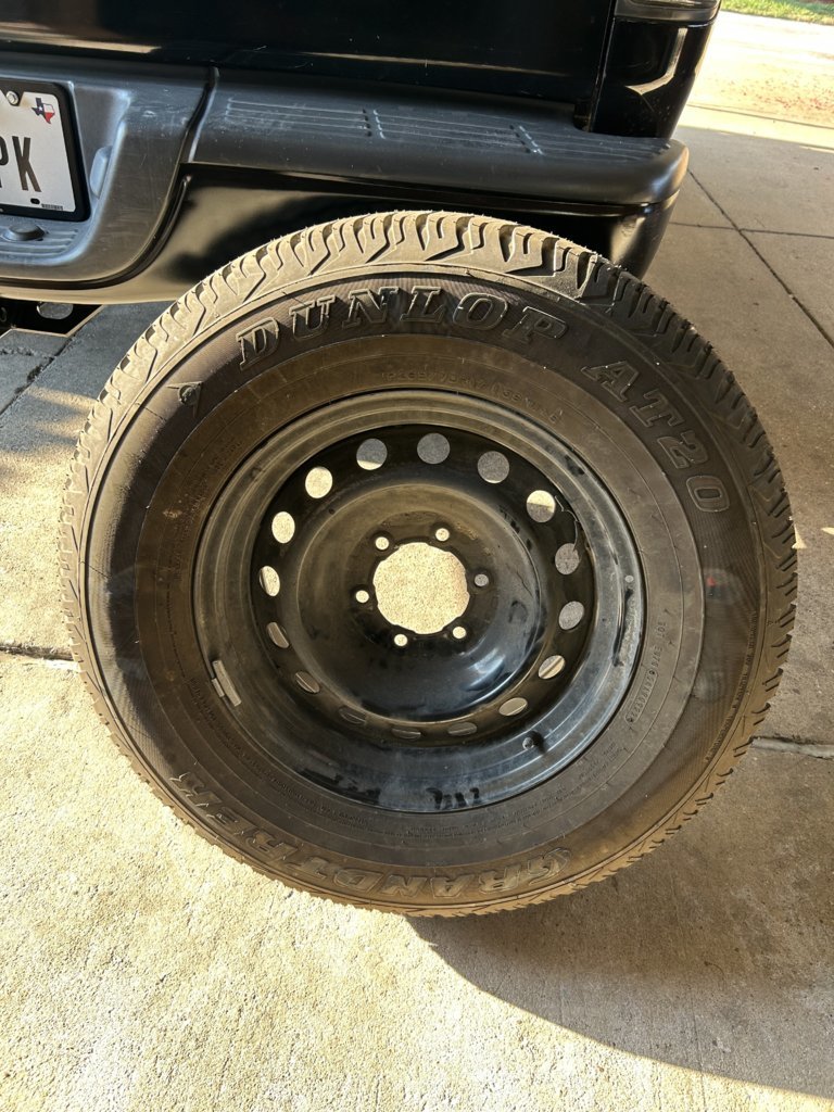

    I finally have a spare tire again. No @KNABORES , this rim isn’t gold either. I stole this out a 22 4Runner

    I still need to get a new spare muhself. Something in 33” flavor.

    What happened to you old spare?
