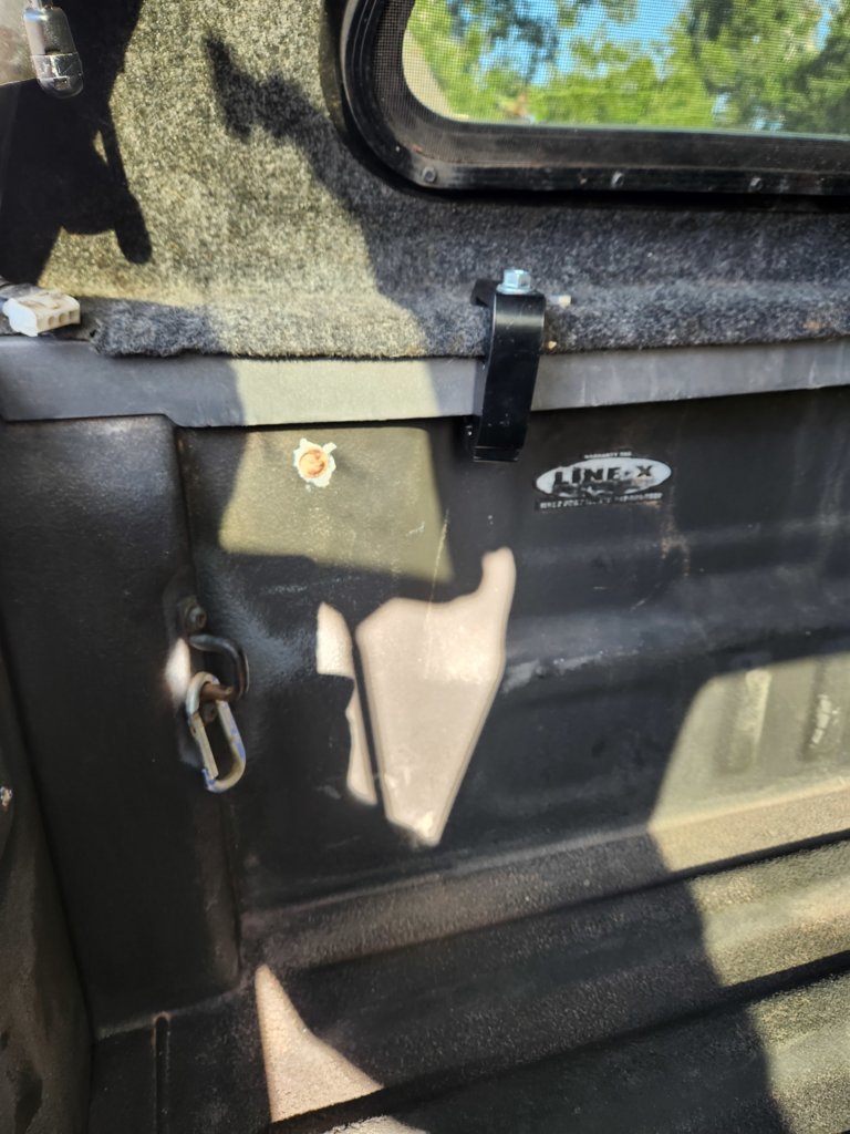

    Today I propped my topper up with four 6x4's on the bed rails, to set the thick front weather stripping. I'm still going to have to go back with a little silicone to get it air tight, but it's pretty good. I thought about double bubbling the sides, but the ARE goes over the bed rails and has a thin foam layer already. I did however, put bolts thru either side of the topper and bed rail, toward the tailgate. I noticed with the old topper and even up to 8 clamps, that the vibrations from offroading would spread the sides and make the gaps along the rear window wider. So I'm still using four clamps, but the bolts will prevent any shifting. Then I weather stripped the tailgate on the bottom and sides.
    Next is to change the lock, but it's hot AF right now. So I'm chilling in the pool. Will finish up tonight, when it cools down.
    Also going to vacuum, sweep, and wash the inside of the bed and topper tonight.

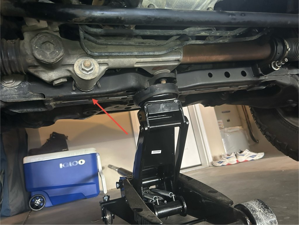

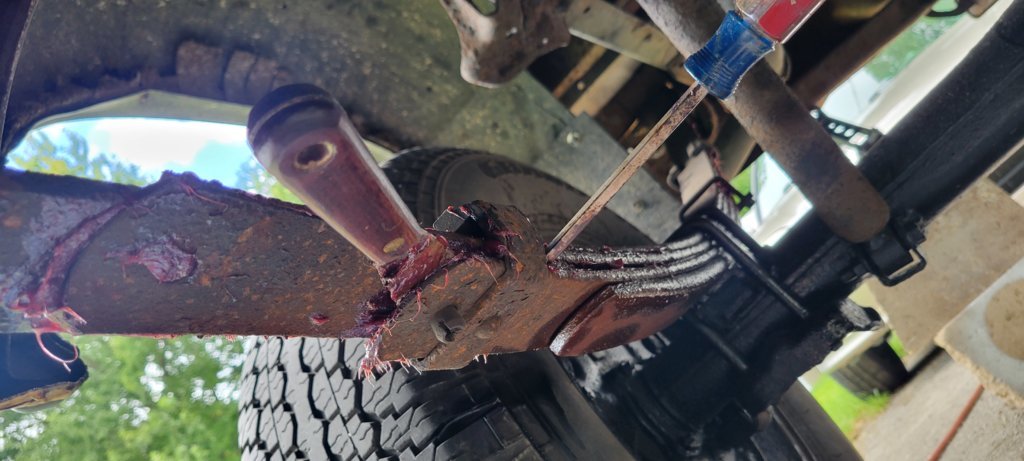

    No grabbing that I can see. Jacked it up and didn’t have a lot of play in the wheels either.
    The only thing that I noticed was one of the rack bushings/rubber seemed to be torn, but that might be a future project since I’m not positive that’s causing the clunk at low speed turns and bumps. I feel like I can hear it in the front, but I’m going to try pb blast on the leafs and see if it goes away.

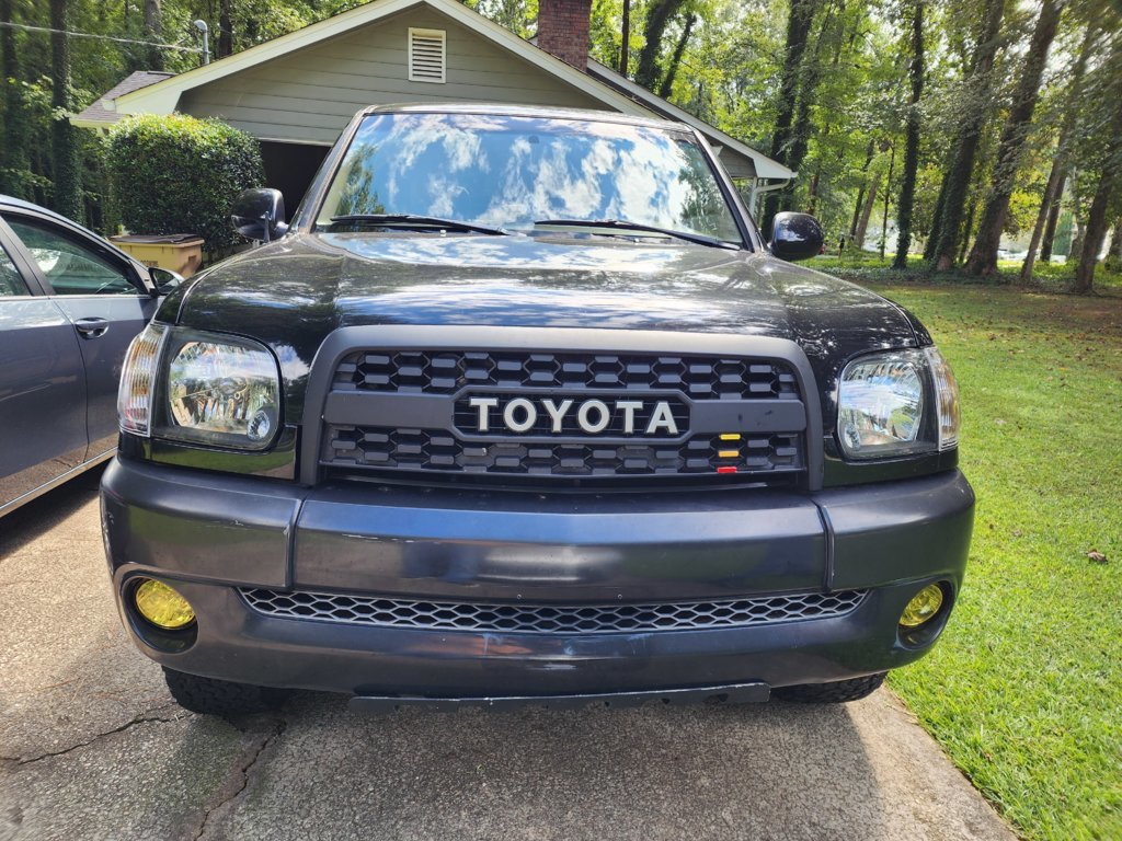

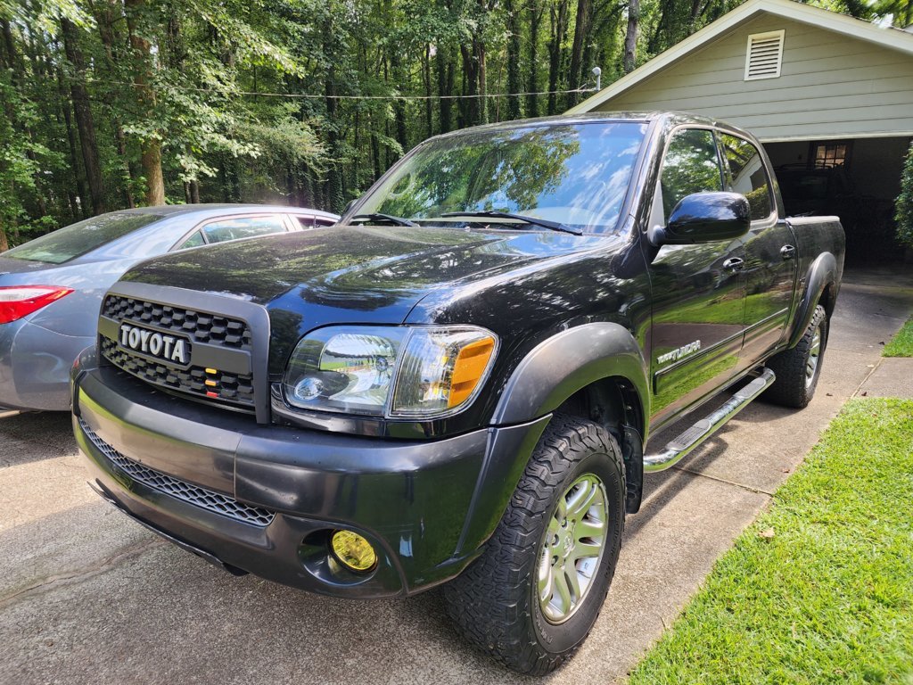

    So what grille is that? TEQ? Looks great.
    https://teqcustoms.com/products/trd-pro-grille-03-06-tundra-teq-customs
