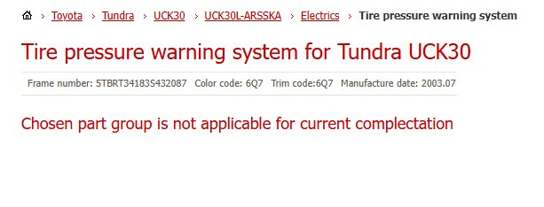

    Do you currently have a TPMS light in the dashboard? I'm asking because, Denso's support on the 550-0103 sensor starts at 2004, and when I run a random 2003 Tundra VIN via Google a minute ago, it kicks out the error below, as if you have no TPMS available for your chassis.
    Generally speaking, as long as it's a Toyota vehicle in a comparable year range, there's a solid chance the sensors are using the same transmit protocol/frequency, and will work. I'm pretty sure none of the TPMS stuff is secure/encrypted, so it's all about - first and foremost - that the frequency is 315MHz to the TPMS ECU can actually "hear" it, then it just needs to be speaking in a protocol the TPMS ECU will understand.
