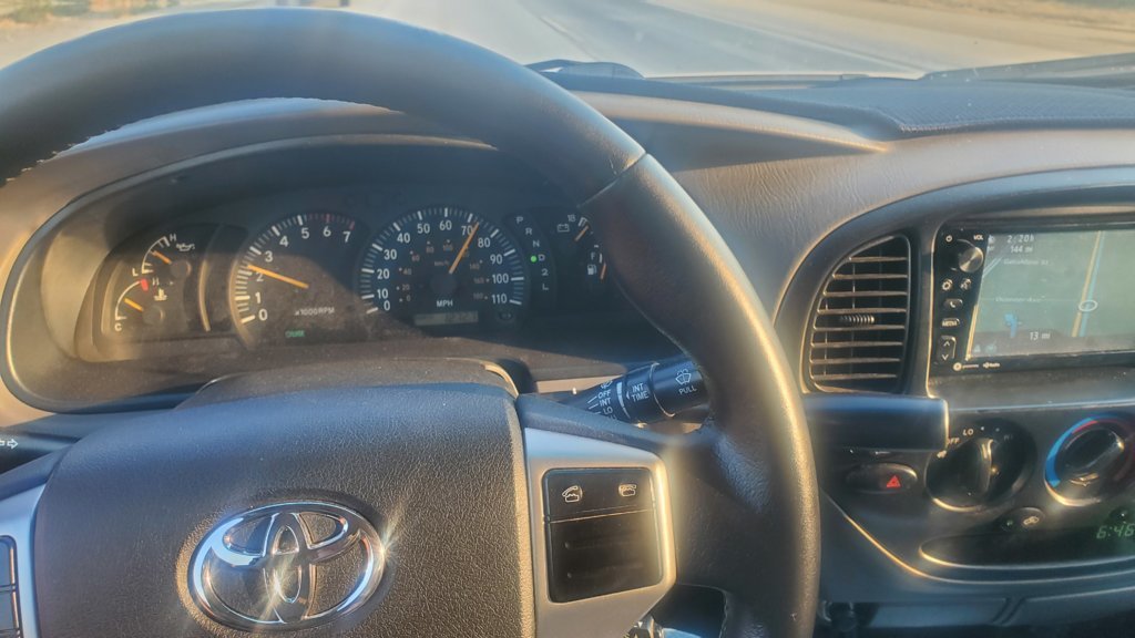

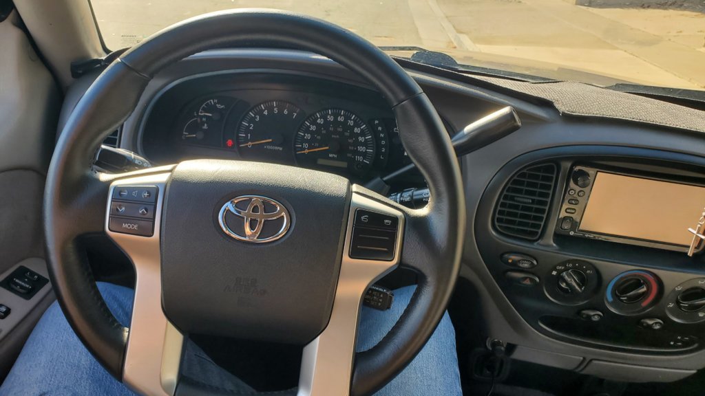

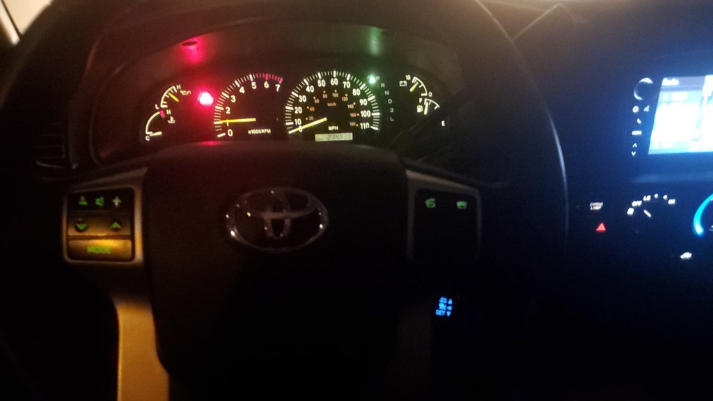

    Need to add the upgraded climate control knobs to go with your new steering wheel better too. Looks awesome.

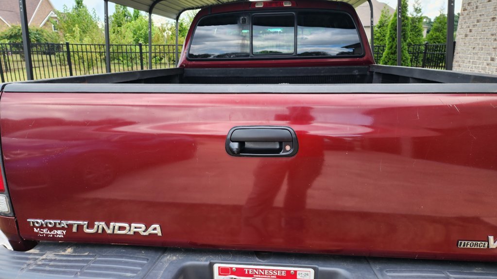

    Got the camera and rear view mirror screen installed in the truck. Still have to finish wiring it up as trying to find a non rusted surface close enough for the ground wire didn't happen. Have to get the grinder out later.

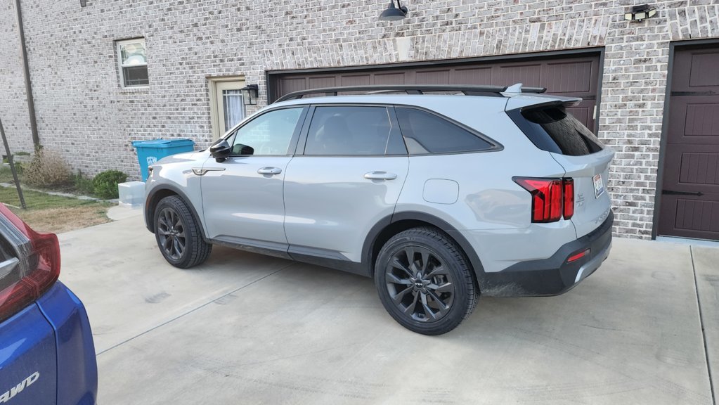

    On a non 1GT note, got some new shoes for the wife's Kia. It came with Continental Contact Sport 255/45-20s. These things were toast at 36k miles. Not many options in that size that weren't $325+ each. So I went with the Continental TerrainContact HT which are the truck version CrossContact LX25 that I have on my CR-V which I love. But ended up having to go up to a 255/50-20 which is an inch in diameter bigger. These look so much better on hers. I haven't gotten to drive it yet to see the difference. So far, no complaints from her. These pictures don't do it justice on how much bigger these tires look on it.

    USPS suggests my backup camera “master tailgater” camera/tailgate comes today. Ive installed one previously and grounded it to the rear left taillight. There is a fastener underneath the assembly. Hopefully that helps

    I’ll snap some pictures today of the location in reference. Hopefully it’s prior to your arrival home.

    Looks great! What year Prado wheel? 2012? Also how hard was it to get the 86 radio working. I assume it’s not a direct plug/play and maybe some dash trimming?

    It's generaally direct plug-and-play, you just need to repin one wire on the 1st Gen radio harness IIRC. At least for non-JBL trucks.
    But note that the earlier trucks (00-02 or 00-03) have a smaller dash opening for the radio, so it may not be a direct fit for those. It's a direct bolt-in for the later years with the wider radio opening.
