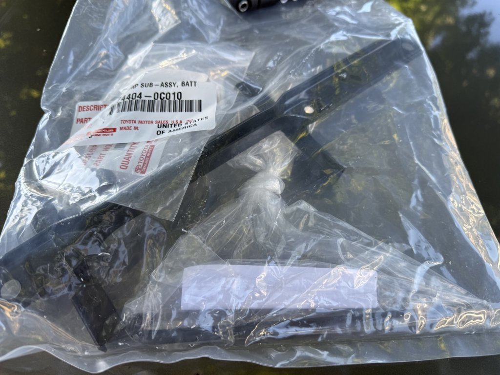

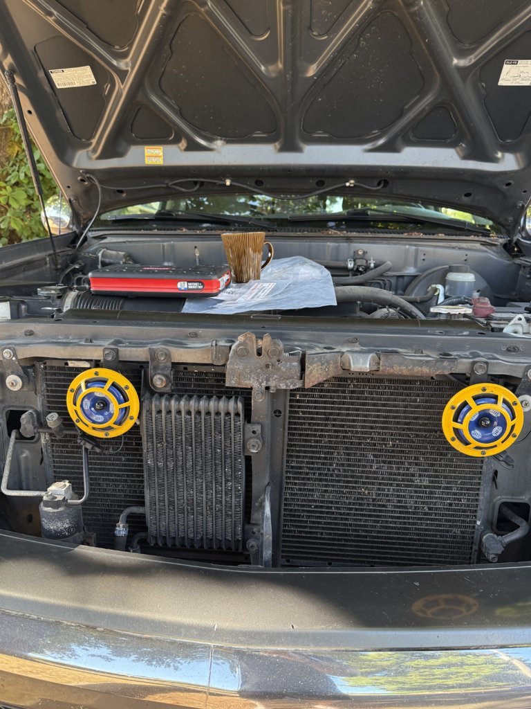

    eBay battery retainer arrived and installed.
    And these Hella horns will always make me smile and think of Subarus. I do need to see if I can make them more symmetrical at some point since they’re totally visible through the grill.

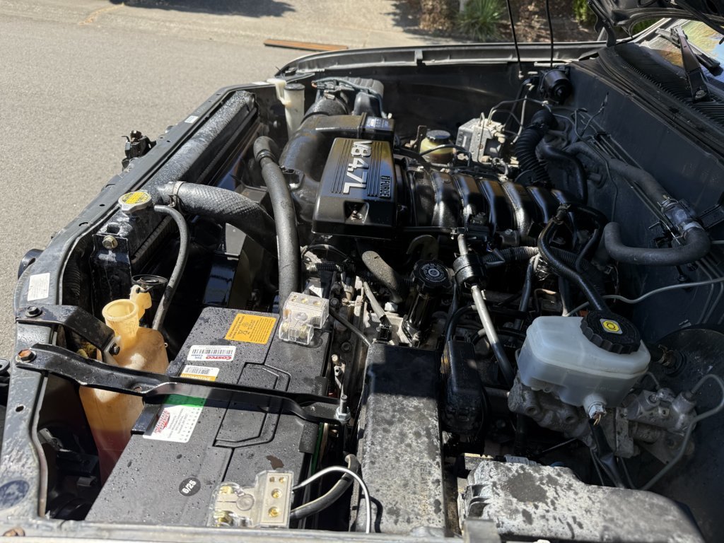

    Not having fun anymore. Trying to limp this thing home while it over heats every 1/4 mile
    jerryallday likes this.

    Can’t seem to get enough coolant into it. Don’t think I have a leak, just think it has a bunch of air in it still.

    Looks like the radiator cap has been squirtin'. You know how to get 'em hot, and make 'em squirt, my friend.
    Seriously though, run the truck with heat on full blast. I was gonna ask if you're sure it's overheating, but based on the top of the radiator, I'm thinking it may really be.
    Have you squeezed all the tubes to see if any aren't firm when running?

    Just poured a half gal of coolant into it after ubering to O’reiley and it just ran out of the bottom of the plastic on top so the rad has bit the dust. I guess I need to order a denso but I’ve been pouring money into this thing and still can’t drive it. Might need to take a break.

    Sorry to hear. But good news is if it's leaking that much then it's likely diagnosed and repair is contained to about $200 for rad and coolant with a fairly straight forward swap.

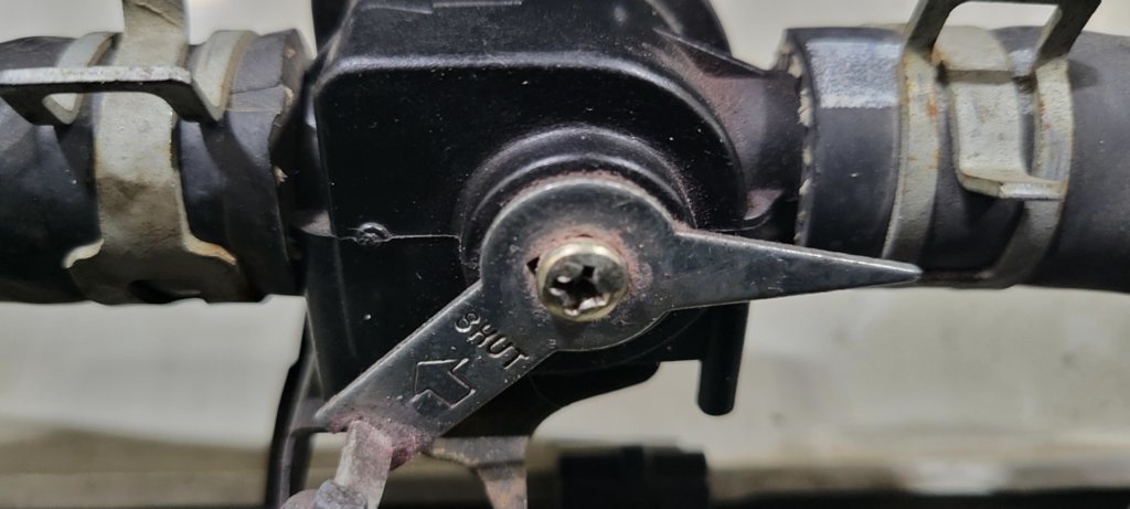

    Of the things these trucks need done this one of the easier ones. Not good to have that leak/failure, but better than the trans fluid milkshake that you can't see....
    If your HVAC heat control knob is hard to turn (like mine was) sometimes the cable wont open the valve all the way. Here is what fully open, and closed looks like on the valve on the firewall. You can move it by hand if it's not opening up fully.
    Shout out to @whodatschrome for those HVAC parts! :fistbump:
    OPEN
    CLOSED
    Pretty self explanatory, but making sure that valve is fully open makes a big difference.
    Good luck with the radiator coming undamaged!
