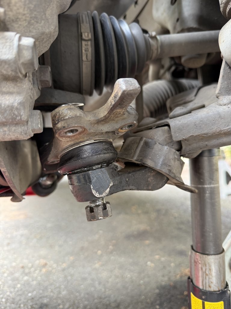

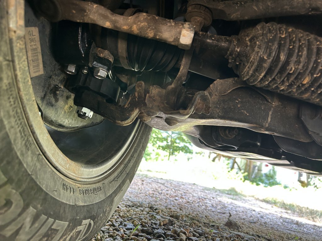

    Ok, I can’t get this damn thing to budge. Even put a jack under the A arm to get more room to swing a hammer. Threads are already fucked so it’s not going back together and I need it on the road tomorrow.

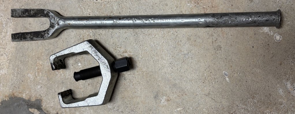

    Pitman arm puller. If it won't pop naturally with a ratchet, hit it with an impact. Or skip the shenanigans and go straight for the impact, which is what I typically do with pitman/idler/LBJ.

    I dunno if they'll have the same one I have, I don't remember where I got mine. But the top ears slide right over the LCA. If it's a cheap part store one, and the fit isn't tight, you may want to clamp the sides of the arms so they can't spread. Then crank on the mandrel, it should pop free.

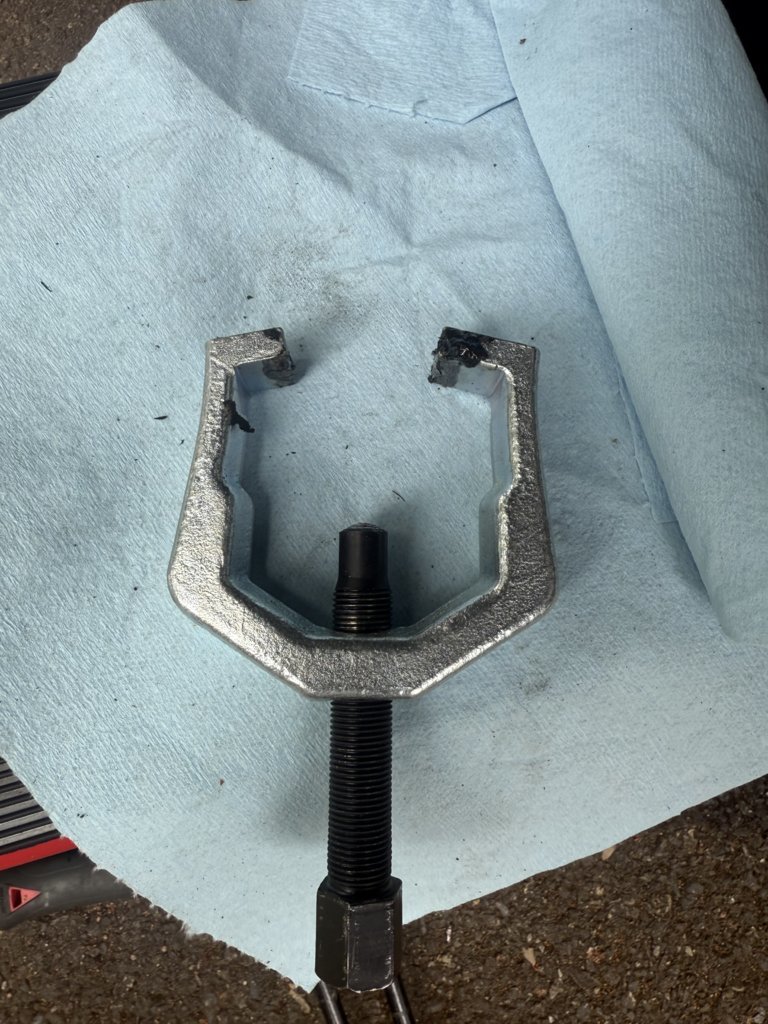

    Just went through that today. Like shifty said pitman arm puller. Mine were so tight I mushroomed the end of pitman arm puller. Tighten it up as much as I could then hammer on control arm, then repeat.
    Rented mine from oreillys and they took it back even though I showed them it was basically ruined.

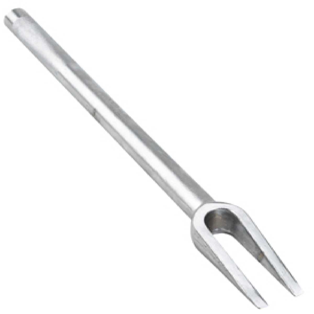

    I was successful with a pickle fork, but that’s just what I had, puller would be better.

    Get yourself a pickle fork. Every toolbox should have one. Popped mine loose in 3 or 4 hits with a baby sledge.

    This is why I was talking about clamping the jaws together, to avoid spreading. Keeping tension on it and whacking the end point of the LCA can sometimes help trigger release on other stuff I've done, as mentioned above. And I'd have reinstalled the LBJ to the knuckle before trying.
    Everything most people need for LBJ right here. Bob's yer uncle. Fork for TREs, pitman puller for LBJs. The puller on bottom here has popped my LBJ off on each side 3x now. But I'm not in a rust state, so it may be a factor.

    Hard to believe that it didn’t come out. The rust doesn’t even look that bad and I assume you didn’t have the weight of the spindle/rotor on top of it, did you? Still it really shouldn’t matter.

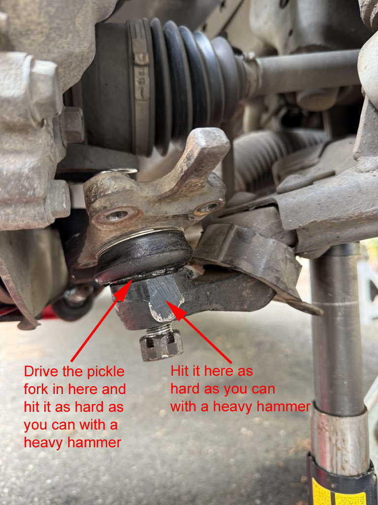

    First of all get the jack out from under the A frame. Jack the truck up, not the suspension. Then either hit it where indicated with a heavy hammer or, drive a pickle fork in where indicated and hit it as hard as you can with a heavy hammer, claw hammers won't get it done.

    Pounding on that spot did it. Thanks!
    The jack is just there to keep the A arm up higher to make it easier to work on. The truck is sitting on jack stands.

    I got the passenger side all finished. Started trying to pull the drivers side tie rod and that thing did not want to budge. I was pounding on the front of the LBJ where the tie rod goes through to the point that it was denting. I'm gonna order up the front end tool kit and do the other side later in the week or next weekend. Main thing was getting the truck back together today so I can use it in the morning.

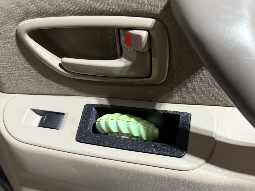

    Printed some inserts to replace the back door ash trays.
    They kids use it for their stuff since they are a bit young to smoke.
