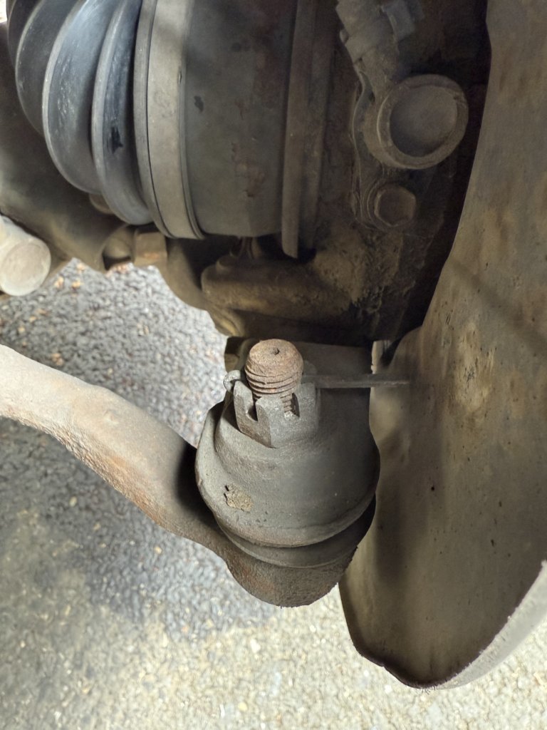

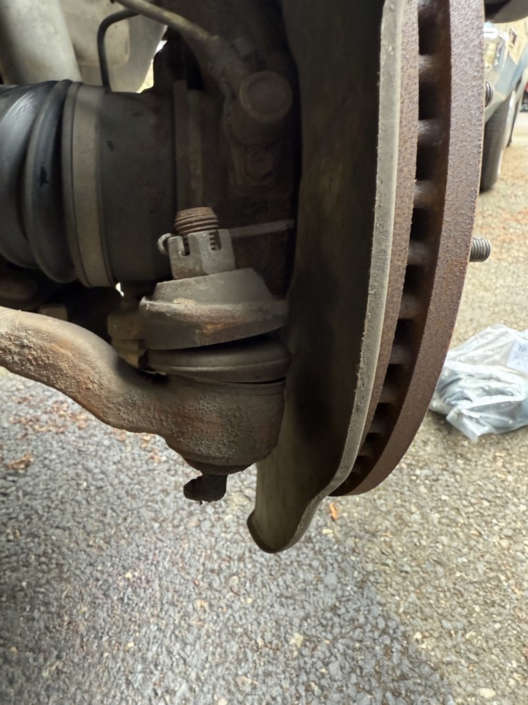

    Here goes. I’ll post up when I finish or get stuck.

    Fucking A for effort on that cotter pin.
    I don’t remember seeing grease fittings on the tie rods before.

    Those are reusable cotter pins.
    nothing looks terrible, but kudos for preemptive maintenance.

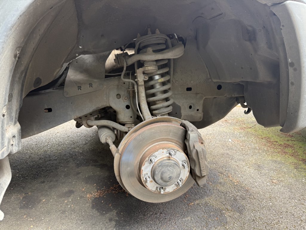

    Been banging on the LBJ bolt in the A arm for probably a good 45 minutes now. Damn thing won't budge. If I do give in and go over to the auto parts store to rent a tool, which puller would you recommend?

    Try banging on the circular part of the knuckle around the bolt instead of the bolt
