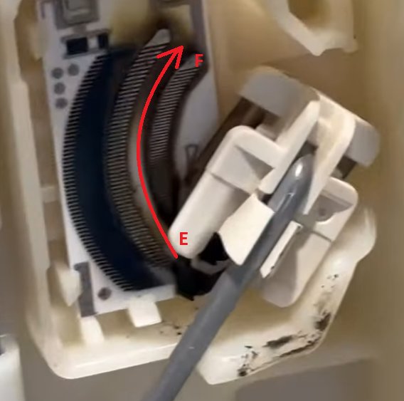

    Right, only saying, the resistor is a single-wire to the top of the pump, and works on a slide-based circuit, so any impact to the wire will make the resistance die off. Impact to a wire would also make the pump slowly fade and die off too. Both route thru the same connector. Hear me out for a sec.

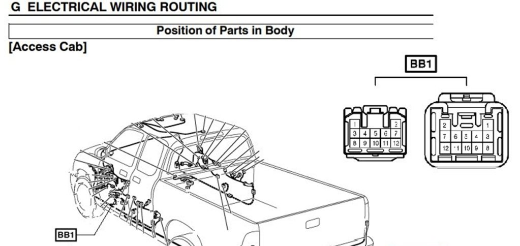

    Fuel pump relay has two legs coming off it, one direct to pump, one thru the fuel resistor and over to the BB1 connector (12-pin) under the driver's seat, then over to the fuel pump, which I think has a 5-wire connector (F10, it looks like, p/n 90980-11077).
    Weren't you doing truck stuff under the seat recently for stereo? Do you think you maybe disco'd or maybe pinched the wire harness that feeds the fuel pump, which connects somewhere under/next to the driver's seat? Didn't you have the driver seat out recently to do that stuff?

    Stealing images from @BubbaW for a sec to show you where that connector is, vaguely. Will try to find a pic for you since you're on the road. This is the main bulkhead the fuel pump and fuel sender route through.

    It wouldn't impact the fuel pump sender, making the gauge change its level.
    IIRC, the fuel resistor in our trucks (2000 is a bit diff't but similar from 2006) is a 1-wire lead going from a float slide on the side of the pump body/pump assembly. As the fuel float runs up and down the contact slide, it transmits different resistance to the gauge, depending on the slide level. The gauge needle in your dash is a glorified resistance meter. Sometimes the slide gets corroded spots along the length, and nothing will transmit back to the gauge when it hits those spots, which is when you'll hear people say stuff like, "It's weird, every time I get to 3/8 of a tank, the tank will randomly drop to E, then come back up when I make a turn!" or simila.
    In some cars, on some fuel pumps, the float literally sits on a rail, and slides up and down the contact. On others, the float is at the end of an arm, and somewhere near the pivot there'll be something running along a contact. There aren't a ton of styles on the design, but many work the same way, i.e. you have some kind of circuit contact surface, with a float that rides on topof the gas, making something metal ride up and down the contact.

    @Nimitz_ here is an example out of a Sequoia, which won't be identical to all 1st gen pumps, but it's close enough. Pay special attention to this part of the video below, this is the "slide" I'm talking about, which feeds resistance to activate the gauge in your dash. As the float lifts/lowers, it slides across this circuit path, which can ultimately wear out with time, or get "dead" spots in it, and a dead spot would make the cut out (read "E") suddenly. But it would take another event entirely to make the gauge slowly taper off, like the slow loss of signal (slow drop to "E") @KNABORES is drescribing. Even if the gauge went to "E", this is a resistance based circuit, one which (I don't believe) has any link to the fuel pump's power lines, so it going to E shouldn't cause the pump to cut off either.

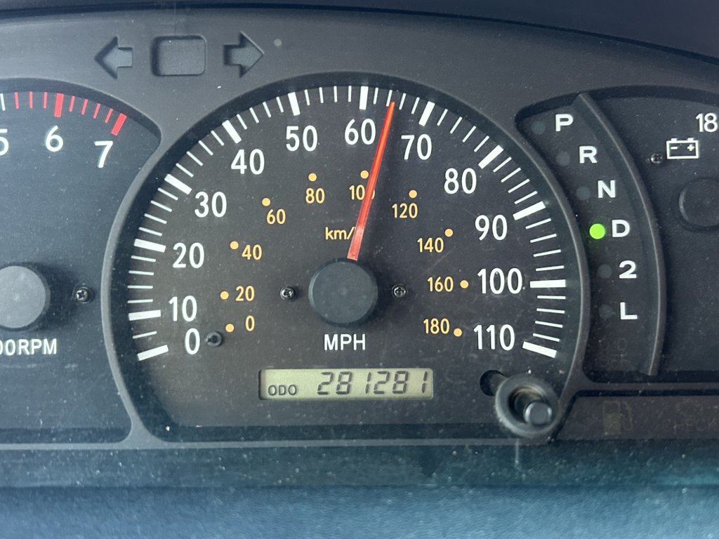

    In lighter news, still chewing through the miles

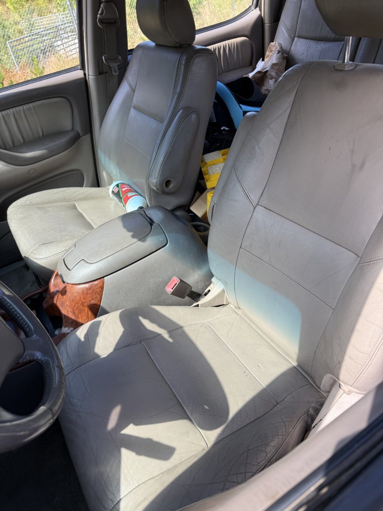

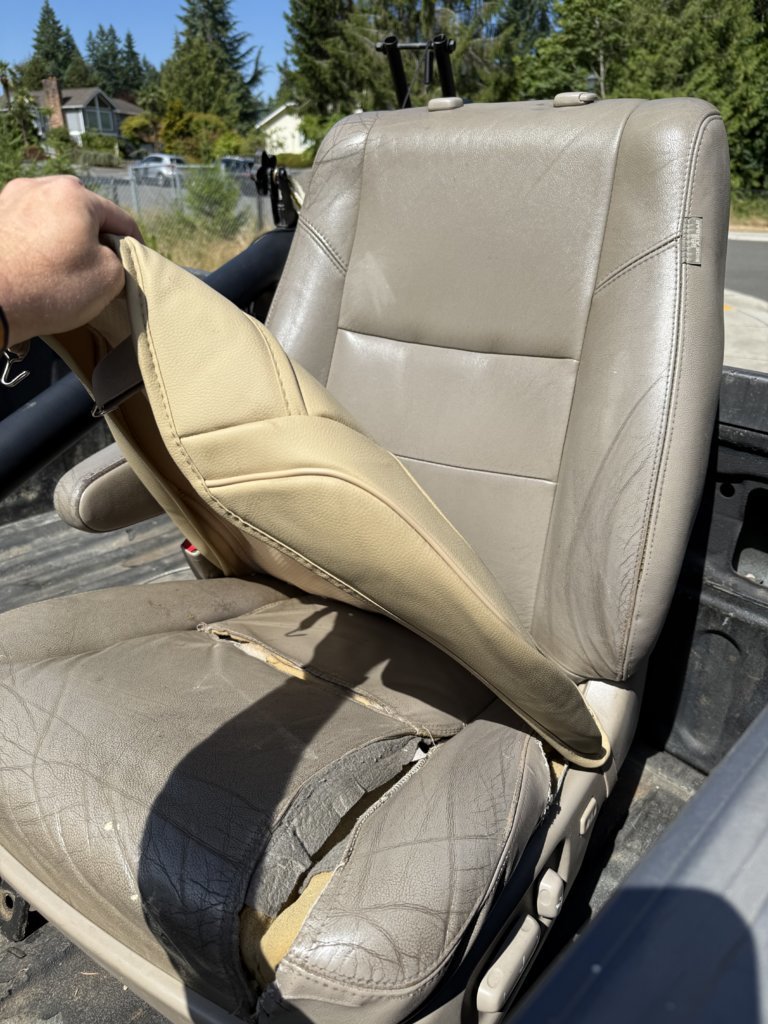

    Upgrade for my sweet sweet ass. Swapped an 01 sequoia seat into my 06 DC. Airbag connector is the same but the sequoia seat is missing a few adjustments and heaters so the connector is different. Fortunately the person that owned it before me was relatively my same height.
    New
    Old
    I also discovered the source of the interesting smell in my truck. My carpet cleaner is regretting the day it was born.
    Stank
    shifty` and The Black Mamba like this.

    Well the seatbelts are different so she may go back to the street corner I picked her up from.
  30. Jul 14, 2025 at 11:44 AM
    Kimosabe
    Kimosabe Slacker
    Jul 28, 2020
    #50004
    1,263
    Sun Valley, Idaho
    06 Tundra DC TRD 4WD
    W.I.P - FOX 2.5 with DSC, SCS F5 wheels with MT Baja ATZ 285s
    Can you grab the buckles from the wrecked sequoia? Or swap yours over? That should take care of that.
