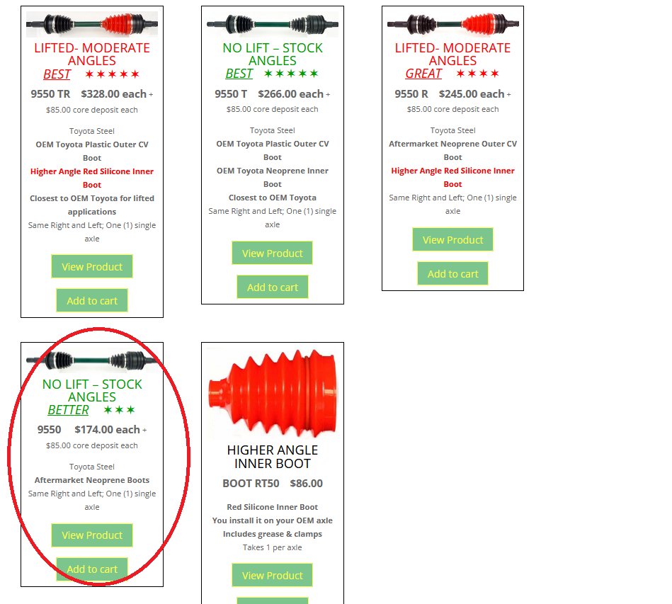

    for those of you that have purchased CVJs axles which option did you go with? I have a 2 inch lift in the front and was wondering if its worth the extra money to get the oem inner boot vs the after market version that they have available.

    Previous commentary I've seen on here is, "If buying CVJ Trakmotive axles (sorry, got confused on brand as I mention below), unless you buy the premium, you'll be just as well off getting anything from the local auto parts store". Paraphrased, for sure, but the good axles start around the $400-600 price point.

    Except for if you buy cvj you have an OEM axle, no? Even if the boots arent great on the lower optioned ones?

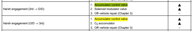

  15. Jul 2, 2025 at 5:59 AM
    The Black Mamba
    Sep 6, 2023
    #103472
    5,044
    BlackSnek
    Flower Mound, TX
    Black 00 SR5 AC 5VZ PreRunner
    Imma keep it stock

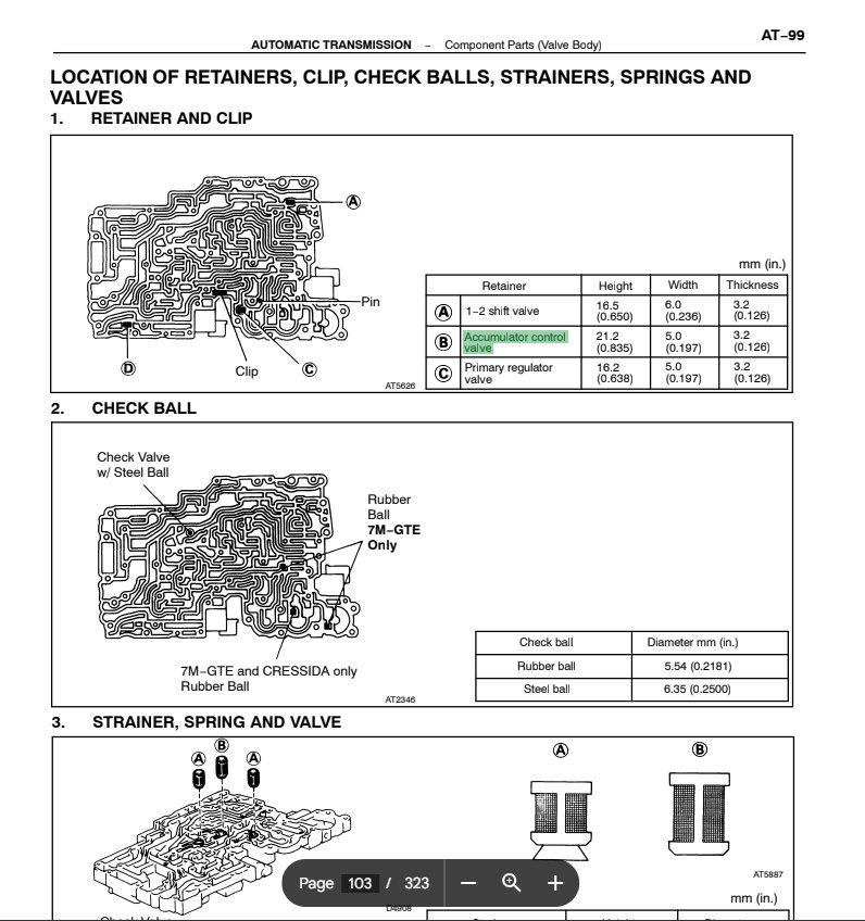

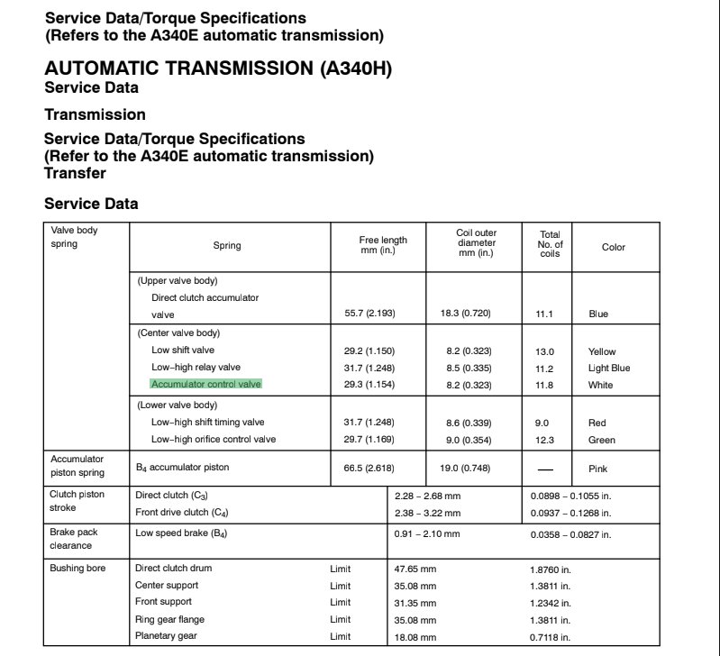

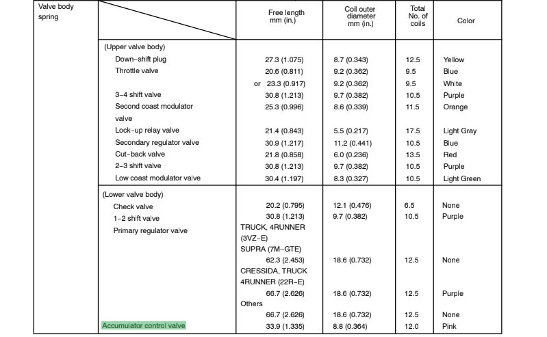

    Here's a link to my replacement and the info I gathered: A340E/F INFO DUMP | Toyota Tundra Forum
    Here is an excerpt from the FSM
    I don't have the A340 manual saved on my work pc. I sent a request to @Johnsonman for access to the link.
    shifty` and Mr Badwrench[QUOTED] like this.

    Good info. Thank you! If I can repair it, that would be much cheaper, definitely the preferred option here. My fluid is still clean despite its mileage and age. So hopefully it is just one bad part.

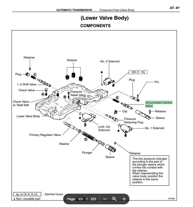

    I would need the repair manual to find out what "Accumulator Control Valve" is and what's involved.
    Mr Badwrench[QUOTED] likes this.

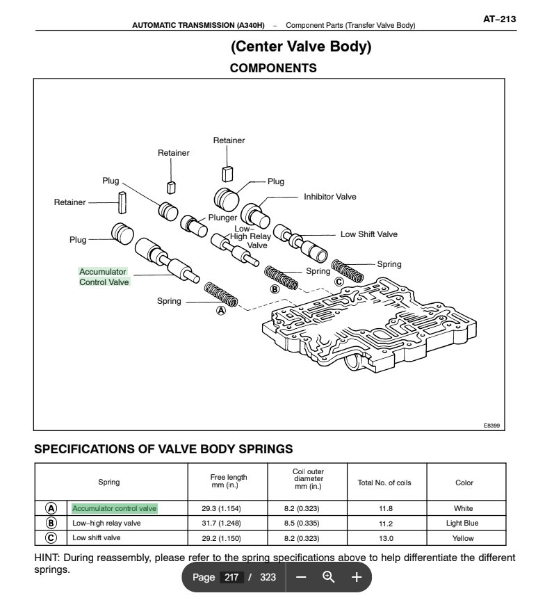

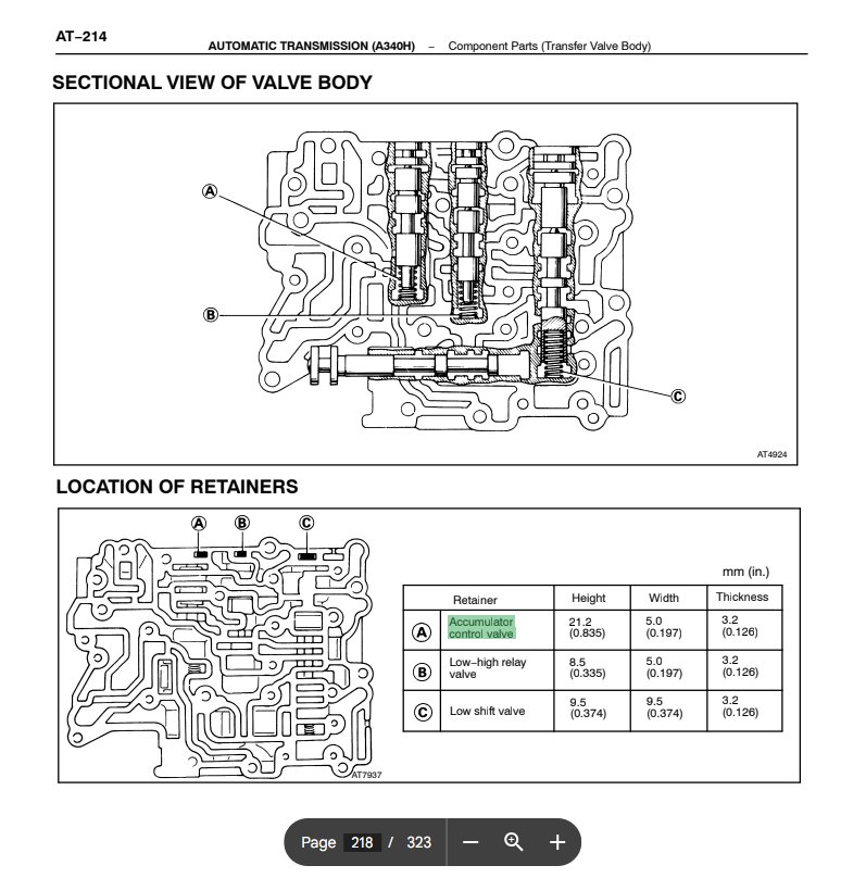

    Got it! Thanks @Johnsonman! Good news, the Accumulator control valve is inside the valve body. I'd pull the pan, filter, valve body and go after that first.

    When I bought those, I went with the "no lift" option. I think I did the neoprene boots. Those were on a AC with 3 inch lift. After 3.5 years of moderate driving the boots were starting to split, but otherwise they worked great. I would probably opt for the OEM boots.

    Yeah, CVJ are re-manufactured Toyota CV axles with fancy boots. I have a feeling the do/did just buy re-manufactured from Toyota and all they "re-manufacture" is the boot. Unless they have a contact at the Toyota company that produces the steel parts for the joint itself, I have no idea how they can re-manufacture using "original Toyota/Lexus steel", since the steel parts aren't available through a dealer.
    The one I circled in red is the only one I would personally buy, and I guess I'd give them the core charge too. I was previously getting reman'd Toyotas from the dealer for $150 each, core included. Guess I'm glad I stocked up on extras before Toyota stopped selling them.

    I'm team OEM boots as well, the Porsche 930 is the only other boot I'd run. Even with my driving style, the stock boots get plenty of life. Since I have a stock of Reman axles, I just swap one out when the boots are done for. Eventually when I need new boots on all my CVs, I'll knock them all out at once.

    Anything except Porsche 930 for high angled boots is not worth it in my eyes. CVJ's boots are a ridiculous amount of money, even if grease/ clamps are included. Porsche boots are cheap and have been proven across many applications.
    Even with stock boots, you can condition the boots to prevent cracks and even put petroleum jelly between the fins of the boots to reduce friction. For the latter, I would clean and reapply after driving through mud/ elements so nothing gets stuck in there.

    I'm about to try out the porsche boot. I have 3 oem axles needing rebuild and will test out the porsche boot.
    @PNW15 the porsche boot seems to be the best price for a high angle boot. My opinion, but I didn't want to spend $80+ just for two inside boots.

    A sincere "Thank You!" Black Mamba. If I can pull this off it will save me big $$$.
    Everything is a rusty mess under my truck, and just taking mental inventory of the things I would also have to replace while stabbing a transmission (entire new exhaust, rubber mounting components, refilling lubricants etc) .... it was going to be a big expenditure.
    This helps immensely.
