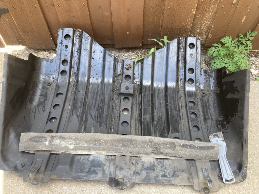

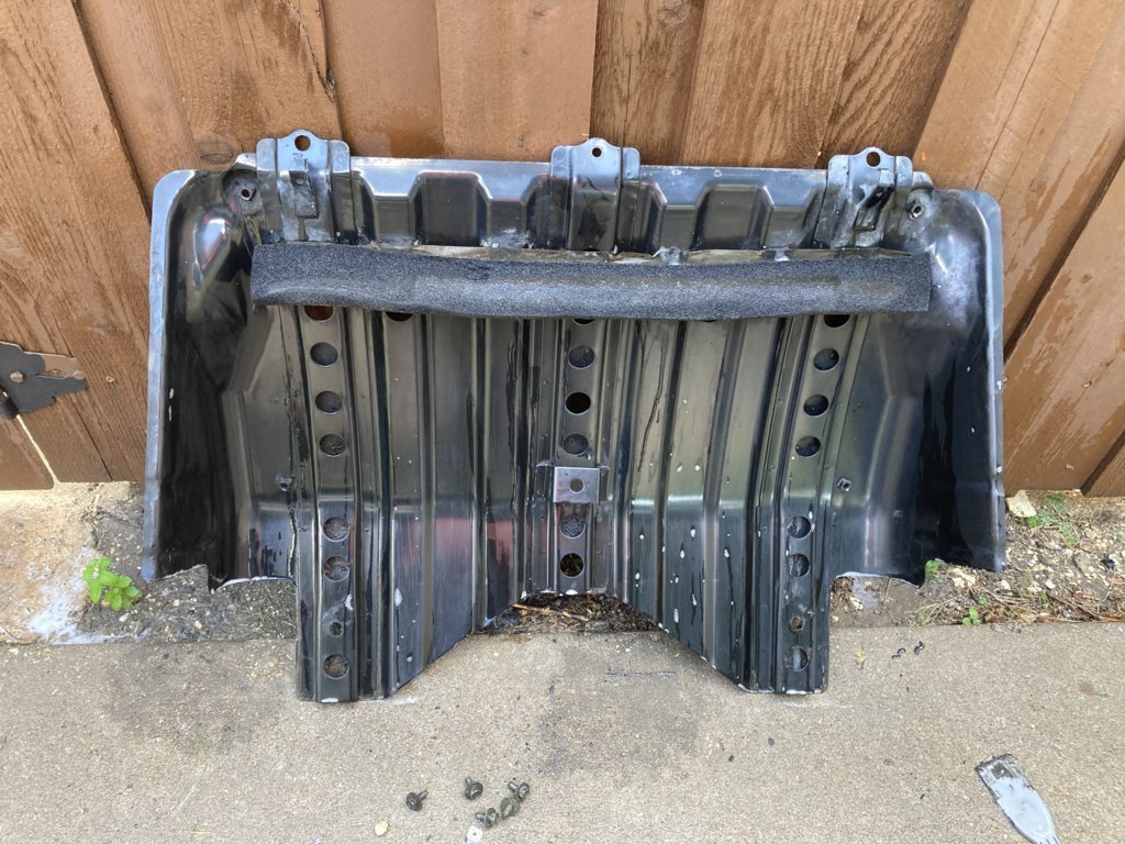

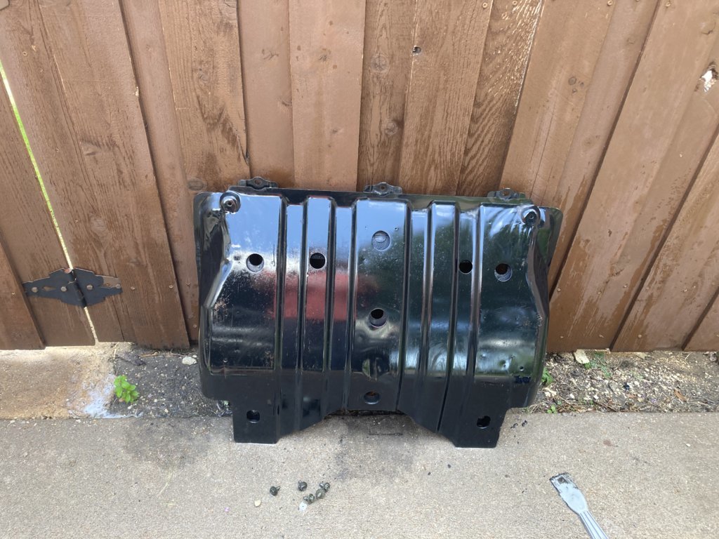

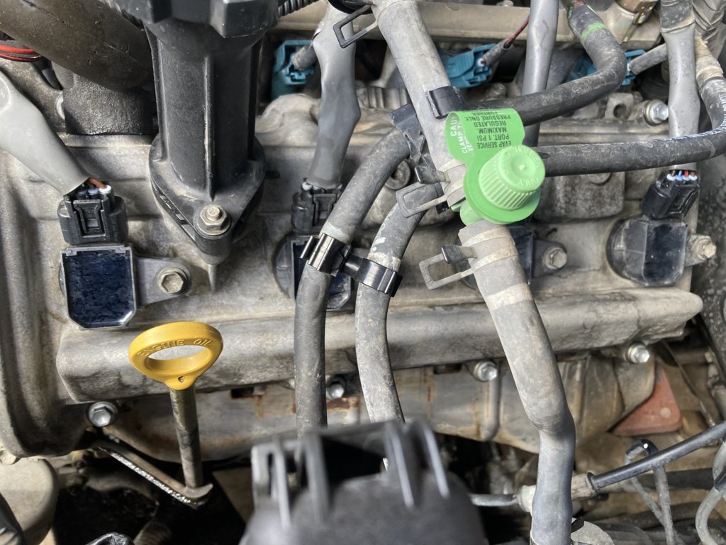

    Cleaned up the engine bay, and skid plate. Skid plate was coated with basically soft asphalt - oil and dust. Scraped it off with a plastic scraper and scrubbed with dish soap, then gave the outside a coat of wd 40. And now I’ll be able to actually see oil leaks. Valve covers are so much cleaner. Not a detail job but for free in an hour, not too bad. And the best part about Texas summer - just leave it in the driveway with the hood open and it’ll be dry in 20 seconds.IMG_2080.jpg IMG_2083.jpg IMG_2079.jpg IMG_2082.jpg IMG_2081.jpg IMG_2084.jpg IMG_2085.jpg

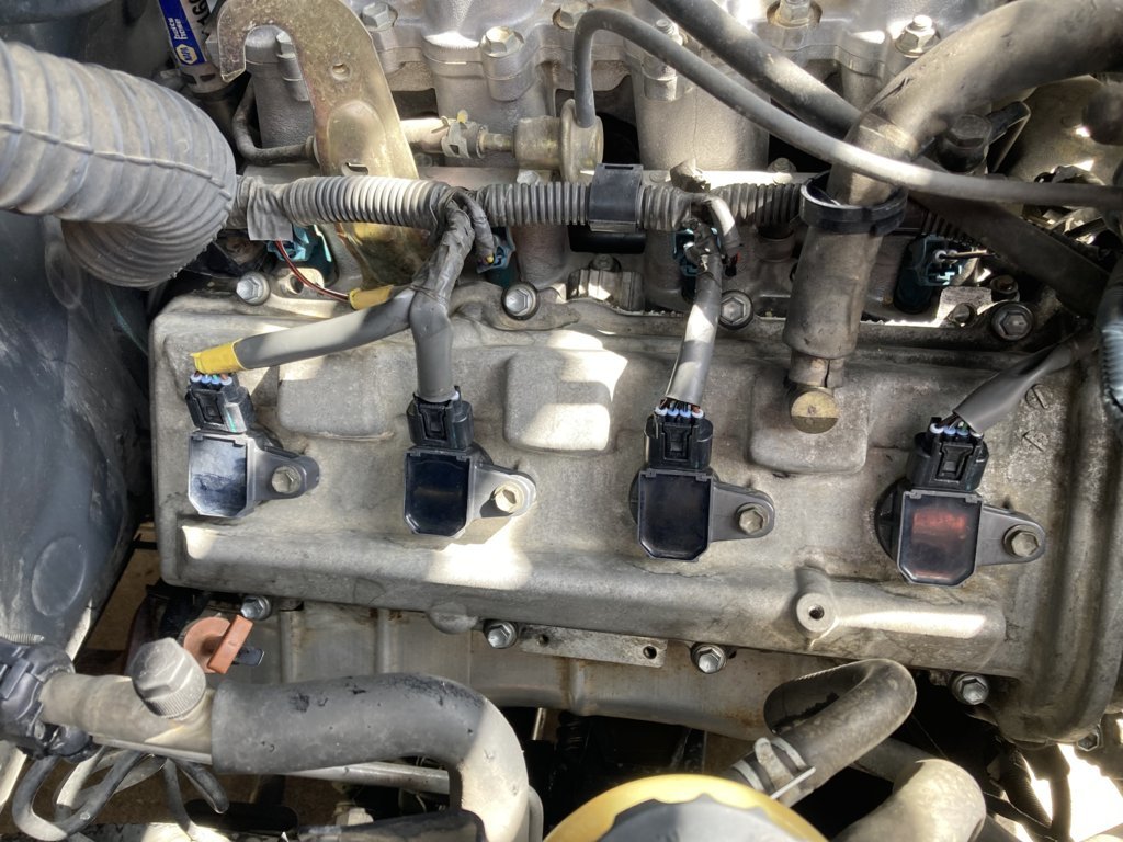

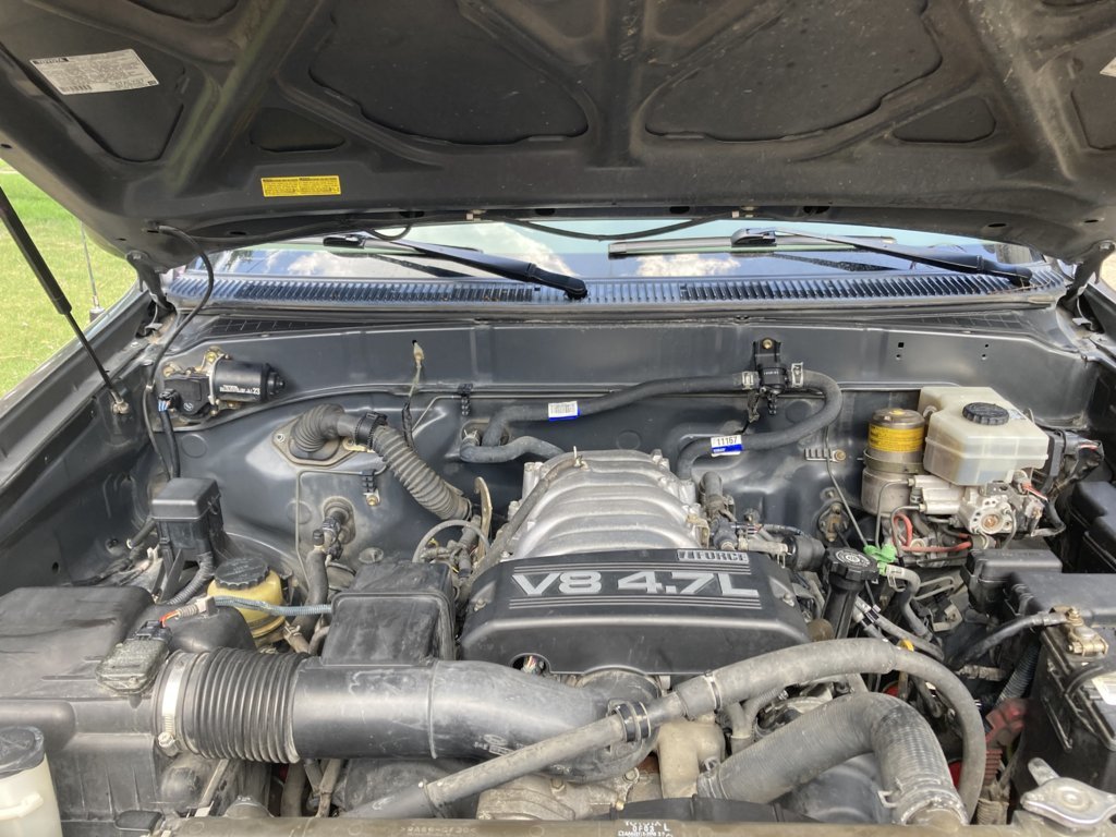

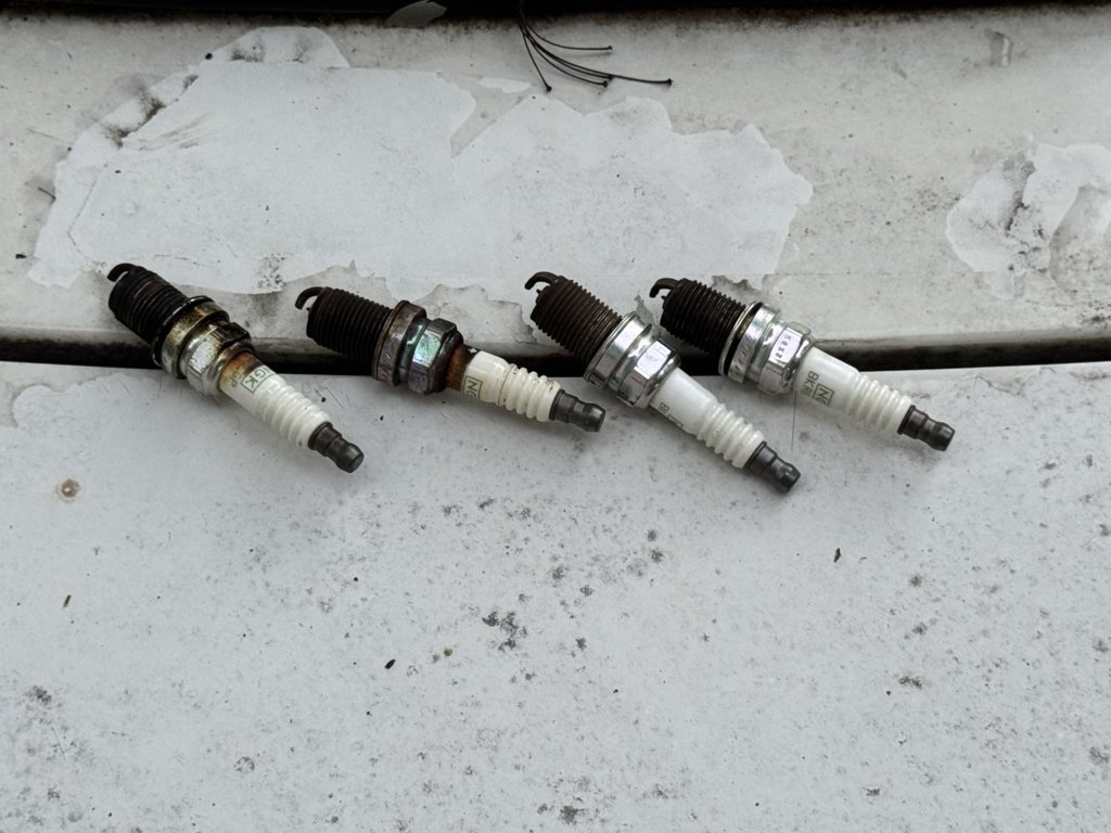

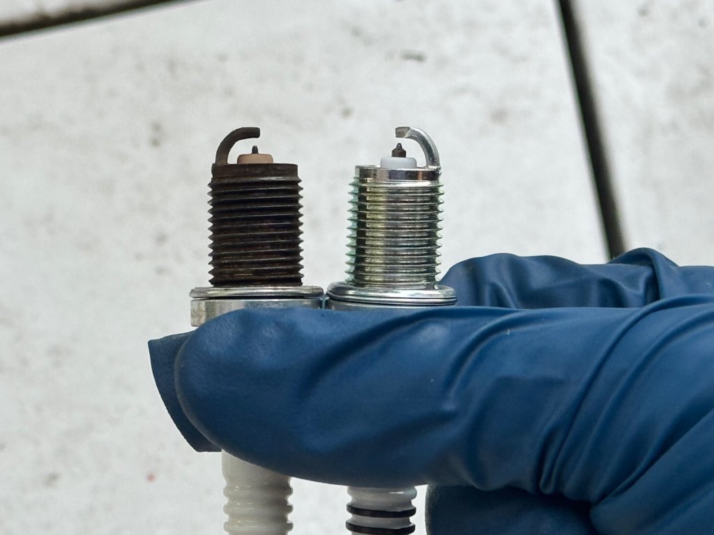

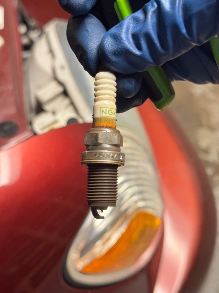

    Replaced spark plugs today. Truck is new to me with about 133k and no history of spark plugs, so wanted to go ahead and replace them. Seeing the old ones I felt good about it.
    The old ones were NGK BRK6EGP platinum plugs and I went with the iridium ones. Old ones were finger tight at best, and a few were quite gunked up.

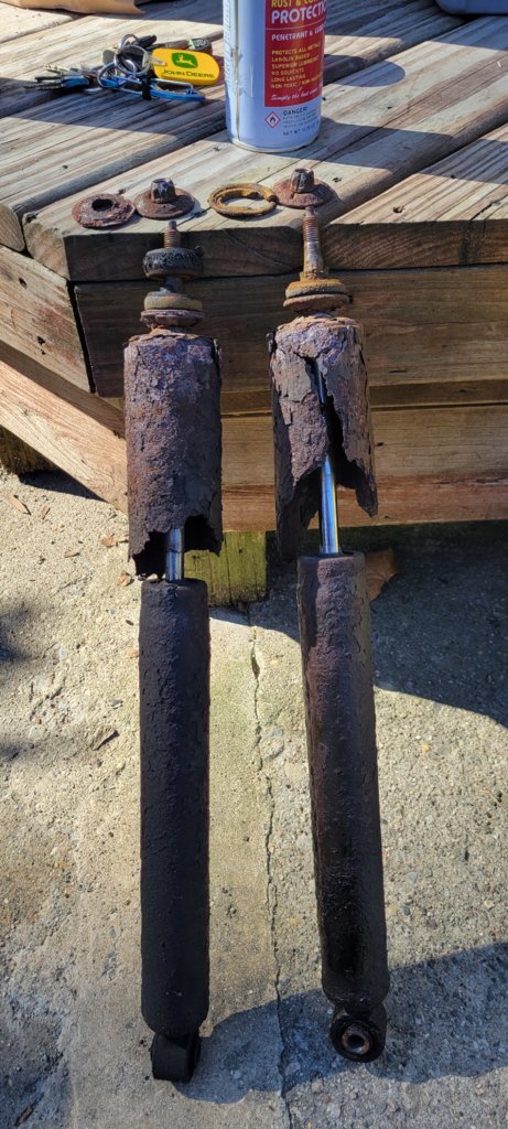

    Quick followup on the struts. I was very wary of pulling that left side out. The only thing keeping the spring compressed is the strut and given it's condition I was in no hurry to yank it. What I did was, I have a bunch of 24" industrial 500lb zip ties so I put several of them around the spring figuring if the strut left go at least it wouldn't shoot thru the fender. As it turned out it came out ok but better safe than sorry. I have no idea, only a theory, if it would work but there weren't a lot of options. First time I've seen a strut that bad.

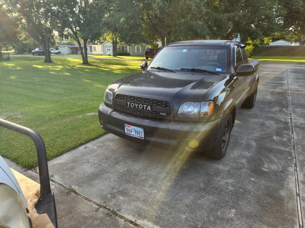

    My black 03's roof was pretty rusty. So I wiped it down with a handful of armor all wipes. It was so hot out, I could watch the alcohol evaporating off my roof.
    I had some partial Rust-Oleum self etchging primer and matte black spray cans in the garage. I was able to do two coats of primer yesterday and one coat of black this morning. It doesn't look great, but it beat the rusty look from before. Will have to buy some gloss black next week.

    It’s for the rest of the truck’s dull shine that isn’t rusty. Black glossy paint is going to stick out like a sore thumb.
