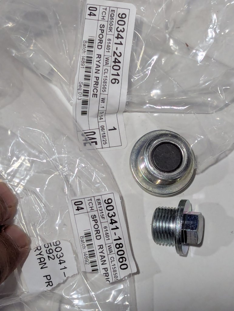

    Bought some stuff drain and fill.plugsthat don't suck the 10mm Allen is soaking atm. Hope that helps it come the fuck out tomorrow without heat.

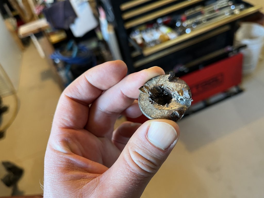

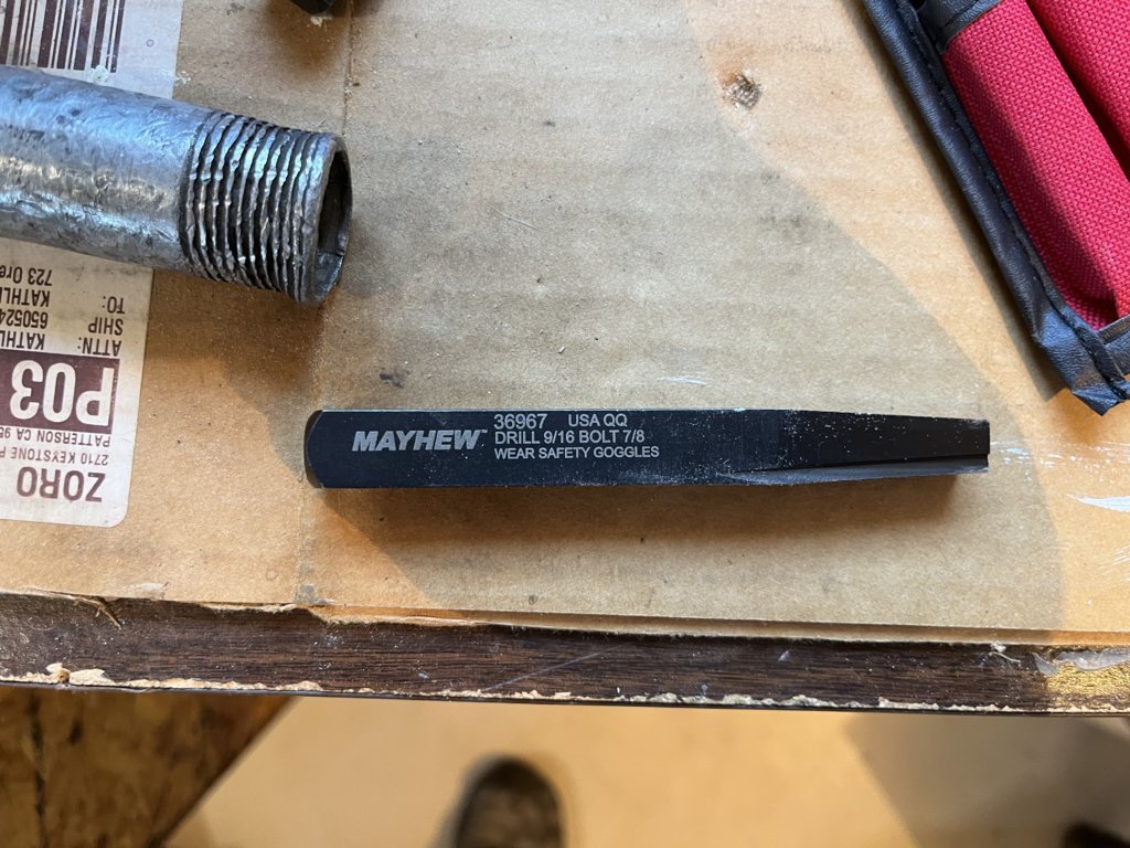

    There are some tools that make those easy, if they're stuck. This got mine out in about 10 seconds, after multiple tries with allen key, heat, cold chisel.

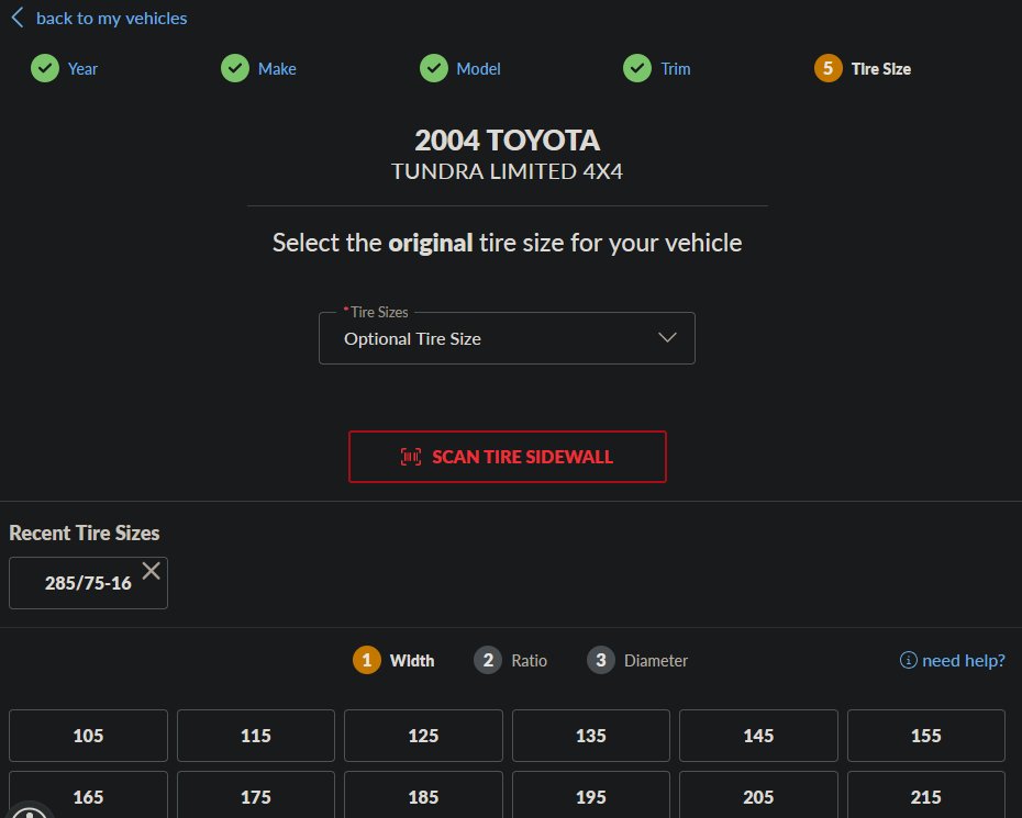

    If you get to this menu when you add your vehicle, you should be able to add an 'optional' custom size. I ordered my last set of tires online through DT because they had a rebate.

    Woof! Mine wasn't near that bad. After a lil heat and tapping the 10mm Allen socket in, jack up front for more leverage/ room it came out. I thought for sure it was gonna strip, bleed me and shit would go flying. Fuck those plugs!

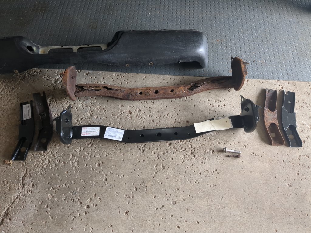

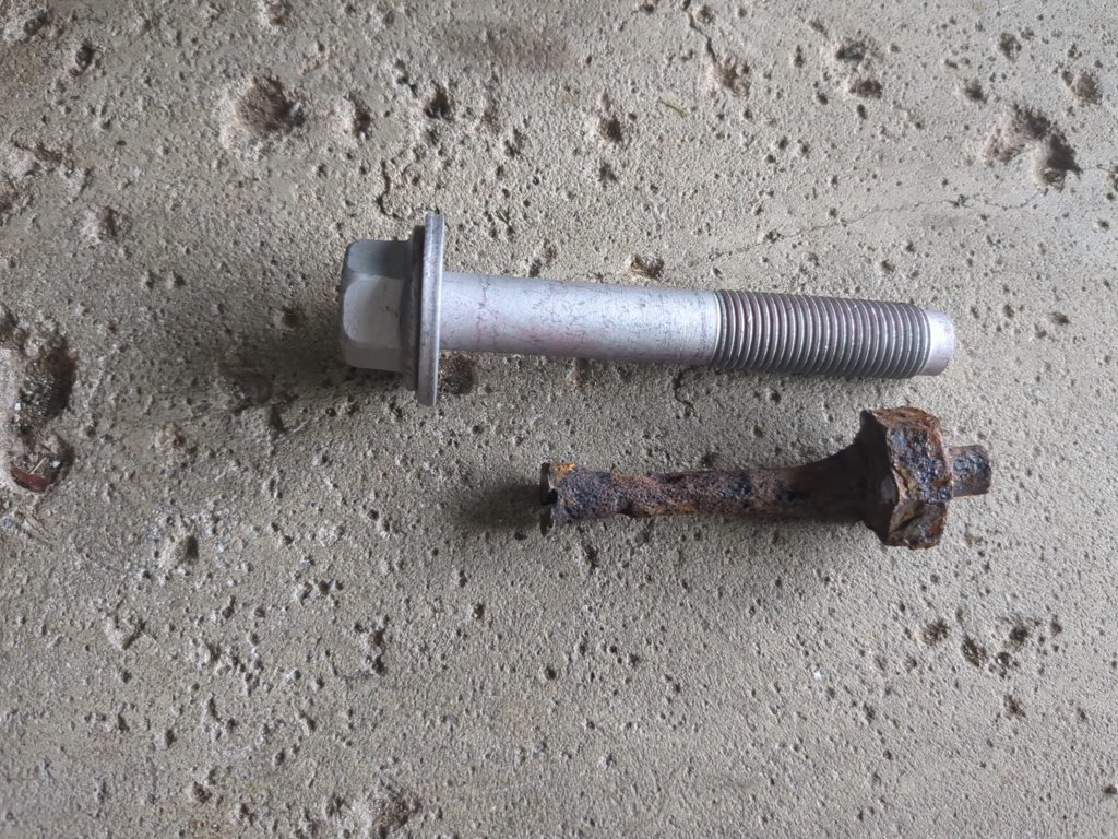

    Oh, so that's what that bolt is supposed to look like (this was the better of the two bolts connecting the hitch to the reinforcement)

    Jeezus man

    whats the rating on that ‘hitch’? & is the receiver a separate part?

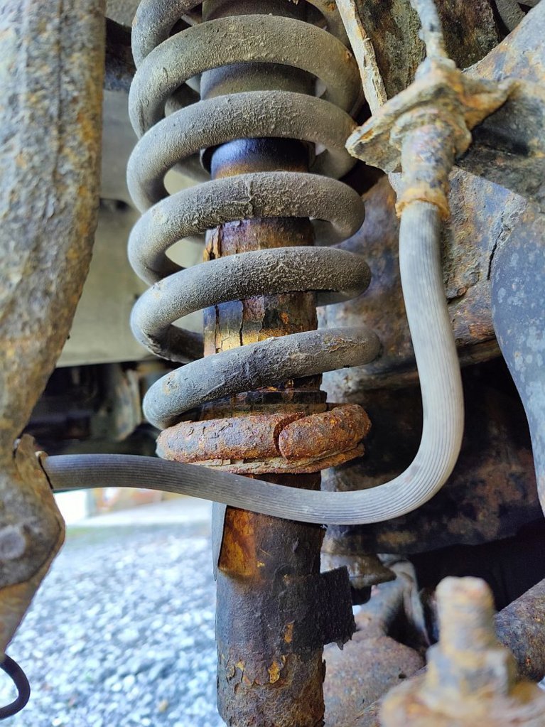

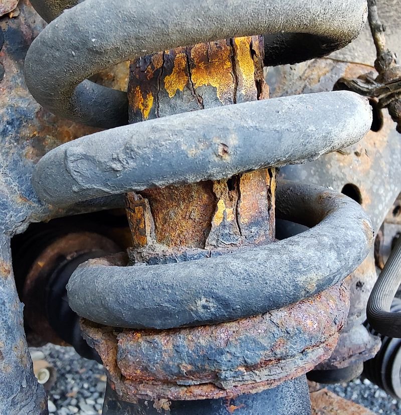

    Today is front struts day. The first 2 pics below are from the driver's side. Note the broken spring. According to the repair records back in 2016 a dealer replaced both front left & right CV axles, upper & lower ball joints, lower control arms, sway bar links, and the driver's side outer tie rod. I'm going to go out on a limb and and say methinks there was a LBJ failure and I think maybe the spring was cracked then but went unnoticed. What is just as troubling, however, is the strut. That baby has chunks missing.

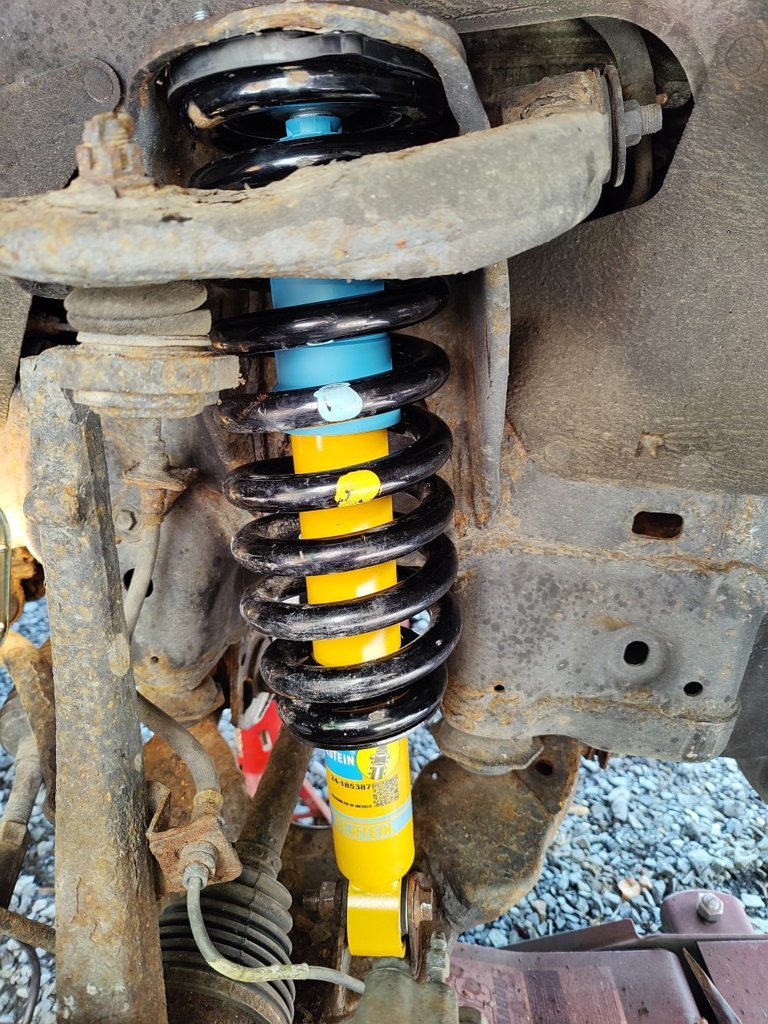

    Here's the new stuff on the pass side.

    I can’t believe I’ve seen a more delapitated shock than that. You were driving on it and the broken spring?!?

    Wonder if there's even any oil or anything inside that thing still

    @CC80guy could easily lose a filling or two going over a bad pothole.

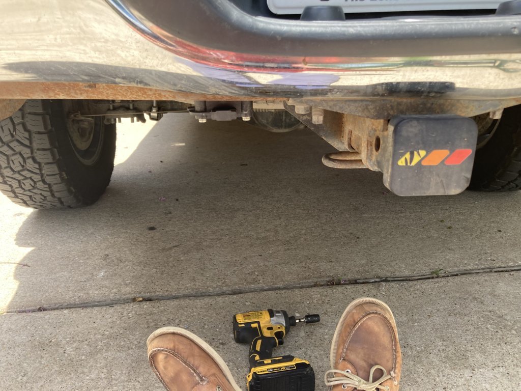

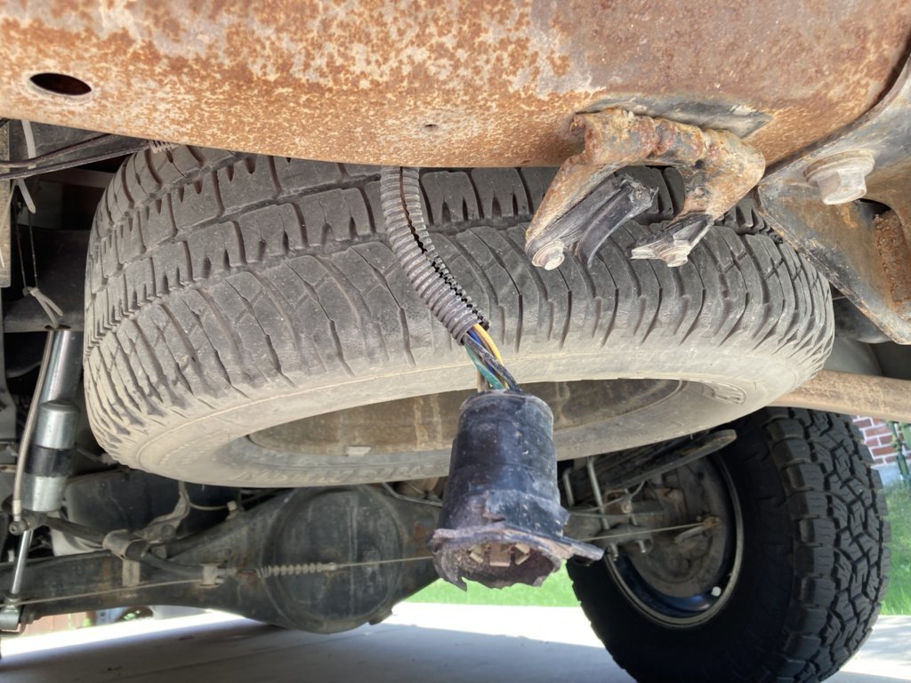

    Finally fixed my trailer plug that I bashed off over a stump. I’m not really doing much towing but I replaced the old 7 prong with a 4 prong. Didn’t know it would be a 4 prong when I ordered it, but it works out because that’s probably the only trailer I’d end up towing anyway. It’s nice and discreet. I like it. See below before and after.
    Also cleared my p0430 code by driving around so that’s good. Gonna add some cataclean at the end of this tank of gas for good measure. Weird that it happened in conjunction with the valve cover gasket swap…
    And tightened my suspensionmaxx sway bar links. A lot. The popping noise when going over bumps or turning in the rain has continued since I put on my lift. Last few days it has been doing it in the dry too. So I tightened them down like a normal bushing situation. I remember the instructions saying not to tighten them too much, so I did that, but it seems weirdly loose. Whatever. If I have to buy new bushings in a year cause I screwed these up, I’m fine with it.
    Wiped off some oil and grease underneath from all the mods and maintenance I’ve done lately. And I’ll probably do the engine bay later today. I think I’m just gonna go hose and dish soap and brushes.
