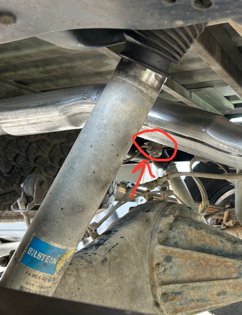

    Also wanted to mention that you have to drop the spare tire to gain access to bleed the LSPV. Others may have done it without dropping the spare tire, but this was not the case for me.

    I’ve not had any problems bleeding mine in a 2000 AC with the spare in place.

    Location as viewed from the passenger side in front of the rear axle looking towards driver rear (old picture)

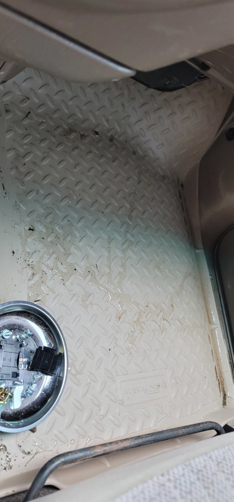

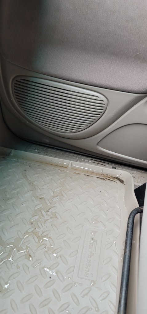

    Went to drive the truck today after a couple days of on-and-off rain. Looking like I have the cowl leak going on. Water pooling up in the passenger side floor board only, doesn't appear to be coming from anywhere overhead or A pillar, windshield, etc. and more likely coming around the the blower motor area above the footwell.
    Referred to the sticky already https://www.tundras.com/threads/definitive-2000-2006-cab-area-rain-water-leak-thread.70464/. I'll have to go ahead and order the parts referenced in there and get this taken care of.

    Adding to @KNABORES ’ already great post here to say: The reasons bleeding the LSPV is important are many. But one big one is, it sits higher up than any other point in the brake system after the cab, so guess where air is gonna go if it enters the system anywhere after the cab, or at the rear bleeders?
    Not to say there aren’t other reasons. It acts as a limiter/pinch point for the rear drums also, and old fluid, crud that builds up in the lines, all that is more likely to get jammed up in a bottleneck like that. You really want clean juice pushed thru it.
    Really, I disagree (despite parroting this method in the past, before bleeding my own truck) with the recommendation to do the farthest wheel (rear passenger first), then LSPV, then rear driver, passenger front, and driver front. It makes more logical sense to me (note, I’m by no way the authority here!) to bleed the LSPV first, to get fresh fluid to the rear of the truck, THEN bleed the passenger rear, then the driver rear. This way, you’re pulling any bullshit out of the lines up to the LSPV, any air from the LSPV, and getting a clean supply to the farthest corner. I can’t think of a reason why this method is inferior in any way.
    If our trucks were 4-way discs with no PV at all, direct-plumbed from the ABS squid to the calipers, YES, I would do passenger rear, driver rear, passenger front, driver front. But given the bleedable LSPV back there, I don’t see the logic in doing the passenger rear before the LSPV.
    Honestly, I’m going to step out on a limb and say something maybe controversial here. I would follow the Professional Hand Model method to apply a paint-safe sealant and reinstall the two offending fasteners, because the new Toyota part simply adds a tiny piece of foam that some members, like @NickB_01TRD (I think?) found will ultimately tear again with time.
    If you do choose to order fasteners for feet of the plastic breaking, as it is old, and they do break, let me tell you:
    • Only order two, remove their foams, and use a paint safe sealant to seal them in without foams
    • Order at least half a dozen of both the black snaps and their white sockets, because you are almost assuredly going to break two or three of each when you pop the cowl.
    • Be prepared to spend 1-2 hours on the job, if working leisurely, you will probably find a lot of buildup and bullshit under the cowl that needs cleaning.
    Honestly, I hit up a 25% off sale and got new OEM housings. Hindsight being 20/20 as it tends to be, I wouldn’t do it again. This is one of those times where you’ll get as much life out of two CAPA certified housings as a single pair of OEM, and still pay less for the CAPA aftermarket’s.

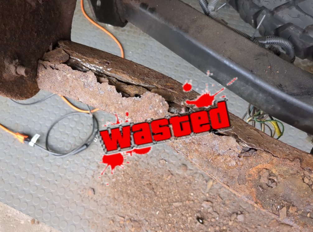

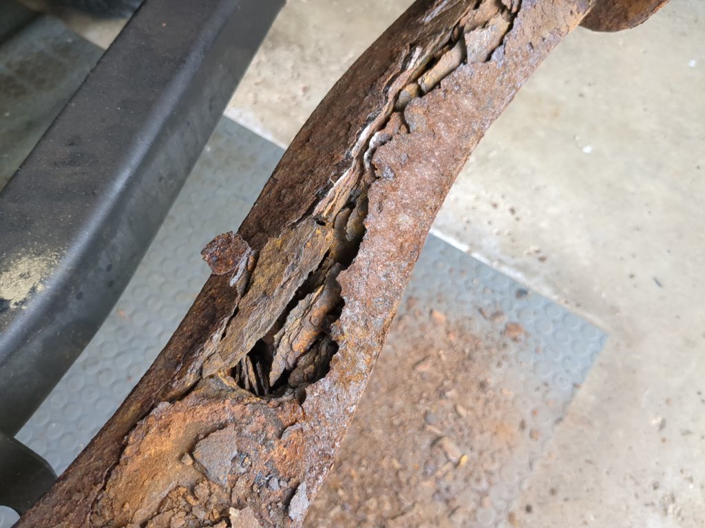

    One reason is if you live in the rust belt. When in the rust belt, never try to remove/loosen something you don't have to.
    In related news, ban road salt.

    You can probably break that apart with a hammer.

    To be fair….
    The OEM tow package support is notorious for rusting all to fuck, even happens in California trucks.

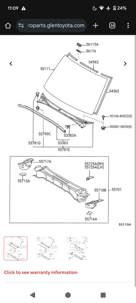

    Thank you, I will heed this advice and was already planning on just ordering exrta clips. have a knack for always breaking any type of clip/push pin that ever needs removed

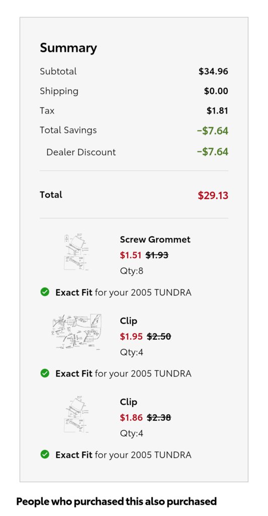

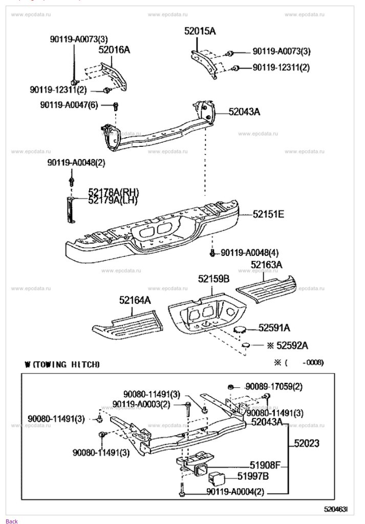

    Coincidentally, today I almost asked a few of the very questions about required number of cowl fasteners and other related fasteners that you just answered here but rather than wait for a reply I just ordered. I am considering using some butyl rubber rope/tape without foil backing that I already have laying around to make butyl rubber gaskets to replace the foam gaskets. So rather than tape over like PHM, the butyl rubber would be under the head of the fastener. Do you think this will work?
    I ordered 8 of the cowl fasteners because the diagram suggested I needed that many. Sounds like this may have been overkill.

    Not a mechanic by any means but could one drill that hole out, completely removing the threads, then re-thread for a larger bolt?

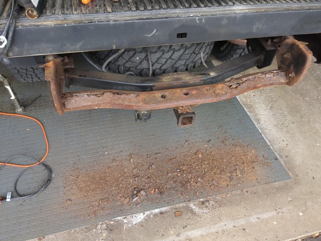

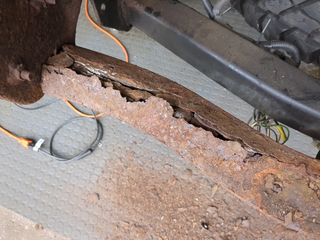

    Well today I did something truly substantial to my Tundra......I tore off a piece of blue painter's tape and stuck it to the driver's side of the windshield where the glass touches the roof. I couldn't find a marker but when I do I'll mark "Next oil change at: 204,000 miles."
    That's about all the free time today I had!

    Sketchy street barnacle
    That looks like it got completely full of water and then froze... a few times over. :eek2:
    I'm with you in the battle :fistbump:

    Mine is fairly rusted also but is holding fast so far.....
    I might try to remove it at some point, after I source a replacement. :)

    That tow hitch doesn’t surprise me one bit.
    Salted snow always gets caked up behind the rear bumper and rarely gets washed due to its hidden nature and not being in the direct path of an underwash spray at the car wash.
    I’m guilty of not crouching over to get the crap in behind the rear bumper myself.

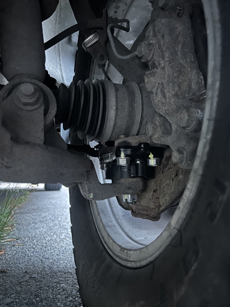

    Had a bit of free time before heading to work this morning, banged out the LBJs. Nice driving the truck now not having to worry about driving over my own wheel haha.
    Attempted to install the Timbren bumpstops this evening and couldn’t even get the nuts off the U-bolts as they’re completely seized. Soaking them overnight and I’ll try again tomorrow.

    It was me, the new parts are junk. @Dblock500 it doesn't hurt to order more clips. I had some that were broke and some that wouldn't really tighten up and I wish the first time I pulled it that I had just replaced all of them. I now have enough to replace the rest but I'll wait till I have a reason to pull the cowl again and I'll replace.
    I'm always worried mine looks like this though I would think they would have said something during my frame replacement if it looked this bad. I probably need to pull my bumper and take a look at it since I tow fairly often.
    What's your plan to replace? Isn't this part getting hard to find?

    My frame was done in 2010 and the truck hasn't seen salt since 2014, so I assume most of this damage was already done.
    The part for my truck is 52043-0C010 and it was still available. Oddly, it doesn't match what the parts diagram shows for a truck with the factory hitch - mine looks like the upper one rather than the lower.
    I wouldn't pull the bumper cover unless you're already planning to replace. The four bolts on the bottom came out ok (surprisingly), but I broke just about every other bolt.
    Not sure how much extra support it really provides since there's only the two bolts going down into the receiver (90119-A0003), maybe mostly to help support tongue weight? In any case I'm not interested in finding out.

    Yeah I'll order 8 of the clips too and just replace them all but only 2 of the passenger side foam fasteners causing the leak--that's the total number that's on there right? Its always hard to tell with these half-helpful Toyota diagrams smh. I haven't ever opened the cowl yet, but I suspect that would work if it is a thinner rope. I have some butyl tape laying around too when I was sealing up my camper but I believe that was 1/4 inch or maybe half? I also have some clear waterproof sealant from my 3rd brake light that I was just going to use to re-enforce the outside seal of the foam gasket clips like you and shifty mentioned (aka the PHM method apparently)
    Where'd you order from? I'll order from my local dealer just so I can get it next day but pay the premium they charge for any little part (soo irritating how expensive this dealer is with ANYTHING)--My recent orders from Serra have been taking forever to be shipped out.

    I did my own, LBJ's, had my own thread on it. Ended up buying an OTC kit. Did on my back, in the grass, truck up on 6x6 blocks, with hand tools. SUCKED
    Damaged one tie rod end (threads) but replaced it. Could not get other old one off....stealership did that one.
    Good to do one's own work, as much as one can! Congrats.
