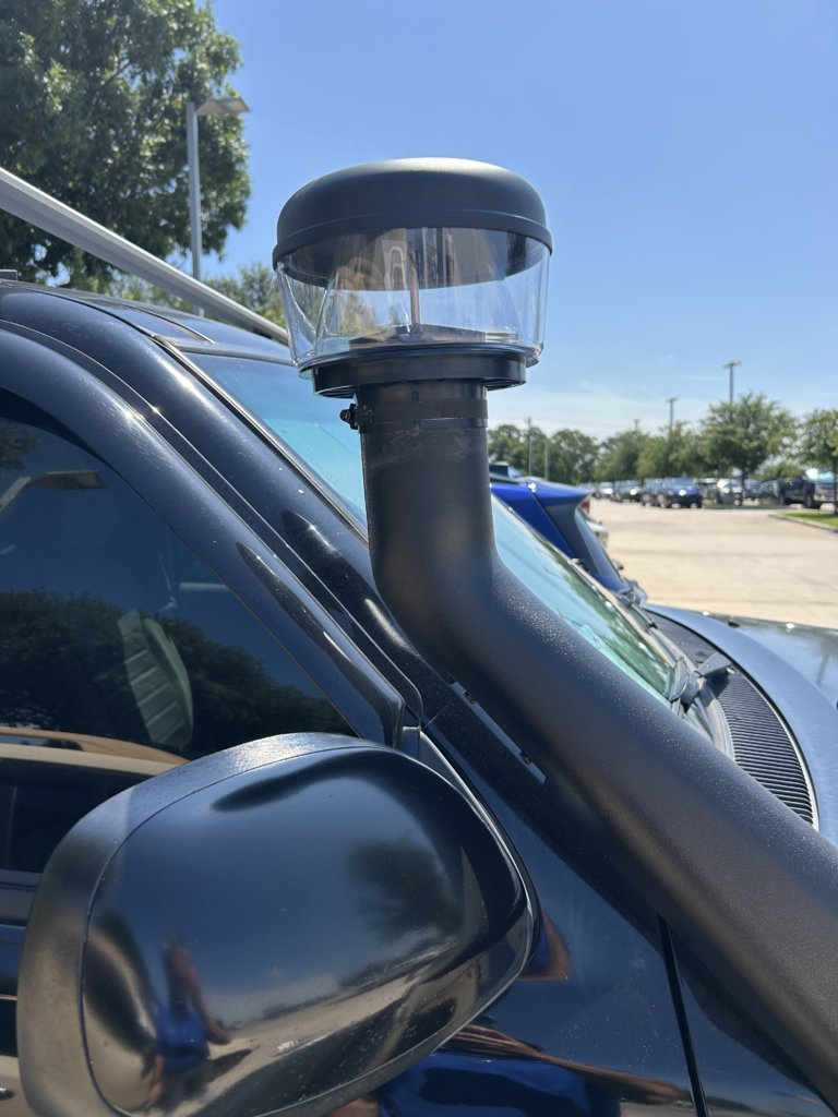

    I will be painting the catch can

    Put a Jackolantern over that come spooky season

    Jokes aside, what is the purpose of that?

    Prefilter

    Wanna see a one month supply of dirt particles report

    I can tell you that the ram head was dusty inside when I took it off. Air filter is still clean

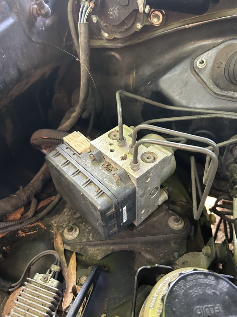

    Brake fluid flush is next on my list…I haven’t looked at fsm yet to see if this the LSPV, but most pics show it under the truck, and there is no bleeder valve to be seen on it so what is this? Part of ABS?
    haven’t seen anything like it on the forerunner.

    That’s an ABS module. The LSPV is behind the gas tank on the drivers side above the rear axle. All of the brake lines in the back can be traced from the drums back to it. There’s a lever on the passenger side of the rear axle that actuates a rod that stretches back to the drivers side that also leads to the LSPV.
