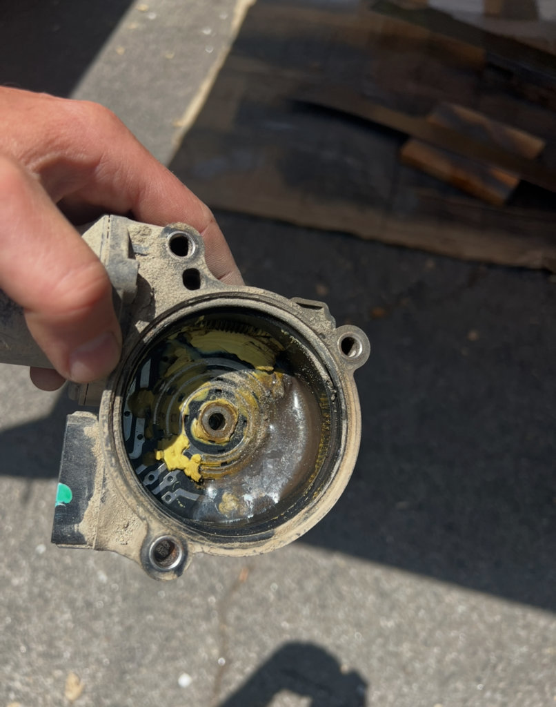

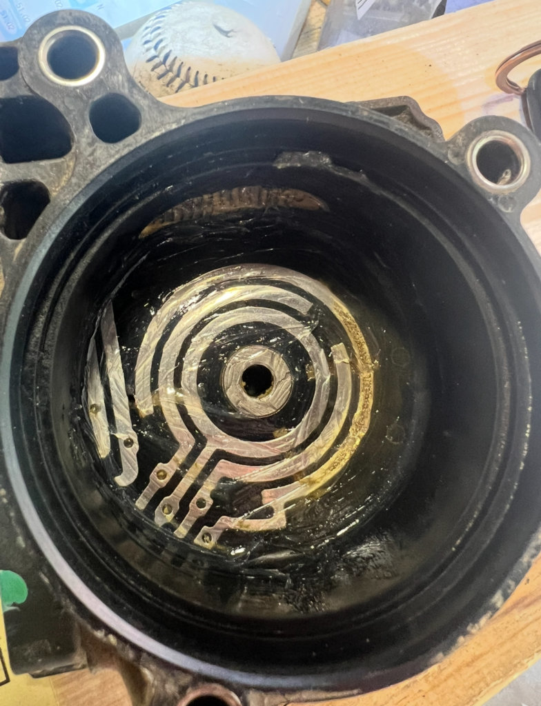

    IMG_1031.jpg And good as new. Shifts through low & hi and back to off as it should.
    Special thanks to @FiatRunner! Your 4WD thread is gold

    '06 AC Limited V8/4WD
    Mint! Definitly some pitting there. Is your rubber vent tube intact, and if not, what the hell was that jamming it up?

    2003 AC TRD 4x4
    It was old & beat up. Kept falling off which caused the dirt and water in there I guess. Cut the worn end off the vacuum line and now have a tight seal on there.

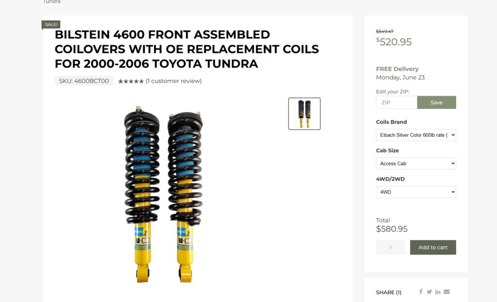

    2002 SR5 AC 4.7 V8 4WD
    Any significant difference from the "generic" coil vs the Eibach option when ordering this set of bilsteins?

    2002 AC TRD 4x4 V8
    What all did you do? Remove the actuator, clean it, and reinstall? Did you have to grease it?

    2003 AC TRD 4x4
    Took the cover off, cleaned it, sanded down erosion on the metal strips(outer one mainly) then applied dielectric grease before putting cover back on.

    TX...big surprise
    What's the spring rate of the "generic" springs?
    Is that Bilstein lifts dot com? If so, I agree.
  19. Jun 9, 2025 at 6:38 PM
    Daamn, I think I've seen in another post you saying something similar. Whats their deal?
    I dont believe I see the rating listed anywhere and yeah it is(suspension lifts.com)

    TX...big surprise
    In my experience, they don't know their ass from their elbow. I thought they were affiliated with Bilstein (before their name change), so I corresponded with some questions about Billy 6112's and they just gave me the most generic answers. Couldn't elaborate at all. Or flat out didn't know what to tell me. It's clear they were used to dealing with idiots with a credit card and a computer, not enthusiasts, who planned to do their own install.

    Yes, but their new name, SuspensionLifts.
    There’s a thread on here somewhere. If you order from them, hope you don’t have any problems. Their customer support is anonymous person behind a keyboard that will only email. And will do everything possible to NOT give you anything, including service or help.

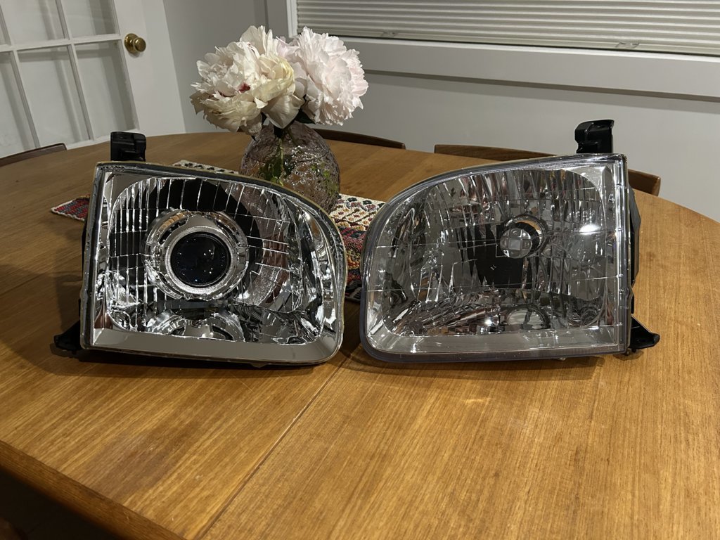

    2004 DC Limited
    Started my retrofit install late tonight, didn’t get as much done as I was hoping for. Tried a heat gun approach in the supplied RA box but it took ages and I ended up just applying direct heat working my way around the housing; I’ll throw them in the gas oven tomorrow after work and see if it works better. Dig the way it’s looking so far, excited to see them on the truck.
