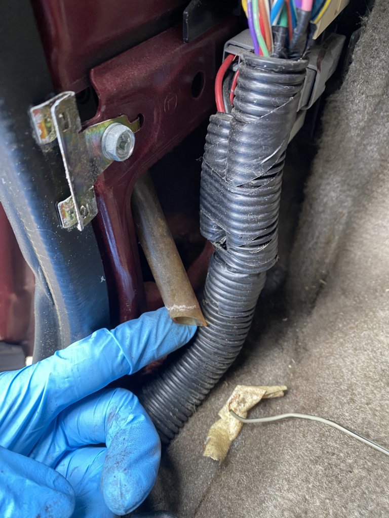

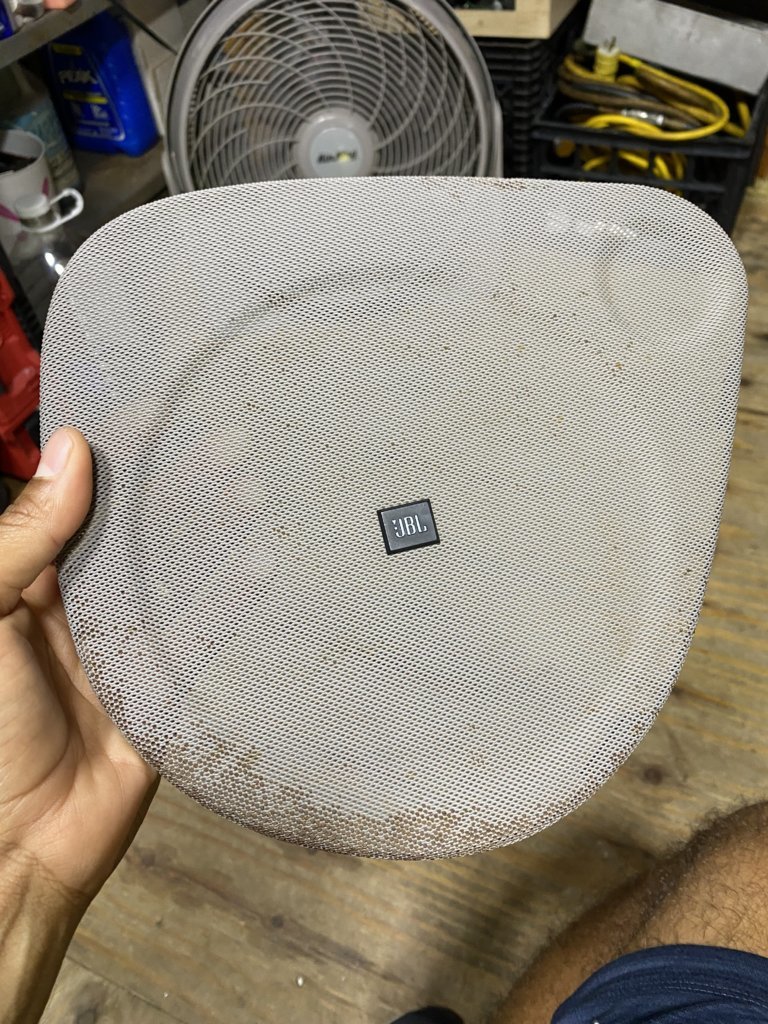

    Picked up a 1st gen tundra recently to replace my 1st gen tacoma. The truck had a sound system some decent parts but whoever did the installation definitely did a hack job. We decided to spruce up the door panels while they were off since the vinyl was worn out and the speaker grills rusty. Rusty speaker grills anyone seen that? I have a few theories mostly water leaks in the cab I found two the drain hoses for the sunroof are not going through the floor and out the truck they seem to be short or a piece missing anyone have any idea? I fixed the wiring and routed it through the wiring harness rubber so that should stop any water leaks from the doors and the shorted amp wires. They actually lost the screws for two of the woofer terminals snd stuff some bigger pointy wood type screws in there… unfortunately it damaged the pcb board beyond repair and I had to switch the wiring for the woofer up a bit. Yes that’s right the glued the speakers into place! We will be making custom brackets for the speakers to be secured properly. Does anyone have any idea how the drain lines for the sunroof go out of the truck? I was thinking of just extending them.

    Nice work in the door card rehab. That wiring job, yeesh. They couldn’t go through the boot?

    That tube at your finger is the drain hose that should go even further downward so it exits at bottom of truck. The Moonroof has 2 in each corner of the front and they exit down the A pillar. There are 2 in back that head to C pillar and head downwards. At least that is how my 04 DC LTD is.

    I figured that's what they are, however it has no slack to be pulled down any further. im not sure if someone previously cut it or not or if they removed some sort of fitting that extended it to be able to pass through the chassis. on some other vehicles they have a fitting.

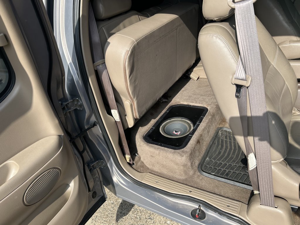

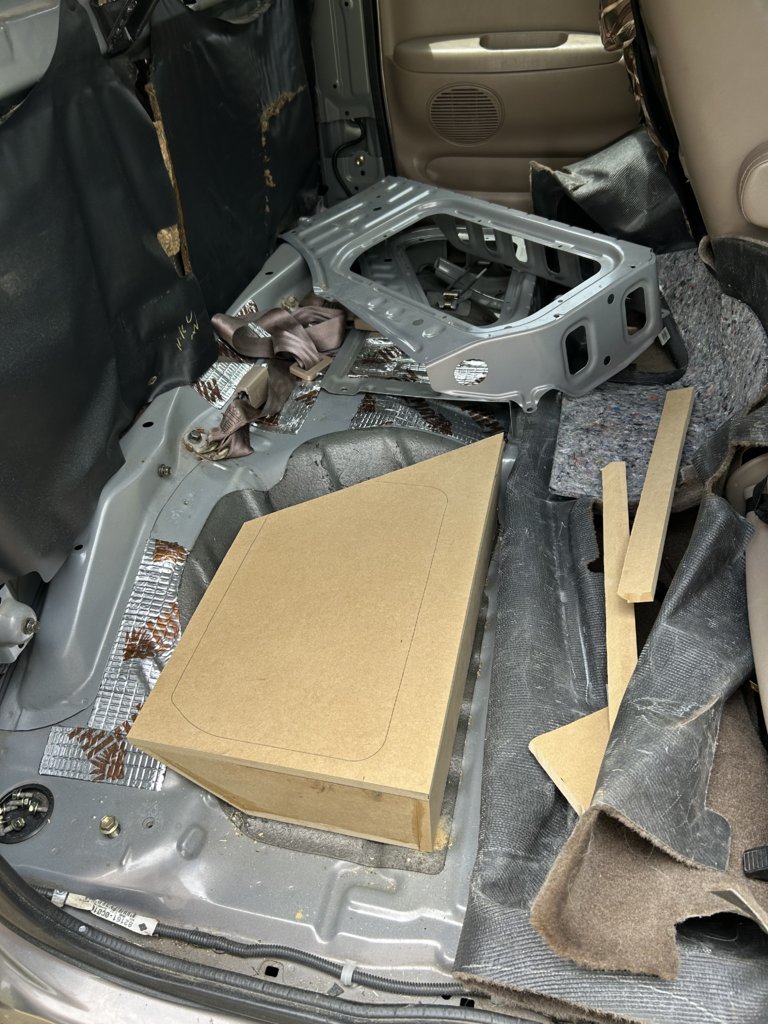

    That's really nice work KNABORES :thumbsup: (The mustang too)
    Maybe I just don't have a great spatial grasp on that storage area.... but how are you getting that in and out?
    I've, in my head tried to picture it and I'm coming up blank.

    Lift the carpet, remove the storage cubby frame. The frame is just bolted in.

    Meanwhile, those OEM grilles. Smearing naval jelly on both sides for 10-15 mins then spraying off with water will clear that up and have them looking new, keeping the paint intact usually. Or give them a premium look by applying speaker fabric over them (good hosier works in a pinch). But what you did looks good too.

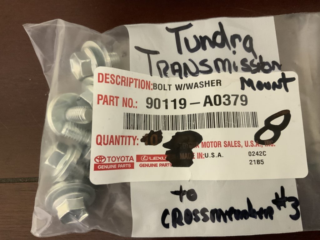

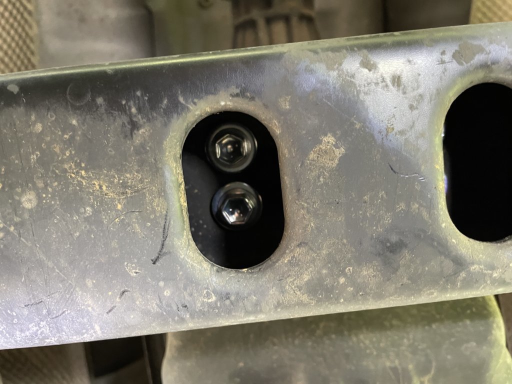

    Transmission Mount Bolts replaced. Couldn’t see any cracks in the crossmember and decided to replace the remaining 3 bolts while replacing the one that was missing. I didn’t have access to a torque wrench but lets just say since the TSB said to increase torque- I went with very, very snug….lol. These bolts were an exact match BTW.IMG_0851.jpg IMG_2197.jpg

    Dunzo, sounds great. And no box on the floor anymore!!
