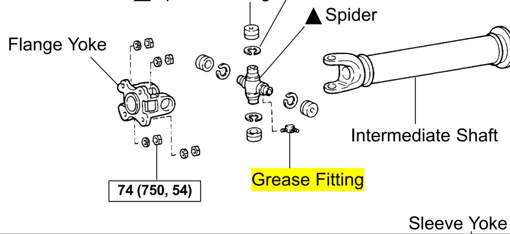

    The part he has looks very similar to this part here
    The only other fitting he could have needed is the fitting for the sleeve yoke. Notice how in the pic that fitting (red) almost looks as if it has threads vs the one he has (blue)

    Thanks fellas. Poked around in the hole with a small Allen wrench and can’t feel any threads.
    2nd one we ordered at dealer cause parts guy also thought it was the wrong part at 1st given no threads. Ima try pushing this in and see what happens.

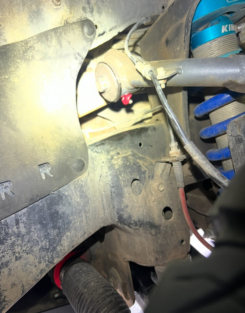

    Question, greasing UCAs and didn’t see grease come out along the washer edges like I usually do but did get it coming back out from around the zerk once i tightened the UCA bolt. IMG_1004.jpg
    Curious if this has happened to others and it’s normal or maybe sign its time to change out the rubber washers in the UCA?…

    Is it coming out of the zerk or the threads? Your potato pic looks like it’s coming from the threads….. tighten up the zerk or throw some tape on it

    Did both actually. Another one came out of the zerk, this one the threads.

    Pump it some more?

    Some of the more stubborn zerks are either dirty and plugged, or need to be threaded out slightly to allow grease to get pumped into them.

    Should I be seeing the grease come out around the rubber washers?

    I’ve definitely had to take a pick tool and poke some of my zerks that wouldn’t take grease

    It’s gotta go somewhere…… so yes

    Going but returning. Something seems jammed up in there
