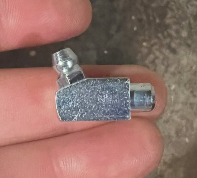

    15,243

  3. Jun 3, 2025 at 6:28 PM

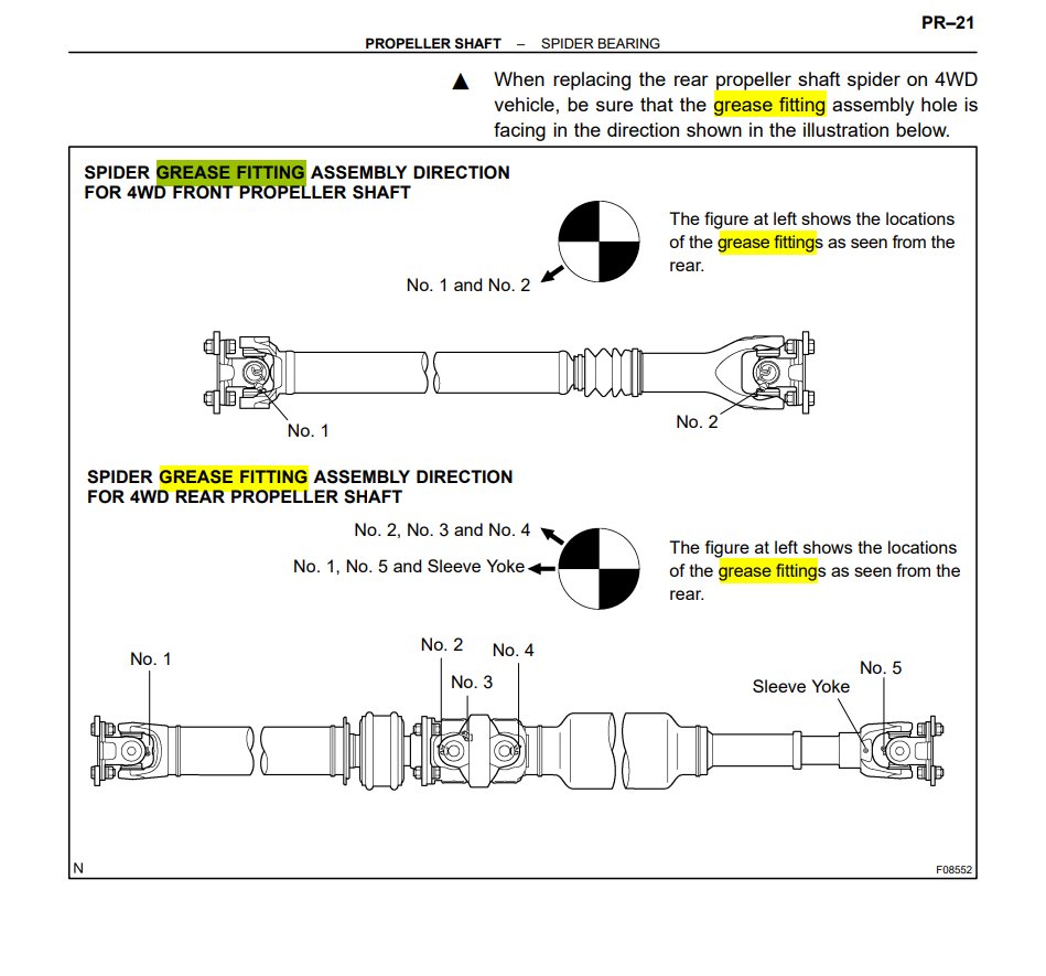

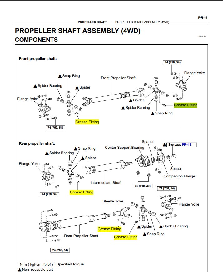

    Dblock500
