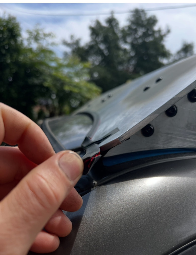

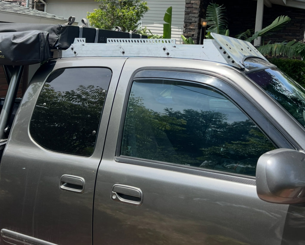

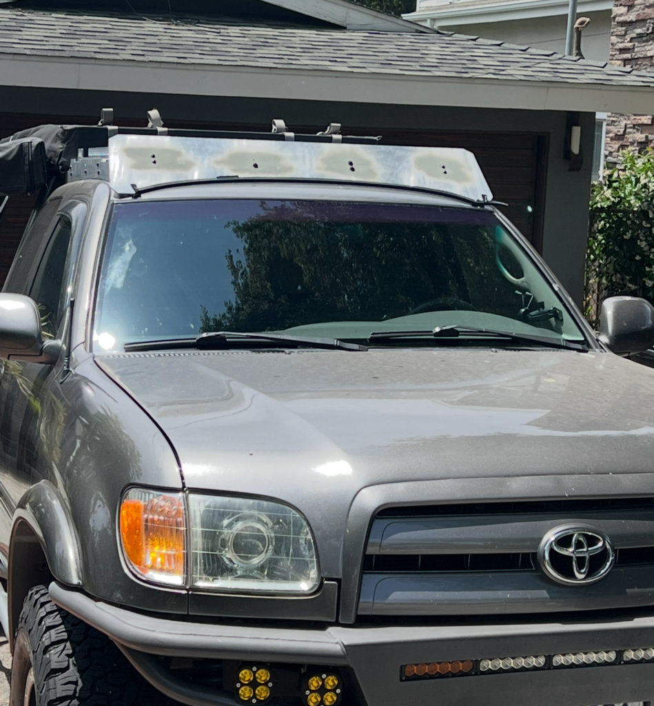

    So today I test ran the roof rack I’ve been working on(man did I underestimate the difficulty of this project!). IMG_0949.jpg
    IMG_0950.jpg It whistled like a pig, huge bummer. Had left only about a 1/4” space if not less. Had, not sure what it’s called but this stuff…IMG_0954.jpg
    And now it’s as quiet as before. What a relief!

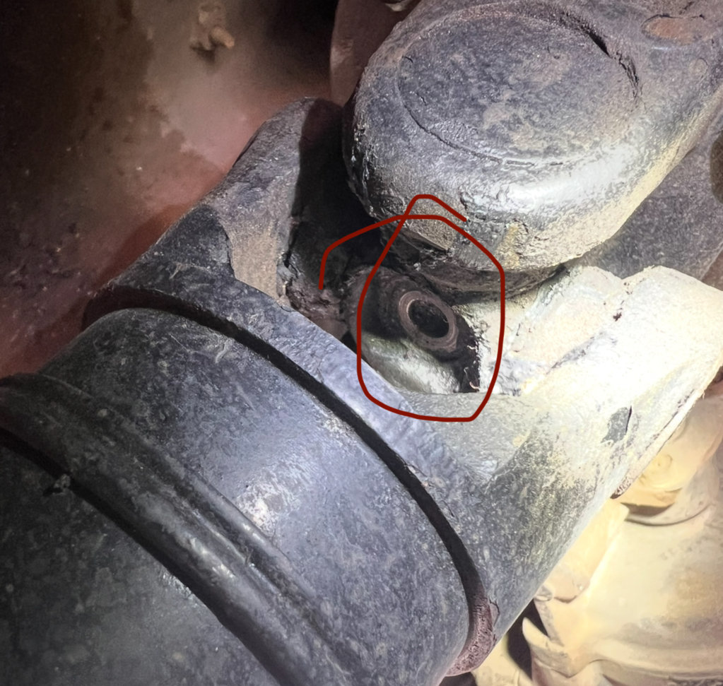

    Oh and a new issue today, greasing things underneath the truck and noticed a zerk fitting missing on the driveshaft. I was so confused at 1st lol. Easy enough fix IMG_0951.jpg

    @Voss Wow dude that roof rack looks incredible! Mustve been annoying and tedious to fit the contour of the roof! Glad you got it nice and quiet too

    I can mail you a zerk if you need one. I have a pack in the center console leftover from my UCAs that I never took out.

    Thanks bud. Yeah each section, down to its attachment points were a pain. Mostly eyeballed the entire thing by slowly grinding down to fit.
    Still have a little work to do but hard part over.

    Thanks but ordered one from stealer. Even the guy thought it was too expensive, $13 but it’s close and convenient. Appreciate it bud!

    You should trace the countour on some cardboard and keep at template around! Maybe useful if you wanna make another one or to give to someone else. Just seeing yours makes me want to build one but I dont know what id put up there, haha

    Good idea. I have lights, a solar panel & one day a sun based water heater going up there. Also hoping it helps with MPG as a windbreaker for my tent.

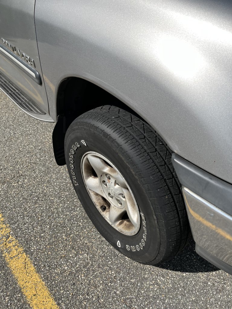

    WTF?!? How does only one tire wear like that and at such an angle?
    Edit: Just my imagination. The other one is similar, it just hasn’t worn off the tread just yet.

    are your lca’s adjusted all the way in?

    Toe out of adjustment

    I think the camber was a little positive from the last alignment. But they can go in more if needed.
    Definitely a possibility, but the camber is a little positive on both sides but within spec.

    Feathering is usually a toe thing, IIRC. You'd think it'd be a positive camber issue, but usually toe wear is edge wear. If it's equally like that on both sides, it's more likely overinflation.
    Our '20 Highlander was showing identical feathering on both front tires, but only 1/4 of the wear you're showing on front-passenger. I rotated front to rear recently. I was told "latest gen of Highlanders naturally tend to have edge wear up front", not sure if I believe it. Really need to take it in to be aligned. I was just shocked it was necessary after so few years.

    Toe & positive camber with more left hand sweeping turns than right.
    I've seen multiple brand new vehicles that needed alignments. Factory is close enough, until the suspension settles after 500-1k mi.

    It’s not really feathering. You can feel the tread getting lower going across the tire and it’s relatively a smooth transition, not choppy.
    I never have much luck with t*ts or tires anyway.
    Trying to get a good alignment vs good “enough” is like pulling teeth and I’ve had LCA bushing issues that led to premature wear in the past.

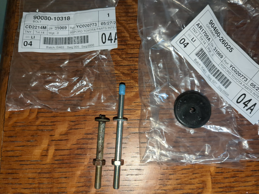

    Finally got the replacement bolt. Surprised to see it has what looks like blue locktite. Based on previous experience I think I'll be removing it. Also bought a grommet for the cam position sensor since mine has been missing.
