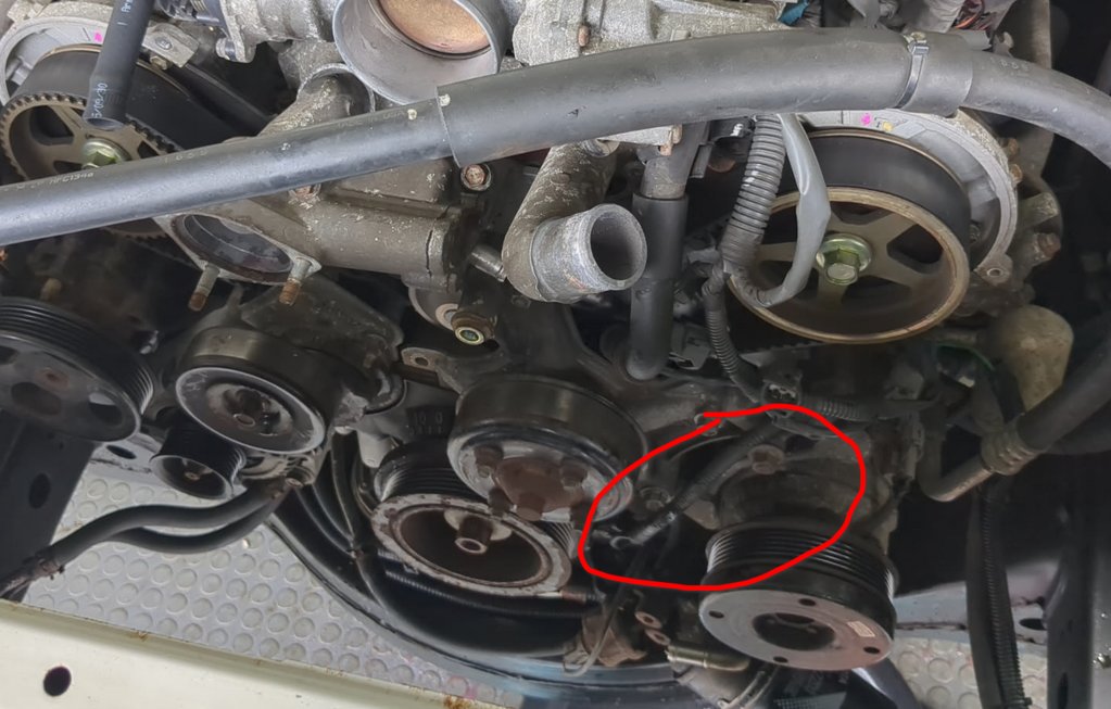

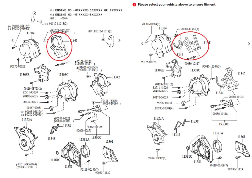

    Looking at a 2000 V8 4WD (random) VIN, here's the timing cover area to get the standoff fastener: https://toyota-usa.epc-data.com/tundra/uck40/3802/engine/1106/
    Weirdly, there's two part numbers, this is one 90109-06320, this is the other 90080-10317.
    Apparently you know which is correct - deductive logic, I think? - based on Toyota's direct exploded in the Parts System, looks like the shape of the timing plate (11341 in the pic) dictates which to use. That's the best I can tell at least. It also shows a different part number passenger to driver, where bank 1/driver ends in 8 and bank 2/passenger ends in 7.

    I ordered 90080-10318
    If you look up the other number on parts .Toyota.com it says its superceeded. Maybe because the old part number has the strength of room temperature cheese?
    New seal in! Hopefully seated all the way

    Driver and pass are totally different lengths

    Ah, I thought you were holding the one up in front of bank 2. My comments refer to that fastener. Part ending -10318 is driver's side, and spikes thru one of the ears of the cam position sensor.

    Ps - I dunno if the non-VVTi timing covers are like the VVTi timing covers on the '05+ but beware, there are (or may be) metal bushing-like metal inserts in the timing cover that can fall out, get lost, or if you're like @Weagle they can get launched into the inside of your hood with a BANG! by the belt.

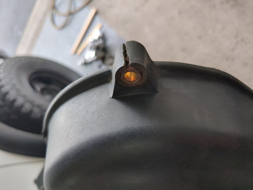

    Yup. Wish new covers weren't so expensive

    Popping it out, slathering some grease on it or in the hole, and reinstalling will ensure they don't fall out (you may already know this trick, using grease to hold stuff in - clearly you're mechanically inclined feel free to tell me to shutup whenever :rofl: ).

    Helicoil?

    Cheaper and easier to paint it?

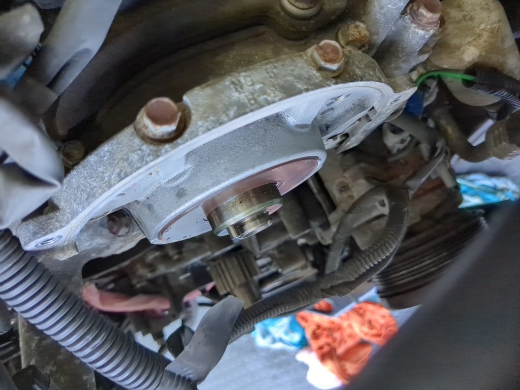

    Anyone know if it's safe to use the screw trick to remove the crank seal? The seal puller I bought for the job broke when doing the second cam seal (perhaps user error?)
    I also have one of these, but it seems a bit unwieldy
    It seems like the crank seal is shallower than the cam seals and I don't want to damage anything that might be behind it.

    My seal puller looks like the bottom one. Havent used it on the 2uz yet.

    As it turns out that other seal puller didn't work very well for me. Like the cam seals the crank seal has a metal core, and I was just denting it. Ended up drilling a tiny hole and threading in a screw to pull it. Cleaned very carefully afterwards.

    @RUSTYNUTS showed us a pretty effective way to remove the pre-2005 sales at one point, but hell if I can find the reply.
    If I had a reasonable place to paint something that large that was convenient, I'd consider it. But wrapping is so much easier, and a no-brainer, that I dunno if I ever really want to paint anything again.

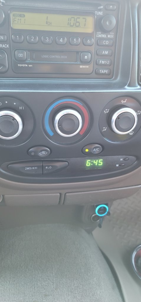

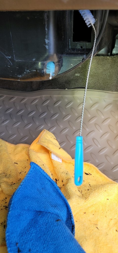

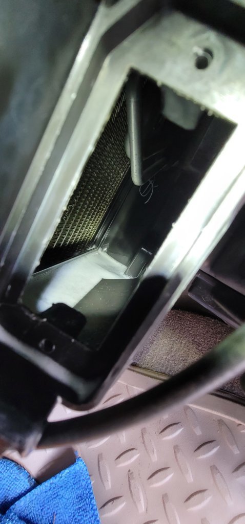

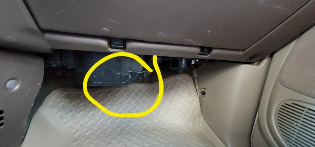

    Did a second pass from last week's cleaning on my evap coil and got it as clean as I could. Highly recommend using bottle brushes to really get in there if you cant find those small nozzle shop vac attachments that'll fit inside that tiny space. You can manipulate them to whatever shape you need to reach in. These are what I used Holikme Bottle Brush Tube... https://www.amazon.com/dp/B086D7SX8K?ref=ppx_pop_mob_ap_share
    Before I patched the hole I had on the housing, I used one of the narrow brushs to snake it around to get stuff stuck in the corner by the hole. I was able to literally shovel stuff out of the hole and it worked to get damn near all debris out of there. Then did another spray with foaming coil cleaner. That hole in the housing almost acting as its own vent and could feel air escaping/blowing out into the passenger footwell when the ac was blowing. Taped it up with ultimate gorilla tape when I finished.

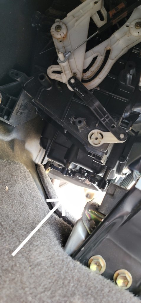

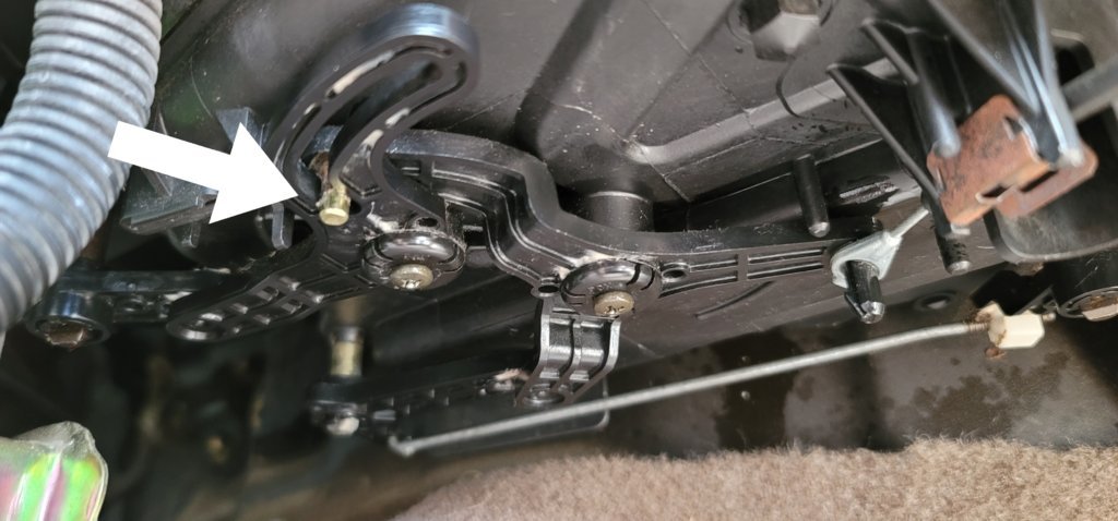

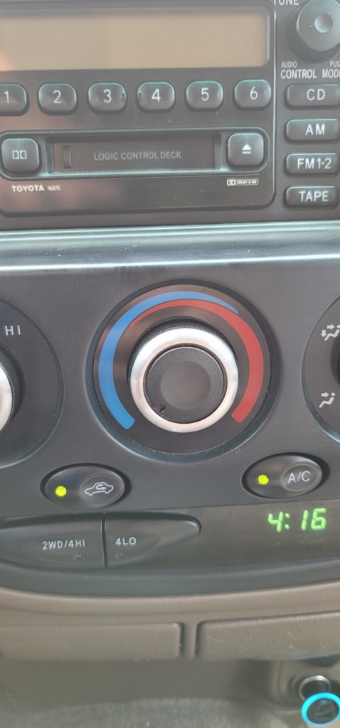

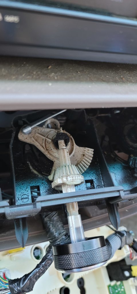

    I also finally fixed my damn AC/climate control knob that would only turn 3/4 on the cool side. Second picture show where the vents that run behind the center console from driver side footwell to passenger side have been removed. I had to take these out to get enough access to the actuators on the passenger side (pic taken from driver side). Took the lowest panel off first (the one with the cigarette light and 12v plugs). Then cleaned out all the dirt, dust and tested the knob while observing whats going on with the levers and cables. In my case, it was one particular pin and corner of an actuator that was dirty and blocked full motion. Lubed up all the wires/cables I could and finally got it working. Satisfying as hell to get it working properly.

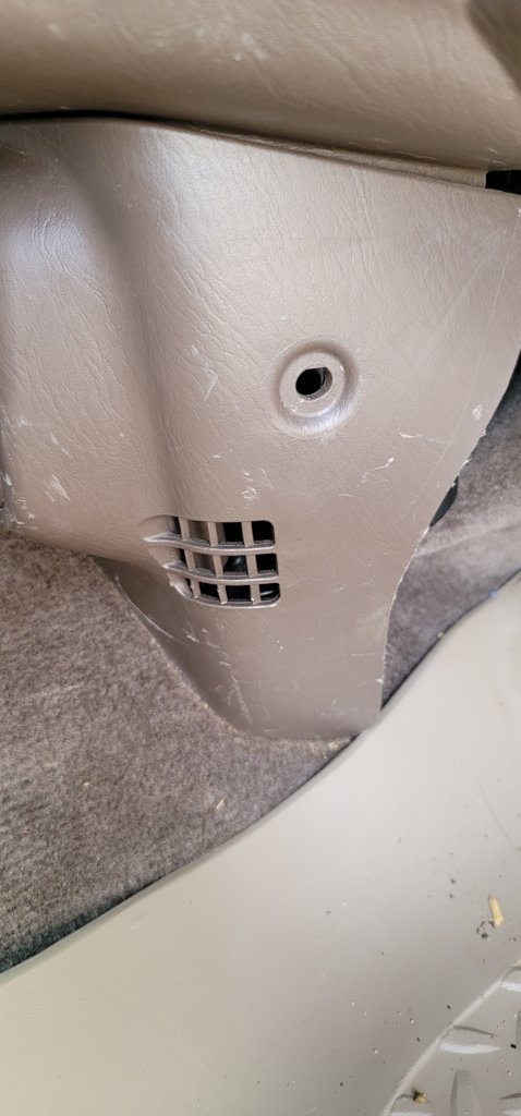

    Also, I broke the stupid push pins on the console panel (because of course I did :mad:) anyone know if theres a part number to be found to color match? Or not, I dont even care if matches at this point as long as its the right size

    Thanks for posting this. I know there's been write ups on this before, but this is the exact problem I've been having. I cleaned what I could from the driver side without removing any plastic (because yeah, you're sure to break something), pulled the bezel and control knobs and lubed everything, and kept lubing the heater control valve cable in the engine compartment, which I've been thinking was my limiting factor. But still can't turn the knob all the way to cold. Maybe it's that same pin you cleaned...I'll try it today.

    Yessir, the pins and actuators on the passenger side controls the AC part. You may be able to reach most of them without removing the vents, I'd try looking first to see what you can do. But if you pull the vents, they are held by a 10mm bolt and philips screw that youll be able to see after you pull the console panel off.
    Yeah I cleaned these too. And lubed the cable there. But i figured out that when I forced the teeth from turning the knob all the way to cool, it would bounce back to the previous tooth/notch and i could kind of hear where it was sticking/ holding up at. Tracked it down to that area for mine. But if you clean everything down there, all the tracks that the pins travel in, etc, you'll find it

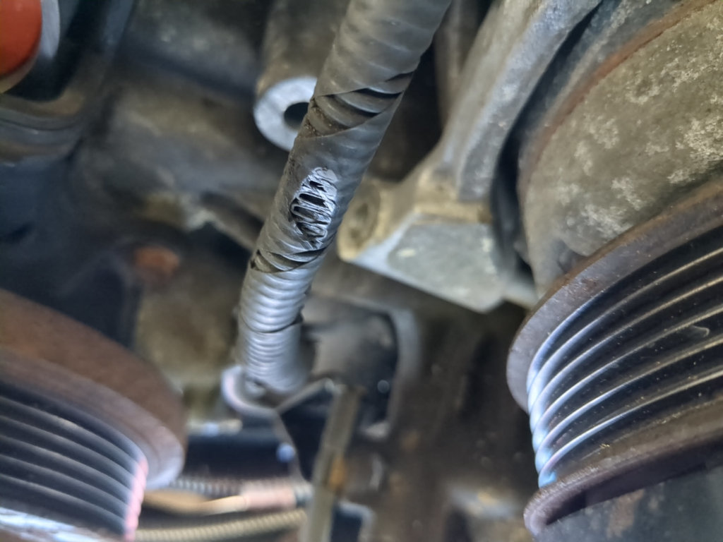

    Good thing I only did 12k miles between timing belts. No wires damaged. I have some extra loom I'll throw over it.
