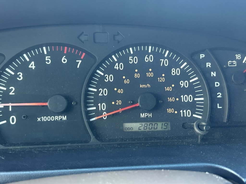

    Dang it! Missed the roll over. 280k and going strong!

    Likewise just missed mine. Was at 82024 a few miles ago. Figured I'd catch it at 82028. May get it when I go donate platelets at lunchtime.

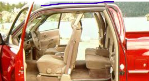

    Put two inch thick electrical tape over the top edge of my windahield and the water is still getting in the cab from the rain. I seriously don’t think it’s coming from the windshield now. Decided to put some over the third brake light. We’ll see if that solves the issue, otherwise I’m stumped.

    It’s coming in through the overhead console sunglass storage & map lights. Last time I looked at that thread it mentioned the third brake light, so that’s where I’m focusing my attention. Has it been updated with alternate sources?

    That makes sense. That's why I asked. Yes, 3rd brake light, unless you have rust build up under the roof trim

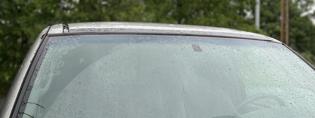

    This is an odd place for it to be coming in at. Your best bet is to grab someone and do a water test with a garden hose. Sit inside while they spray the water and you can tell when it starts to drip.
    You do have an AC, so the third brake light is a possibility....The water could be leaking from the third brake light and the water may be traveling down the headliner to the lowest exit point which happens to be your overhead console.
    But it could also be the top edge of the windshield.

    Mine did that too, but it was the windshield for me

    Pull the overhead console and do the hose test. I’m also betting windshield.
    And I’m sorry but according to my boy Murphy, the fact that you said “it shouldn’t be leaking there” almost assures it.
