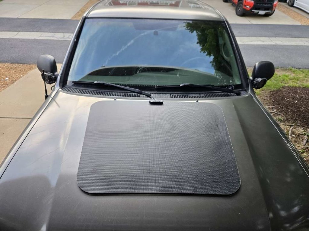

    Finally received the Cascadia 4x4 hood panel. 95w and a new design. I'll check charging amps and watts tomorrow during the day.

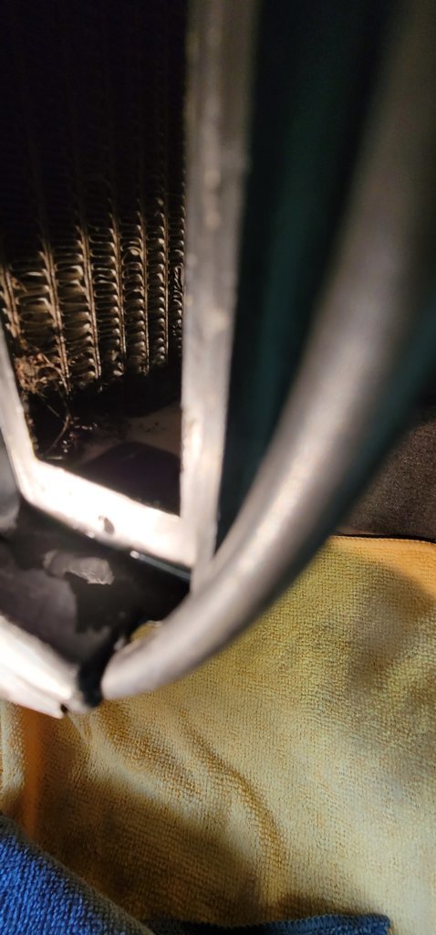

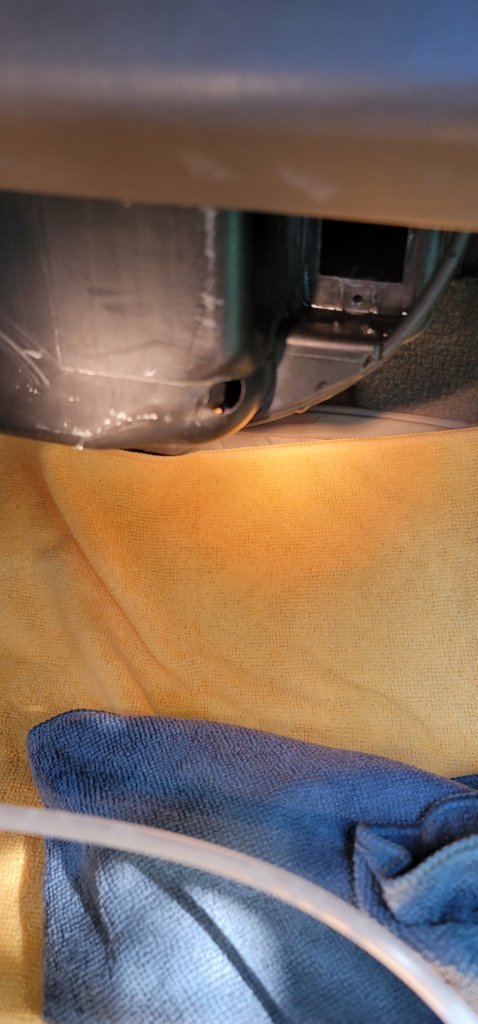

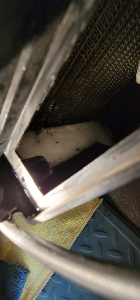

    Tried cleaning out the evaporator coils yesterday, had a bit of debris in it and some that my vac couldn't quite get to. Very hard to reach in and get everything in there. I bought some bottle brushes and another can of foam coil cleaner to do another pass at getting the rest out. Will use it on the condenser as well to hopefully get the AC a bit cooler. Surprisingly, the blower motor was clean as a whistle already.
    I have this hole on the bottom of the evaporator housing...will this effect cooling or the AC system as a whole in anyway?

    Any opening in the evap housing is going to impact performance, and while condensation should technically leak out the firewall hole (it's lower than that hole), if the firewall drain were to ever back up, guess where A/C condensate is going?
    I'd tape over the hole. Or, if you can reach it from the back side, score and clean the outside and inside of the evap box in that spot, throw a sponge wrapped in plastic wrap on the inside to act as a support, or maybe inflate a balloon, and essentially bondo the hole with epoxy. You'll need that added support on the inside to hold it in place, and scoring the plastic with 120grit paper will give tooth for the epoxy to grab.

    Good to know, thank you. Unfortunately the corner is basically impossible to reach from the inside, theres some debris in there that I couldn't reach. I'll just go ahead and tape it up

    Yeah, and I don't think you can replace the housing there without tearing down the dash.
    Any heavy-mil sticker will work fine as long as it'll flex around the corner.

    Little piece of black tape for now....

    Can't speak to the Tundra, don't have it that long, but I've had a 2001 4Runner for 13 years and yes, a bit of a thunk when shifting 4WD. Never worried me.
